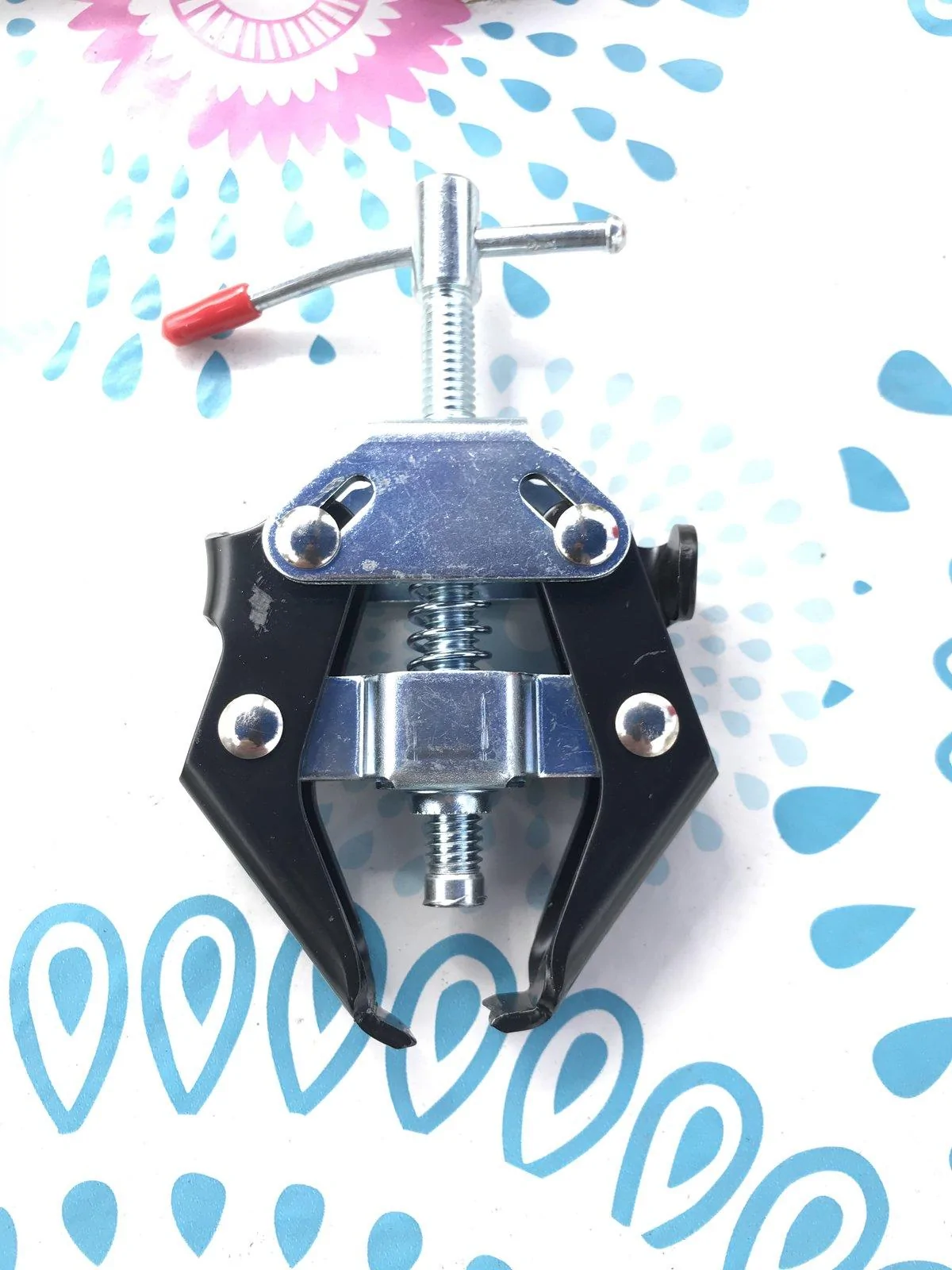

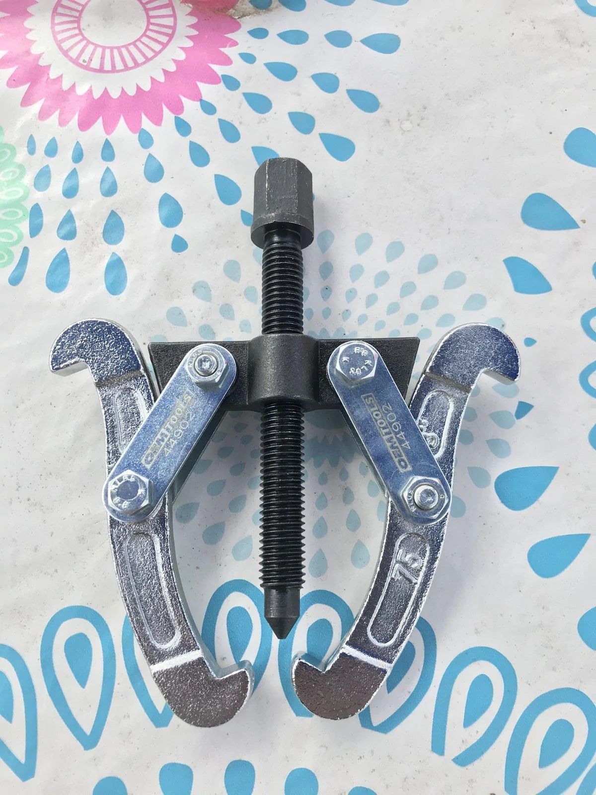

I purchased both a bearing and battery terminal puller. The bearing puller will not fit behind the arm so do not bother with it. The terminal puller fits but not strong enough to pull the arm off by itself, however if you use the battery terminal puller and crank it up as much as you can then take a hammer and with the claw end and a shop rag place the claw end behind the arm and give the hammer a good pull the arm will pop right off. If you line up the new arm properly it will easily go back on.

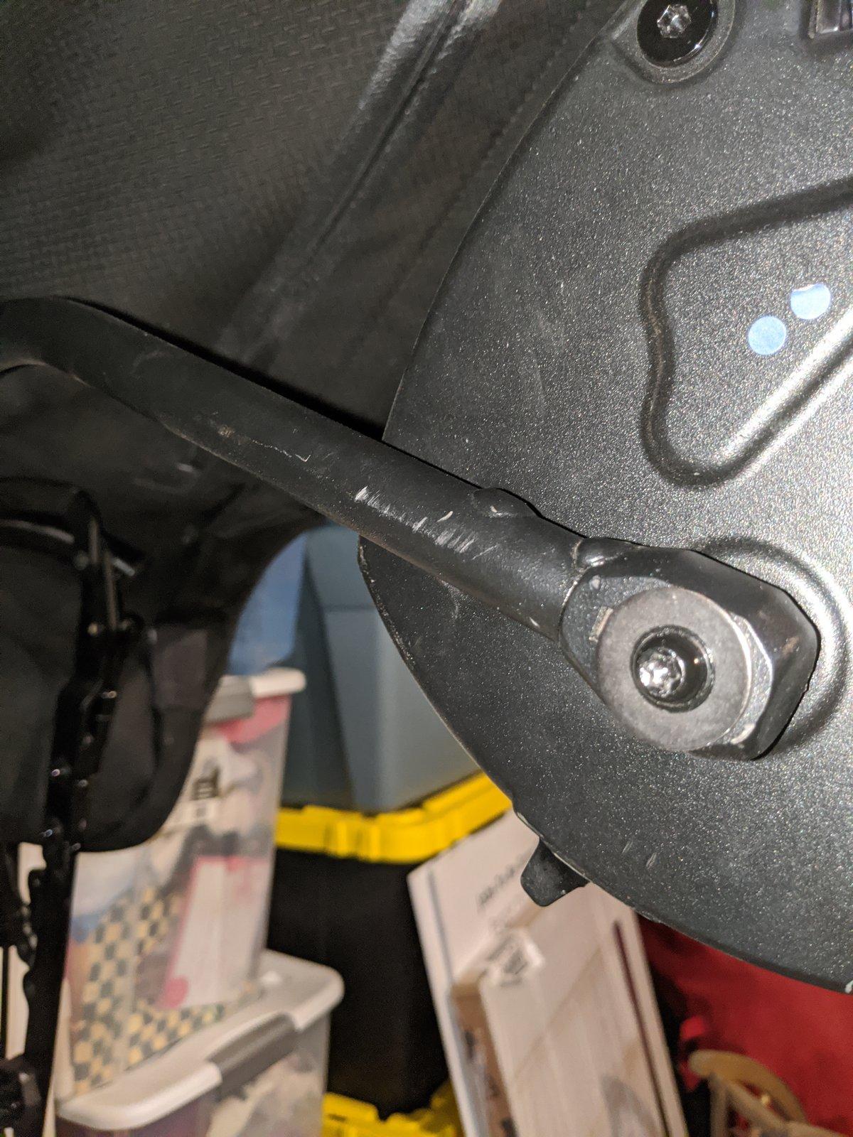

Jeep Wrangler JL Bent premium soft top rod IMG_2308
Jeep Wrangler JL Bent premium soft top rod IMG_2311
