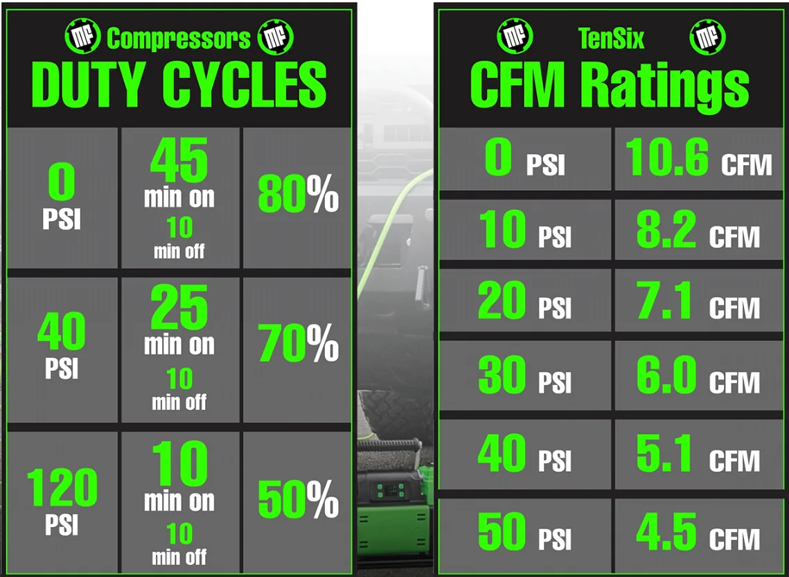

Looks like a Moorflate TenSix clone, assuming similar internals it should work pretty well. The TenSix rates 10.6CFM @ 0PSI. They do say it's only meant to inflate multiple tires at once, not sure if this one would be any different.
I have aired up my 37s many times, and am usually packed up and ready to go long before the ARB twins have finished.
