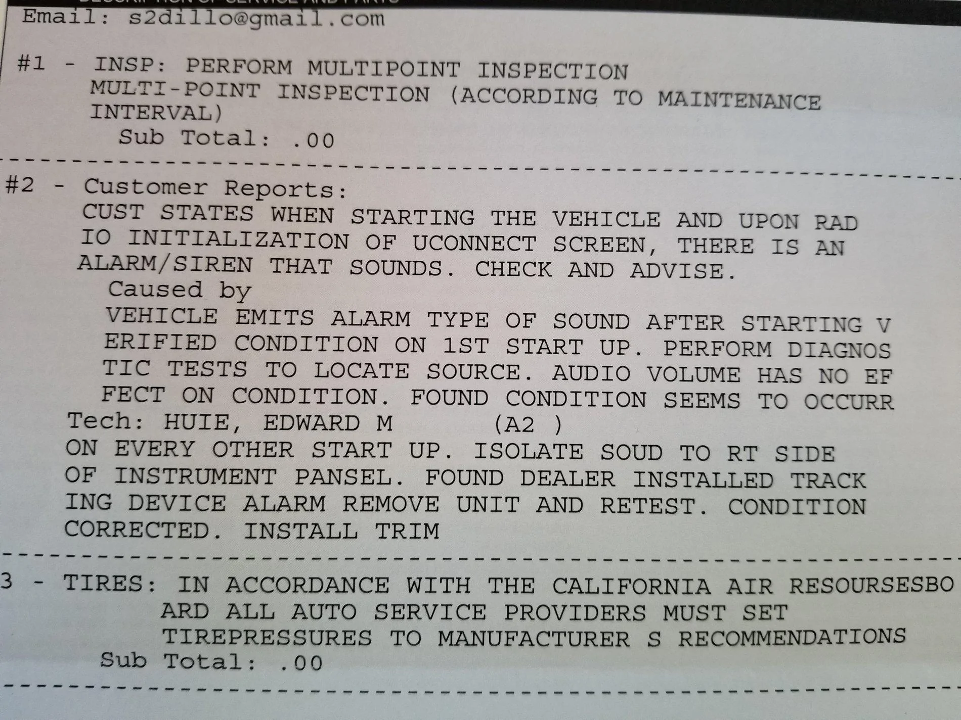

Latest update (6 hours later, only one technician trying to use his ear to locate it): Dealer found the issue of the "Pew Pew Pew" sound...it was a dealer installed (from another dealership) tracking device alarm...problem solved...yeah.

Over the years, there have been a few instances when I needed a dealer to diagnose and sort out a mechanical issue that I couldn't precisely identify. I always felt reassured when the Service Advisor told me that the technician successfully "verified [the] condition" on his first attempt. Success! I wasn't imagining things.
I felt less than reassured when presented with the bill, though.
