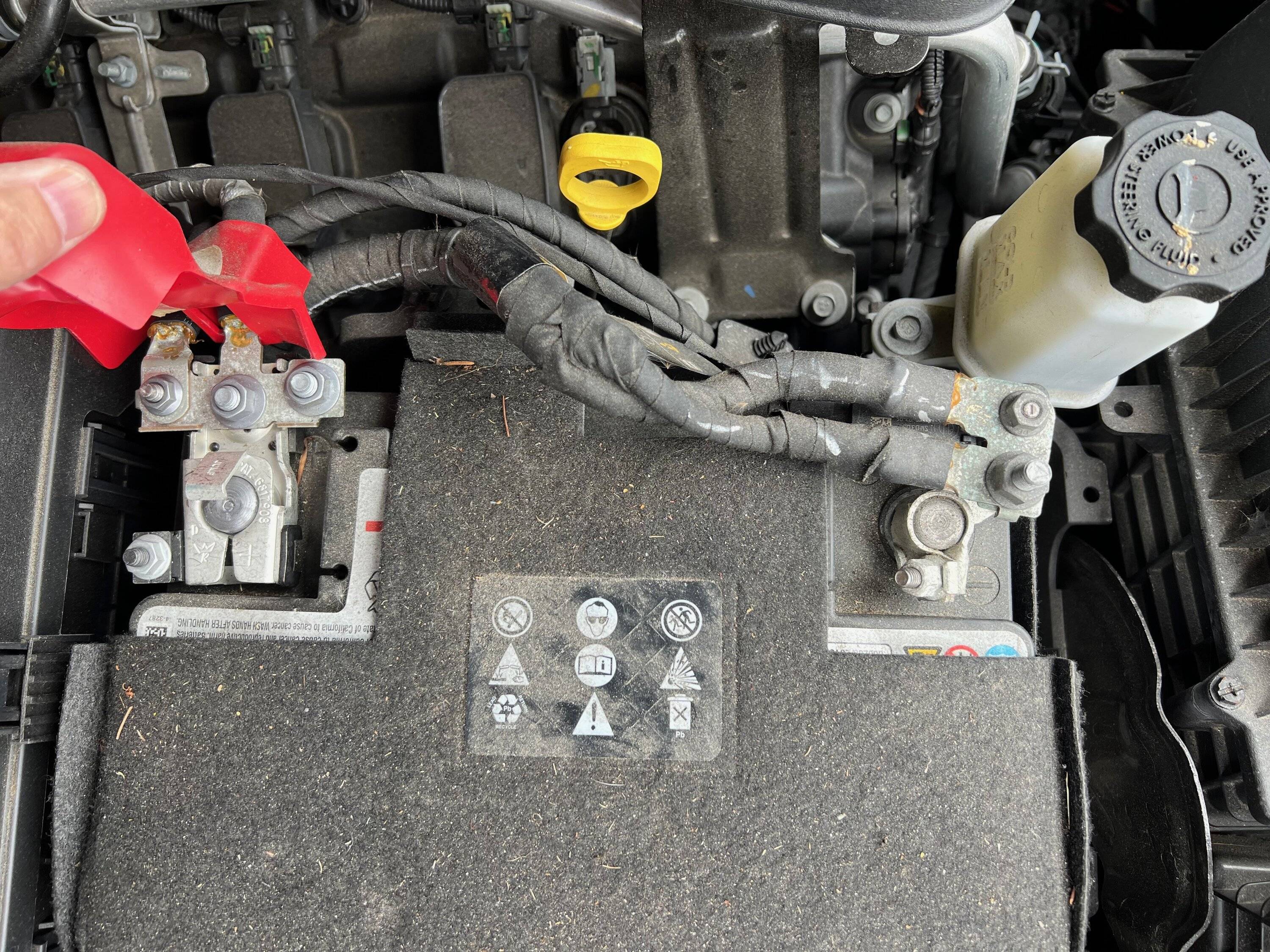

Couldn't you just look at the main battery and check for double battery cables ? One that connects to the main/ground and the other that connects to the aux(if its there).
Jeep Wrangler JL Aux. Battery - How do I know 20220801_170423

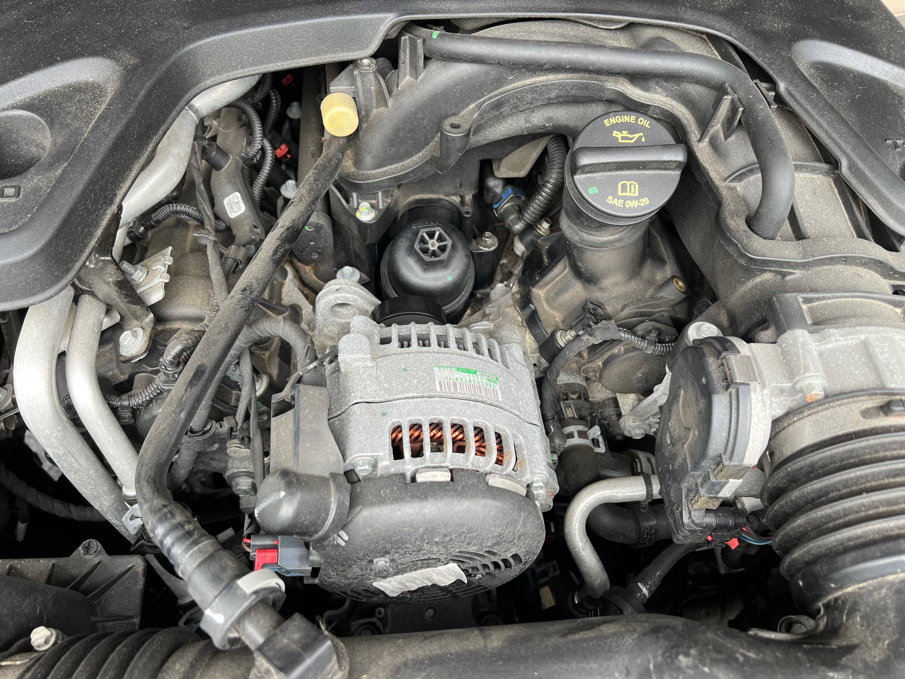

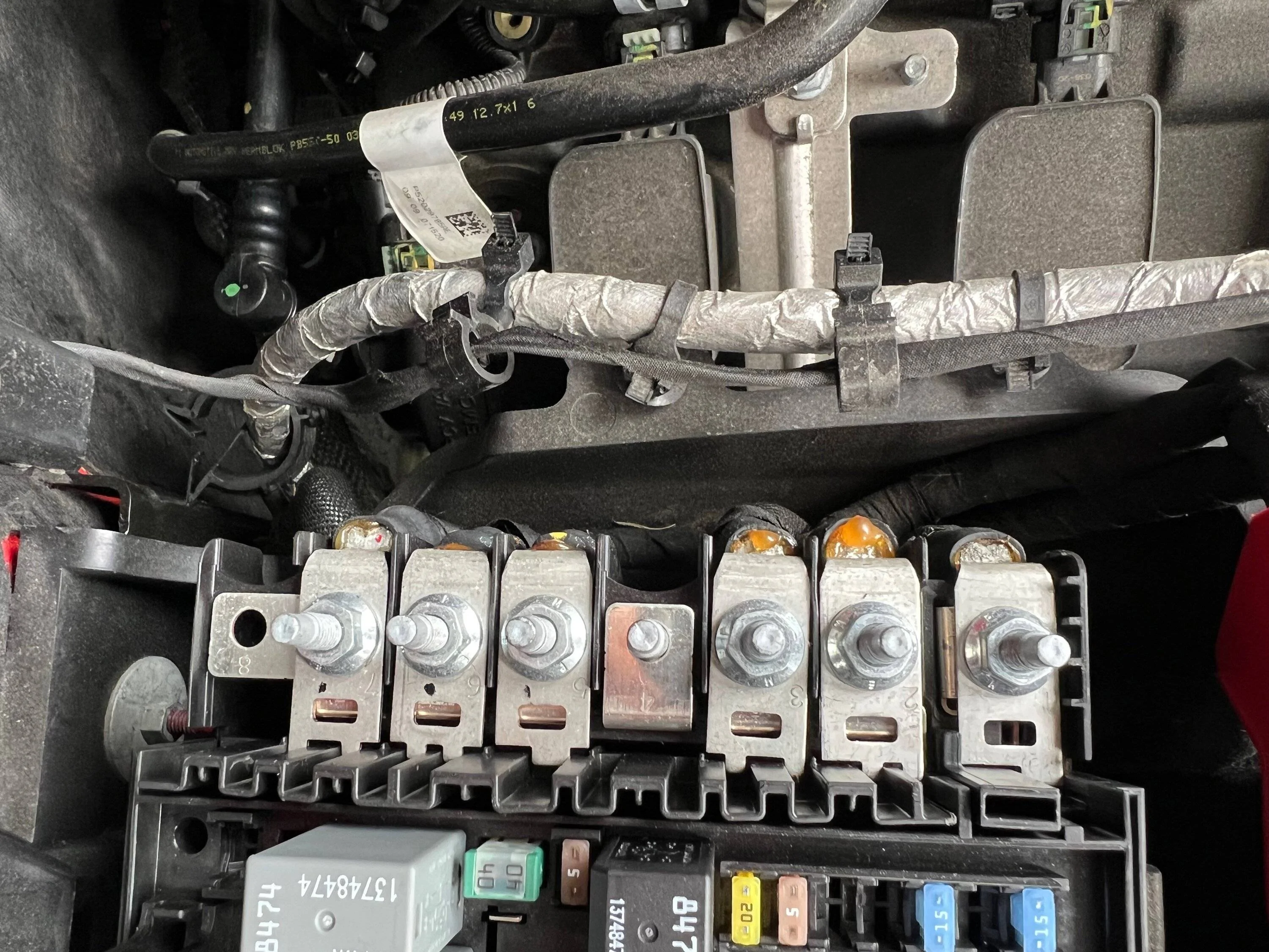

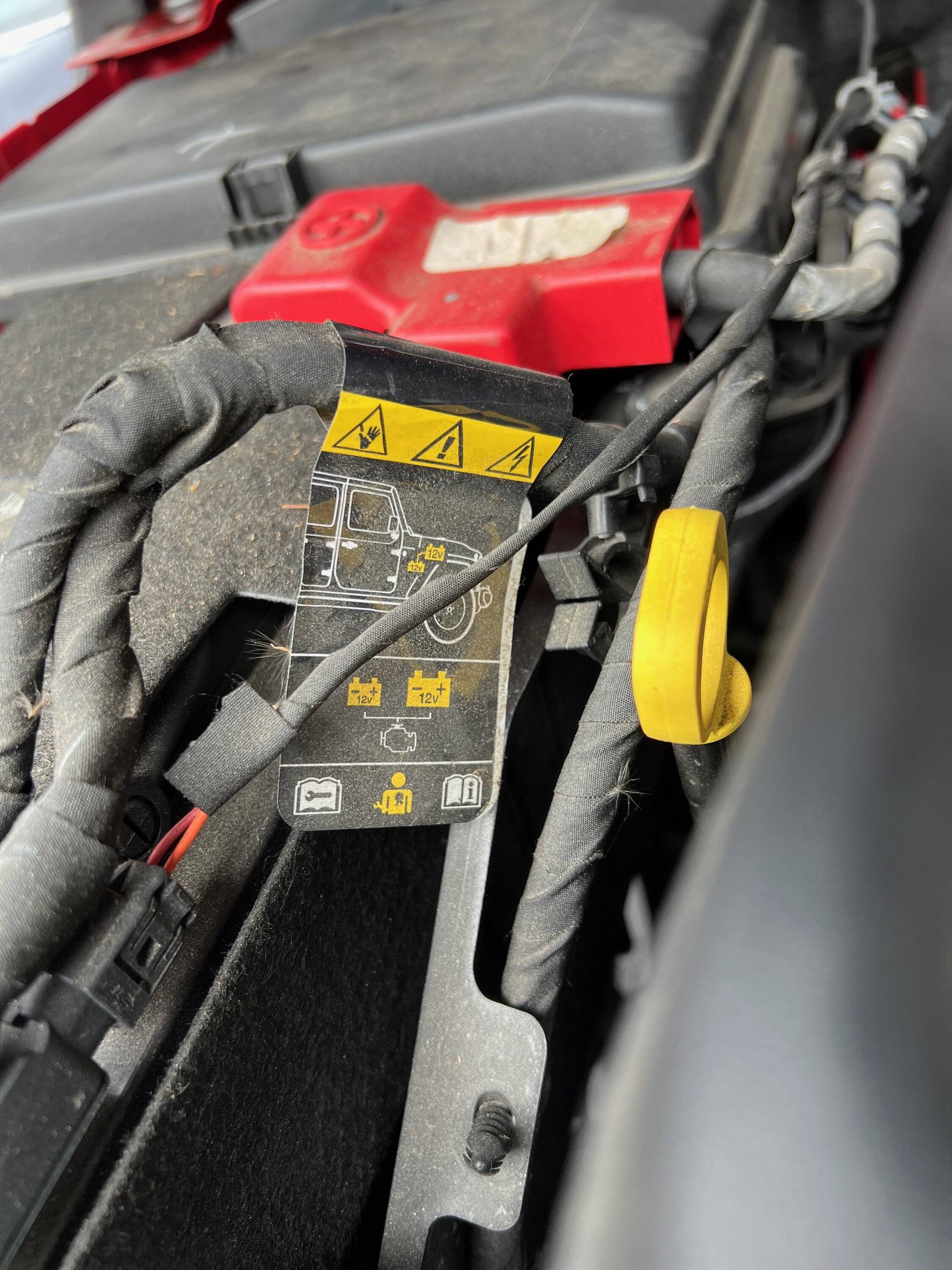

Mine is definitely not an eTorque. And, it would appear that I do indeed have an Aux. Battery by these pics
Jeep Wrangler JL Aux. Battery - How do I know Neg. Terminal - Main Battery
Jeep Wrangler JL Aux. Battery - How do I know PDC N1-N2 no jumper
Jeep Wrangler JL Aux. Battery - How do I know Alternator
Jeep Wrangler JL Aux. Battery - How do I know Two 12V Batteries
