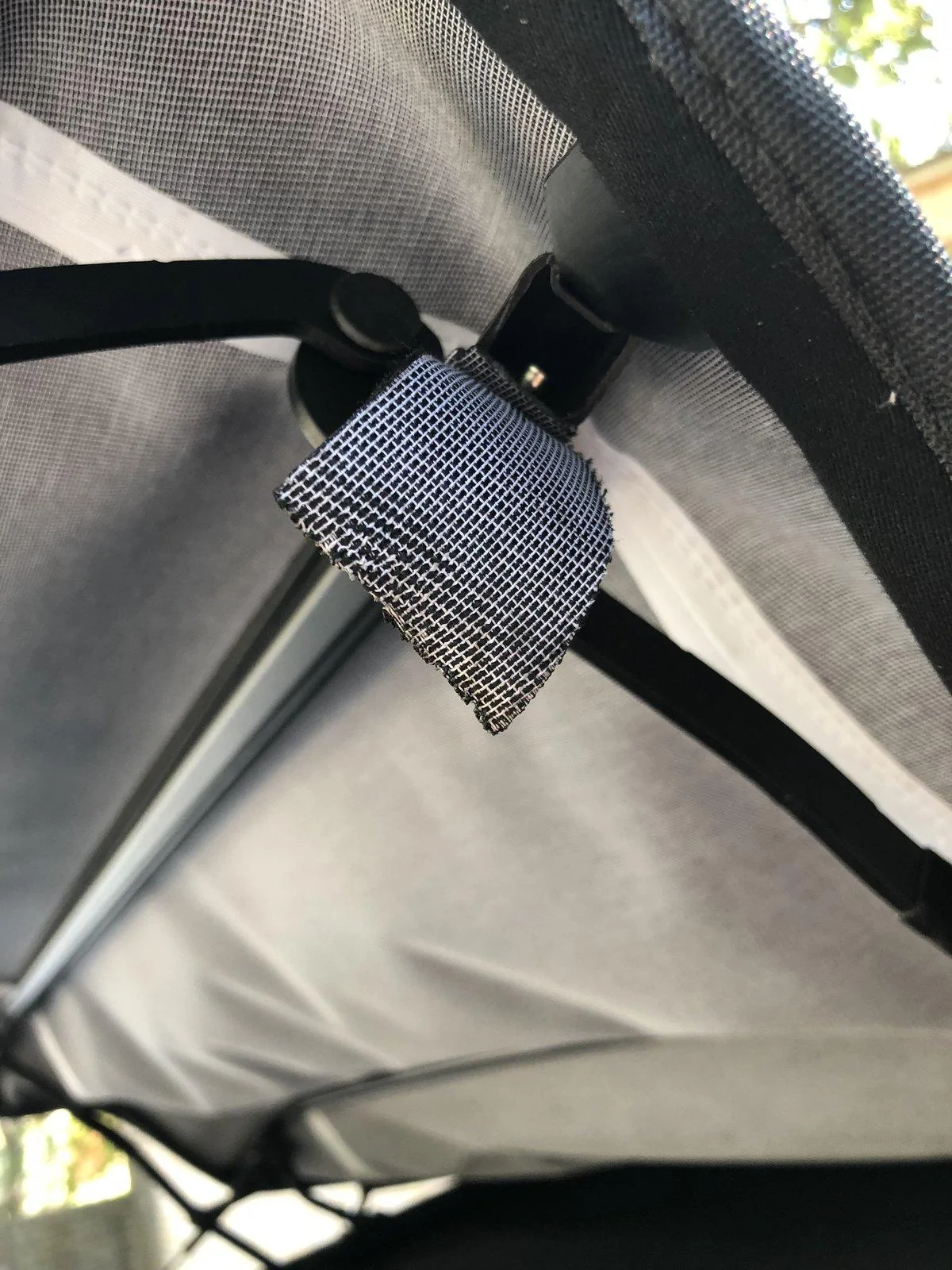

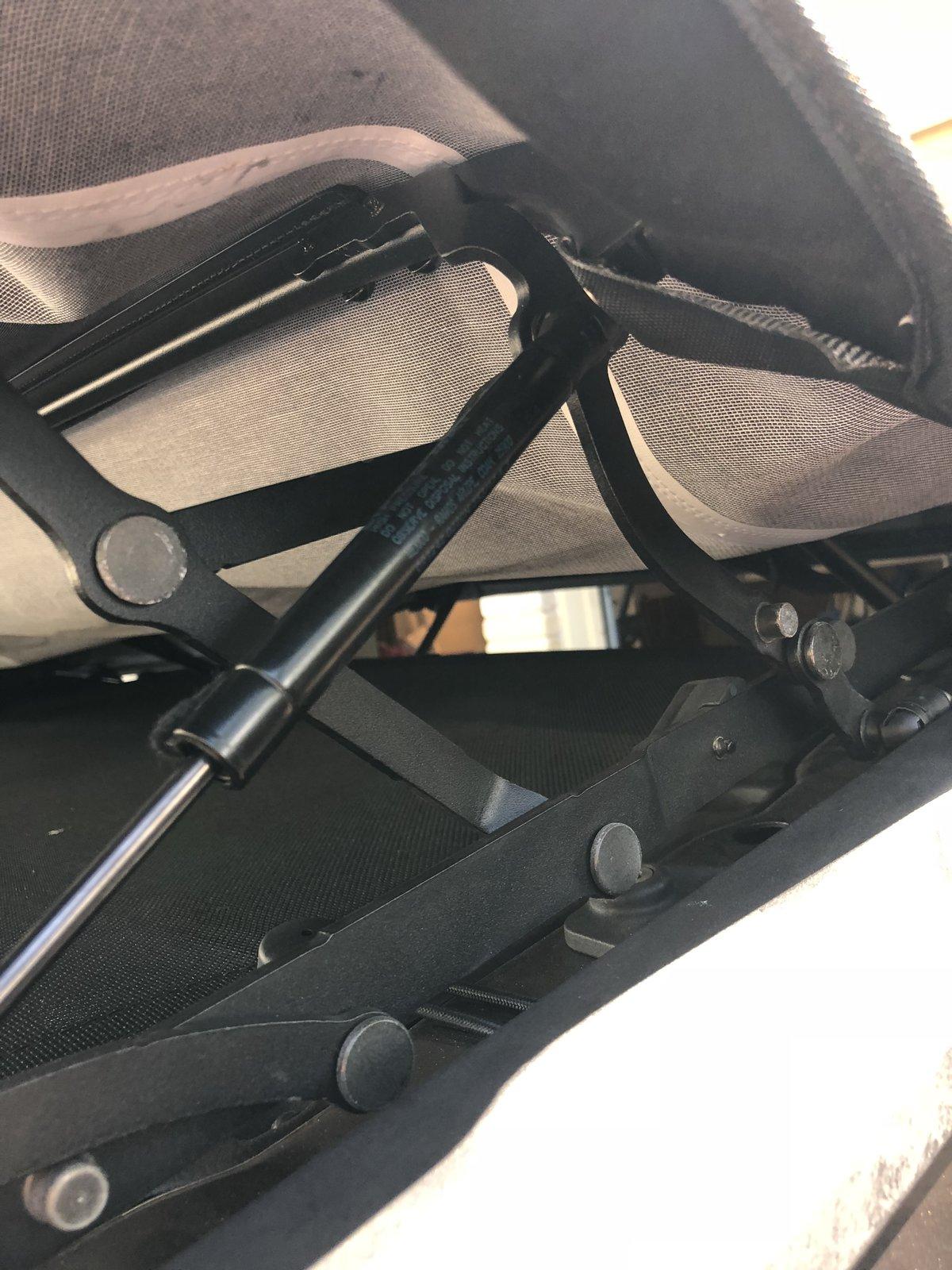

Just a quick heads up, my son and I were opening the top when he ripped something on his side and something then fell out. Upon closer inspection, there was a plastic piece that had fallen out due to him ripping a retaining strap. I went to fix it and noticed that there is a second one in a separate rail that was also tearing.
Keep an eye on these and fix before they completely rip.

Mine had started to rip. The plastic is under tension and the edges are sharp. I sanded mine down to smooth them and round the edges. However the biggest issue is they seem to be improperly seated. Most of mine were in the lower loop and not tucked into the headliner. The ones tucked into the lower loop have all been cut. The ones tucked into the headliner are all fine. Suggest everyone check theres to see where yours sit.
