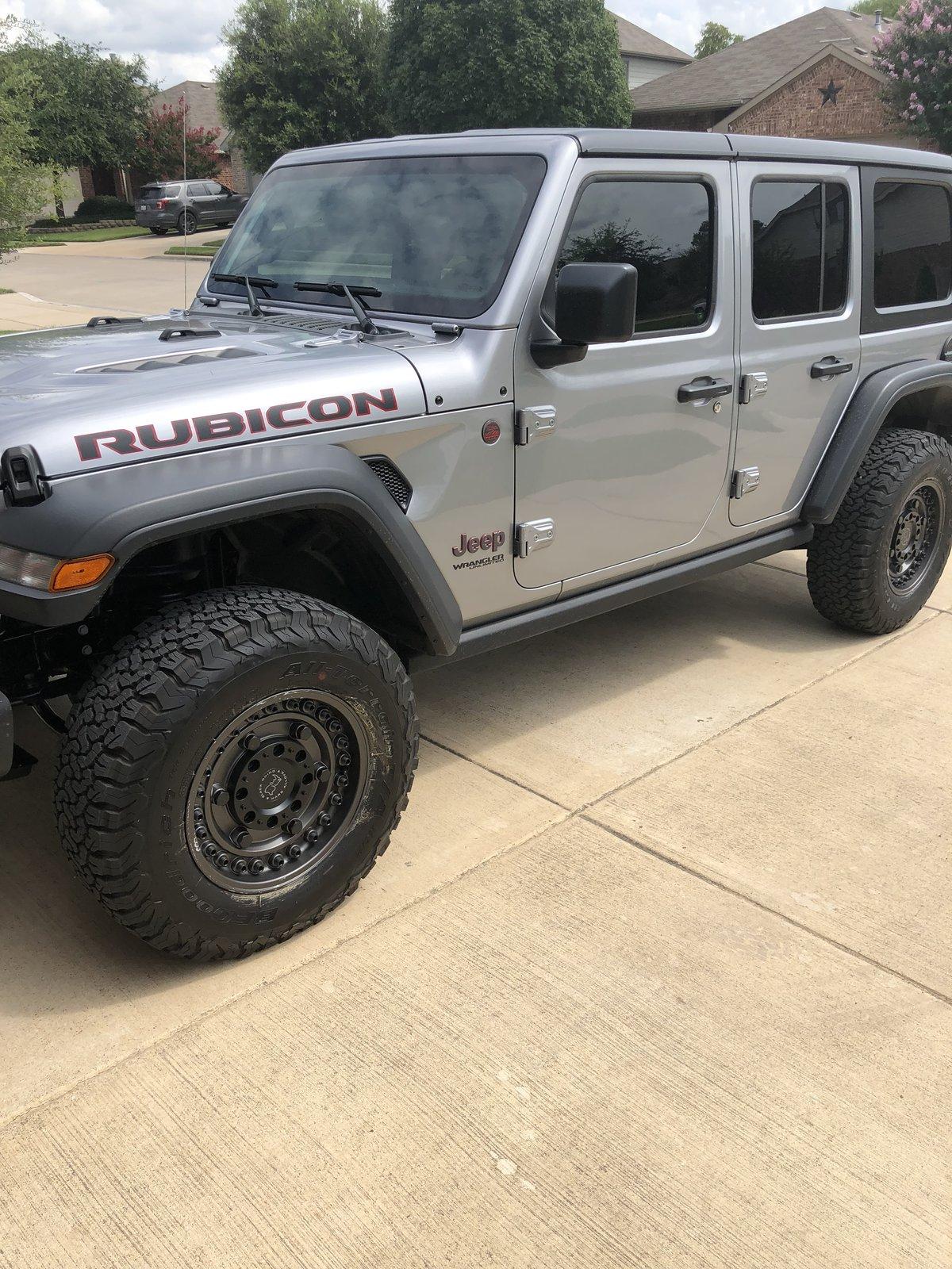

I’m running them. They are heavy, more in the range of 41lbs per wheel so only about 20 more lbs than stock per wheel. Mine are on the stock 33s. No impact on performance or drive ability. Now if you are going to run 35s or 37s we are in a different ball park. You might want to look into regearing and you will definitely need to reprogram for tpms and speedo calibration. Definitely will need tailgate re enforcement for the spare. I love them but if you run the spare like I do you will have to keep the review camera lock off it won’t fit.
