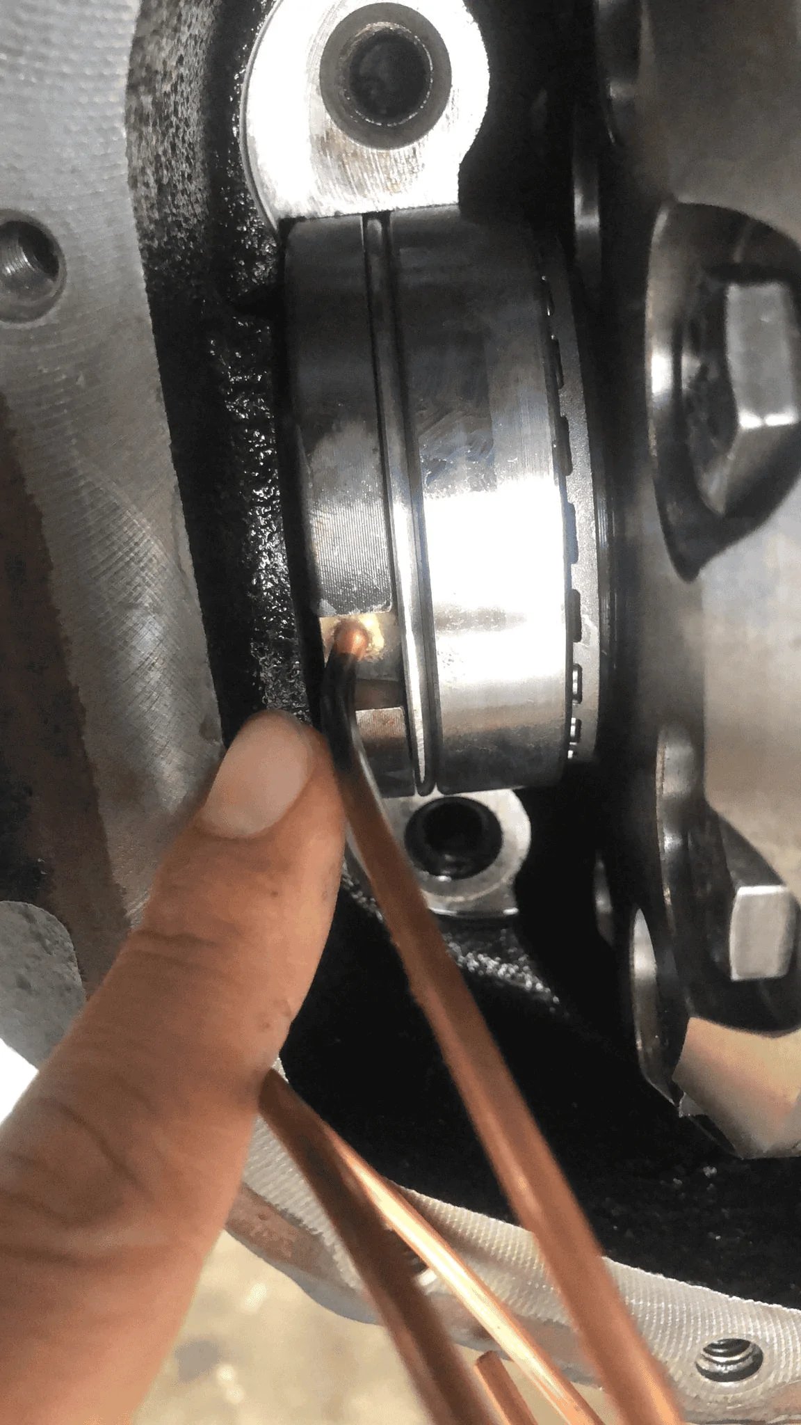

But in m186 there is no such slot. And I had to make a cut with a grinder.
Jeep Wrangler JL ARB RD100 front locker for DANA30 m186 1648653649592
Could you share your experience, how did you place the tube inside m186 ?
