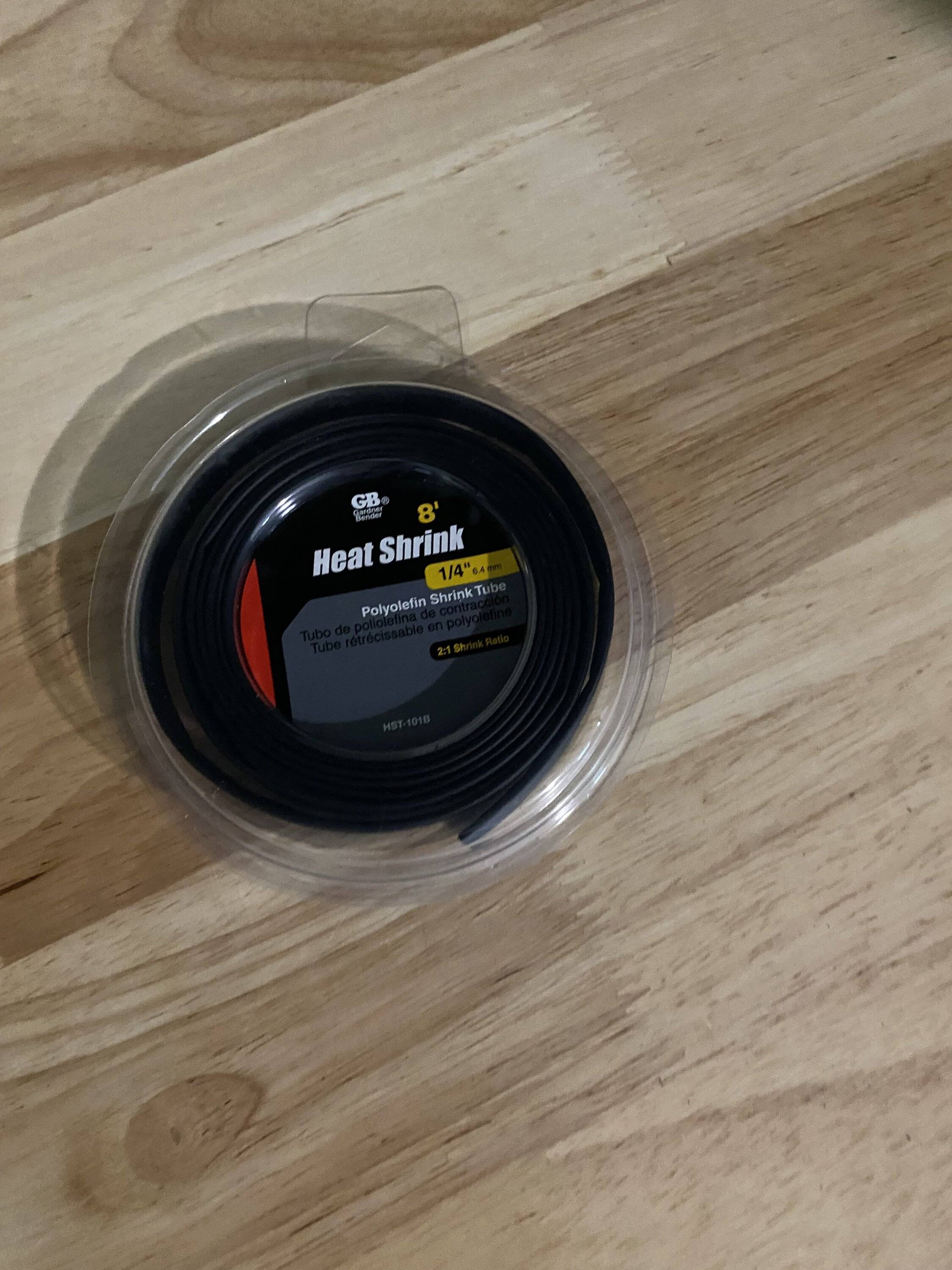

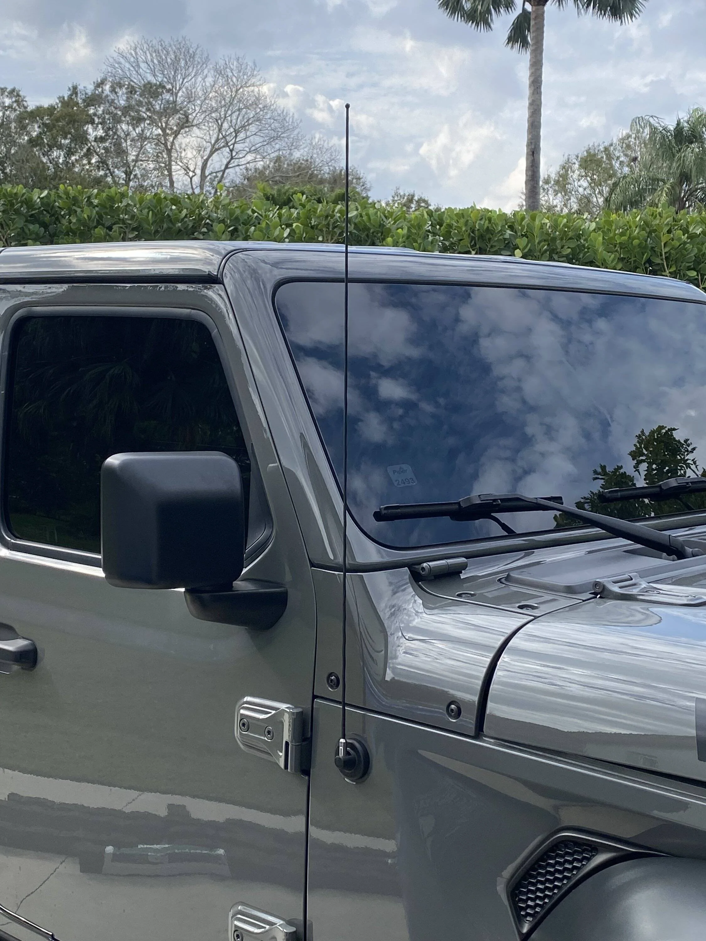

Got this idea from a member on here looking through the antennae threads. I used some heat shrink tubing to wrap my antennae black. Looks better and now it won’t scratch my a pillar or crack the window. I used 1/4” shrink tube but if I did it again I’d go smaller. It’s tight at the bottom but could have been tighter toward the upper 1/3

I did the same thing, maybe it was my post you saw, but others have done it. I used thin shrink wrap for the mast, and a larger diameter for the base. I didn't have a long enough piece for the mast, so I had to overlap the top 4". I wanted to do it over, afterward, but I never notice the spot unless I'm looking for it. This is a n incredibly easy mod to do.
Amateur Tip: Look for shrink wrap with no sizing/spec text on it. If you are going to shrink wrap the base, remove the antenna.

Very well might have been. Good idea about the base I’’ll have to go back and do the base with a bigger piece.

Find a piece that barely slides onto the base, so that when you shrink it, it will contour to the tapered area as well.

Be cautious on the type of heat shrink, as some has glue that is activated with the heat. Works well for wiring but not sure it would be good for this use...and may make it a pain if you needed to remove due it being damaged

Good point. I would have rather replaced it with a black whip antennae of the same height bad stock. I use it to tell if I’ll make it under trees/garage.

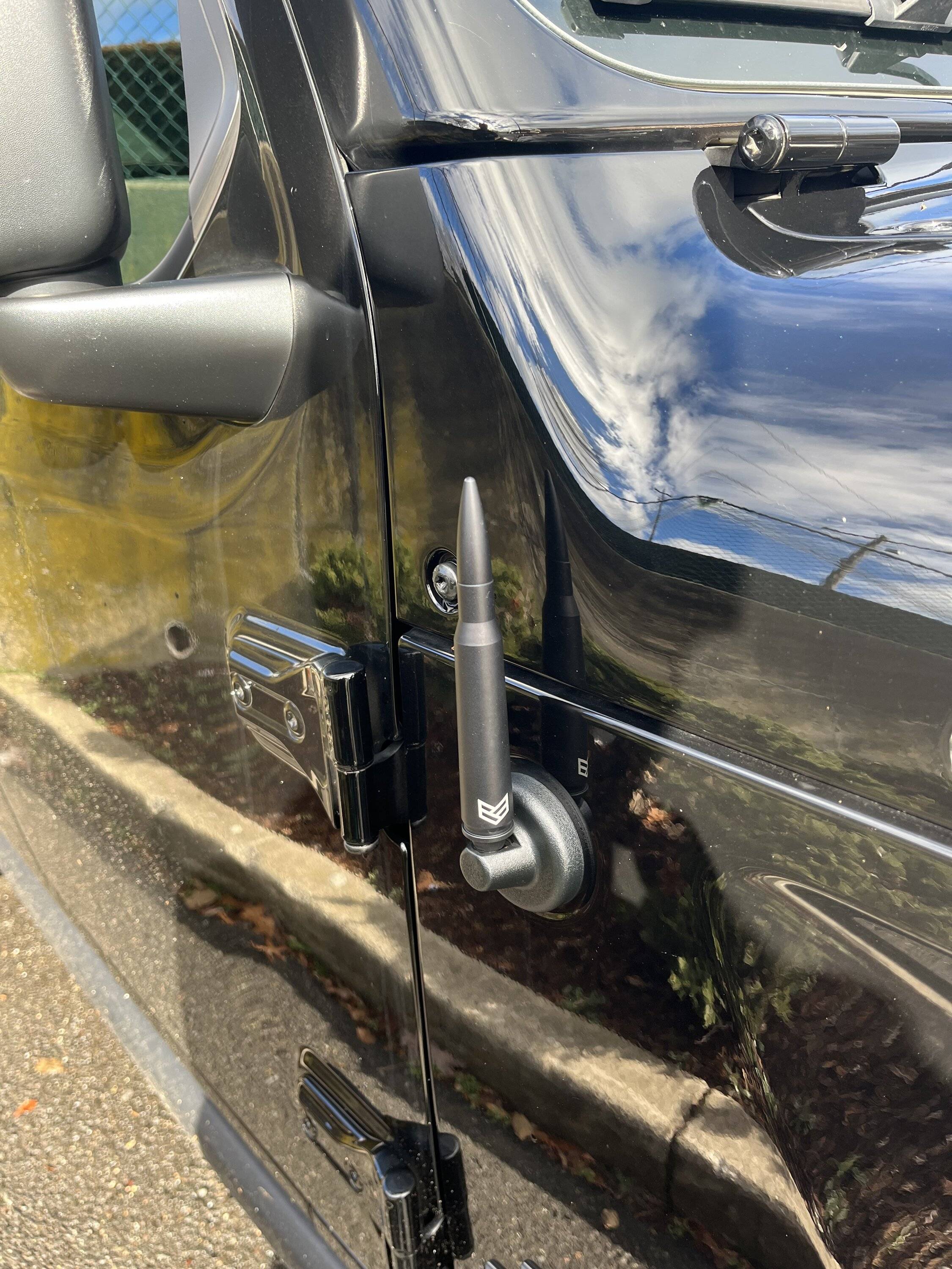

Can’t stand the long antennas. I swapped for this.

Yes, do take care when using marine heat shrink tubing (its proper name) on a particular project. The internal adhesive is very strong and fairly inflexible when cured.
As when chemically welding PVC with primer & cement, consider the use of marine heat shrink as a one-chance, permanent add-on. When used properly, it is a very durable protective layer.
