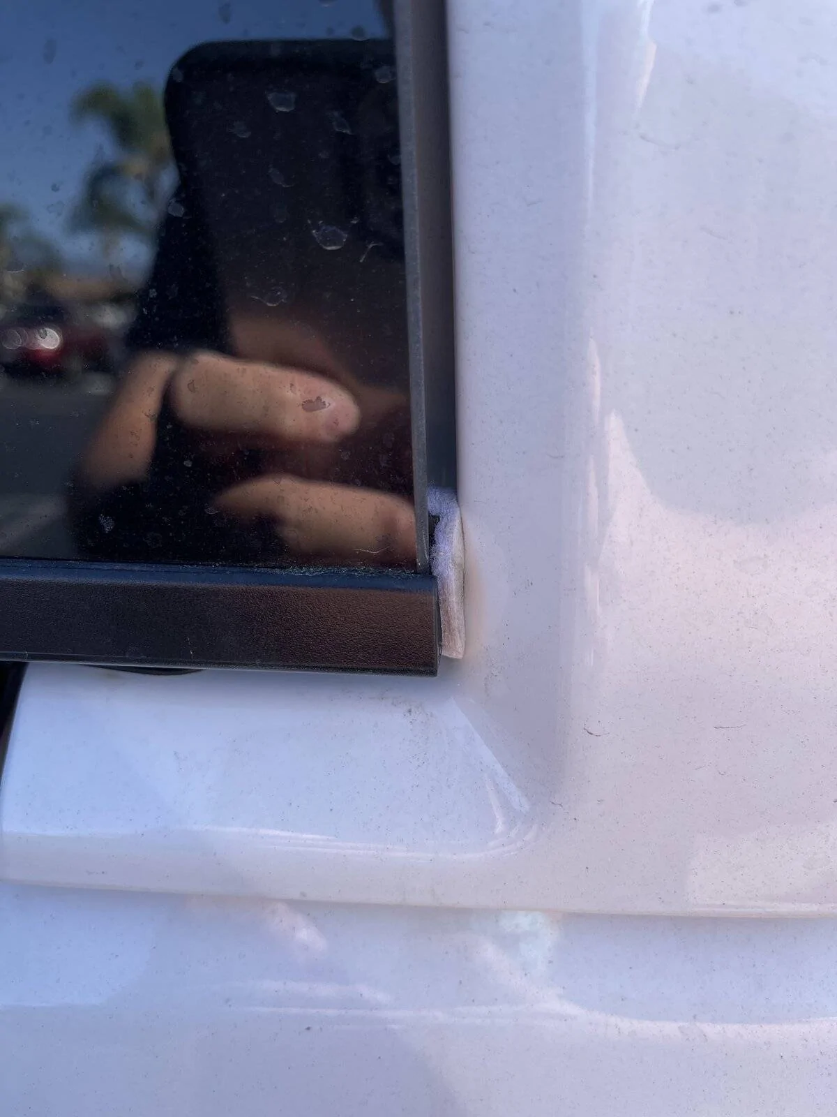

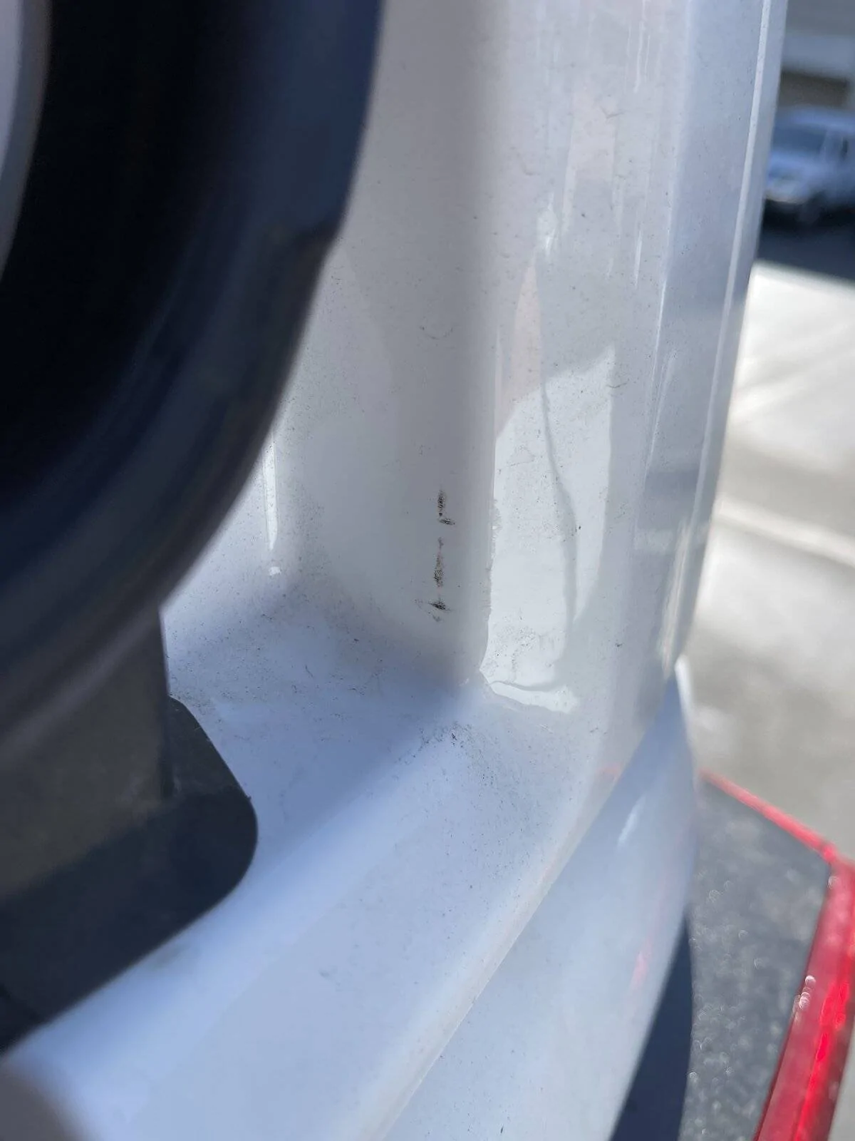

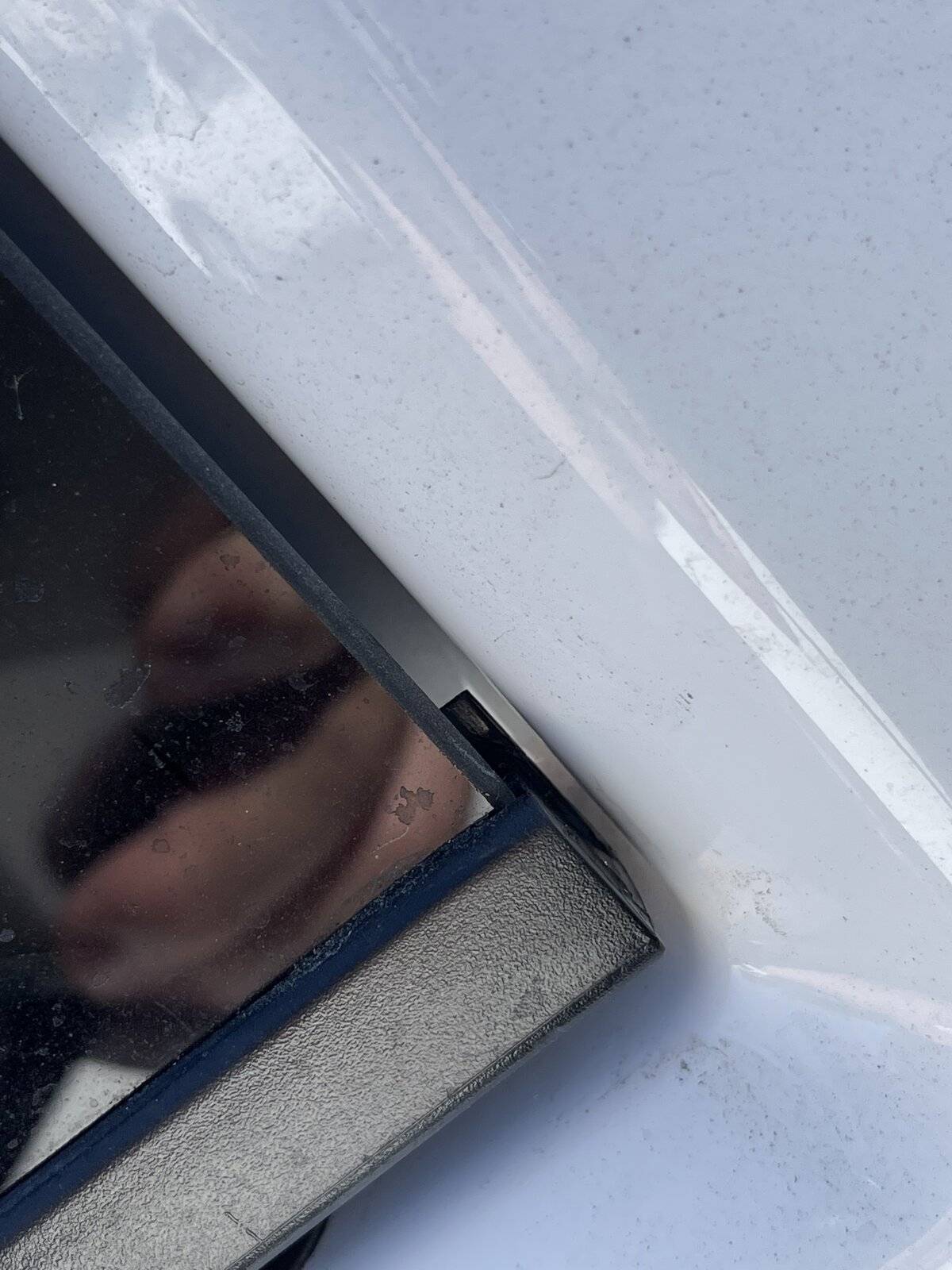

I know it’s a Jeep. But just trying to share, if someone is as frustrated as I am.
This rattle is really hard to locate, it only happens in 95+ F so I guess the trim heats up and expanding thus making contact.
It is the gap between rear glass and hardtop, will trying to file/grinding some of the trim piece to make permanent fix.

I would attempt to adjust rear glass alignment. Certainly should be some room to adjust at the hinge connection point.
