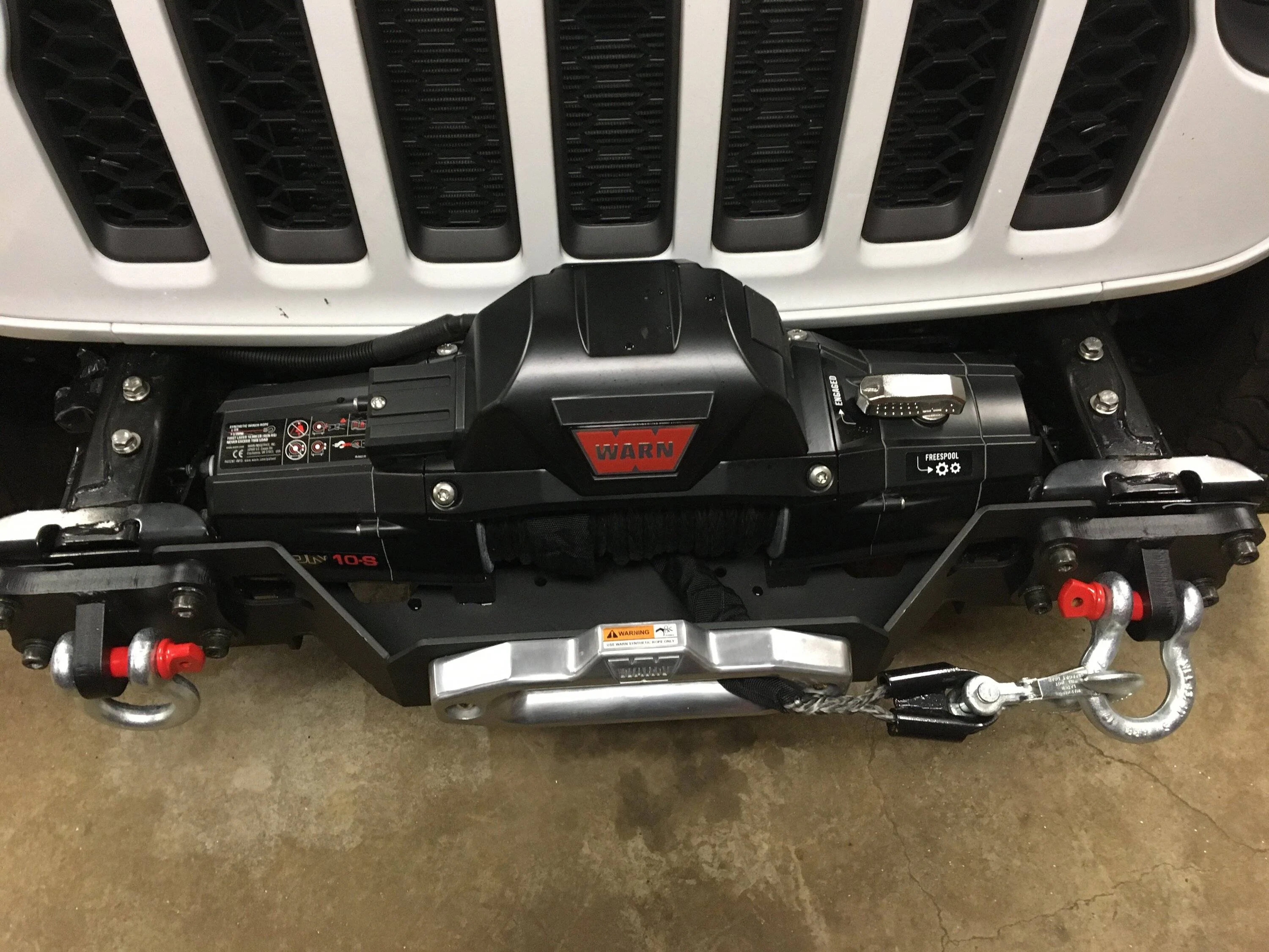

With my new JLUR I decided to go bumperless and run just a Warn winch plate and some EVO D ring shackle mounts. I still wanted to figure out a way to mount my HI-LIFT and be able to mount a pr of Baja Designs Squadron S2 fogs.
I came across https://www.jrjdesignsus.com. JR had already developed a HI-LIFT mount for the front factory steel bumper. Gave him a call and we discussed what I was trying to do. JR was more than willing to work with me to develop a custom mounting solution that would meet my needs.
After a lot of measuring, phone calls and facetime JR had a solution for me. My new brackets are bolted directly to the frame and are stout heavy steel. Brackets are mounted to the frame with grade 8 HDW and I modified a HI-LIFT mounting kit to reuse the lockable mounting studs. The brackets have tabs at the sides that I used to mount the fogs. HI-LIFT is very secure, easy to access and out of the way of winch and headlights.

Here are a few pics of the install,
