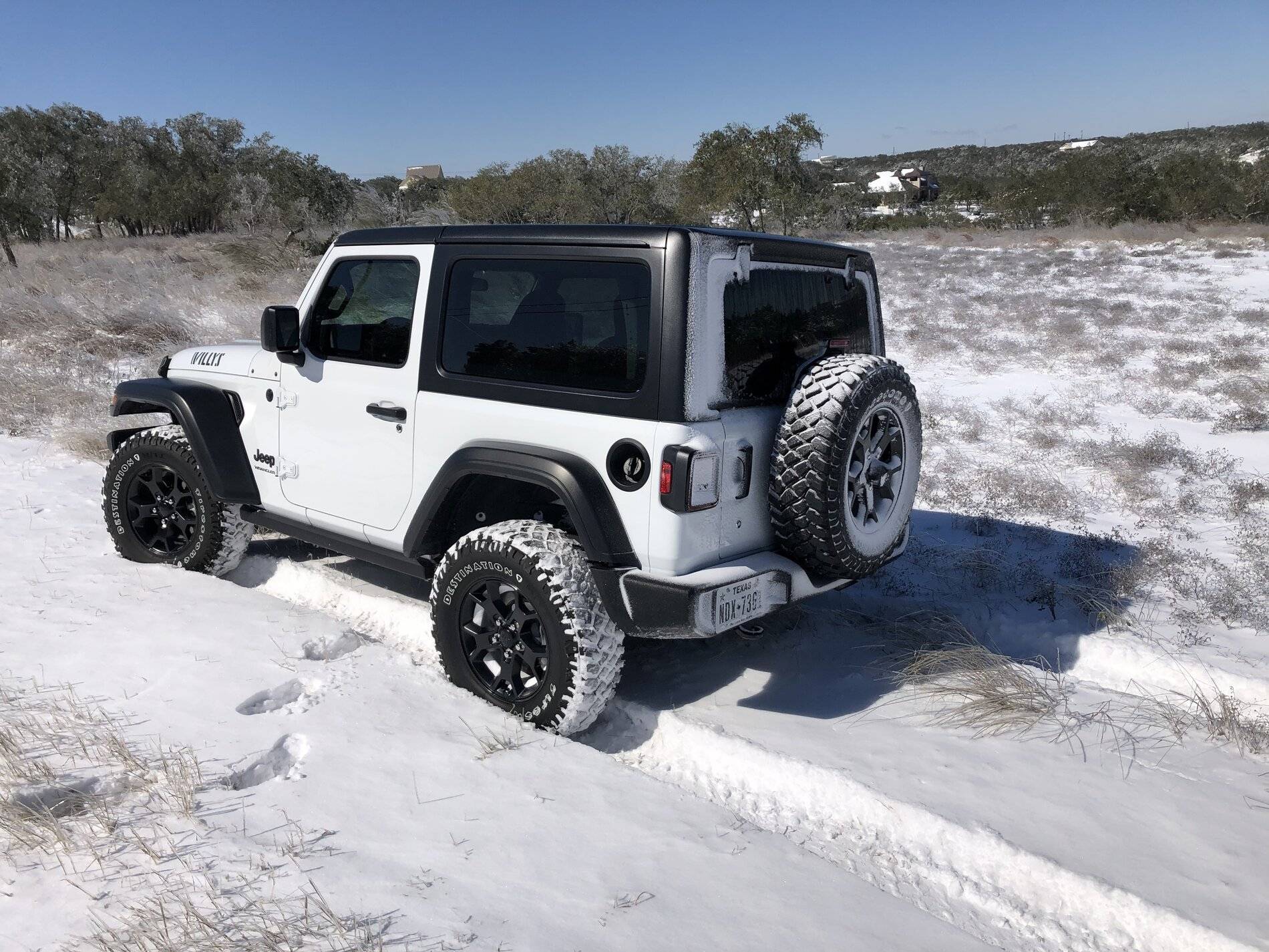

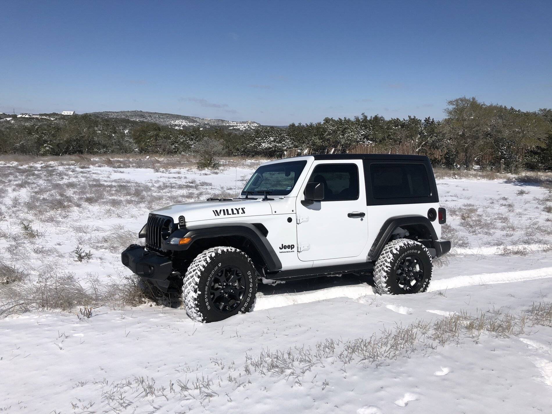

They worked well for me. We had a weeks worth of snow last winter. Extremely, unheard of rare for here. They were awesome on powder. The narrow footprint was great. They would definitely need studs for ice.
Pics taken down the road from my house. 29.4 degrees south, 1200 ft altitude. 15f degrees out at noon. Mid February. This was the second snowfall of the week. Crazy.
