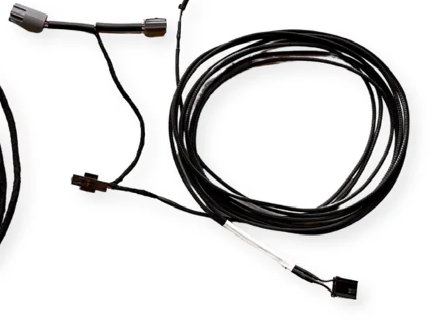

I am adding rear park assist to my 2021 Sport Altitude. I have figured out all the parts I need except one. I have the part numbers for the bumper (6QE17RXFAC), sensors (6MK25TZZAA), Module (68441031AC) and bumper wiring harness (68414894AB). The only one I cannot find is the part number for the wiring harness that goes from the module (in space behind taillight) to the connector behind the passenger door and up to the dashboard. Any help would be appreciated.

Messaged with Benny a few times. He was very helpful. He told me that the cable is not a mopar part and was made by infotainment.

I bought the entire kit from infotainment. Without that cable it really cannot be done. Even though you can buy the individual parts for less than the $599 infotainment is selling them for, if you do not have the cable, you cannot retrofit it. And you need a new bumper also. Benny priced out a new bumper for me but I just haven't decided what I am going to do. I may remove the bumper and drill the holes myself. If that doesn't work, I will just order the new bumper from Benny.

Its not a difficult cable to make yourself.
