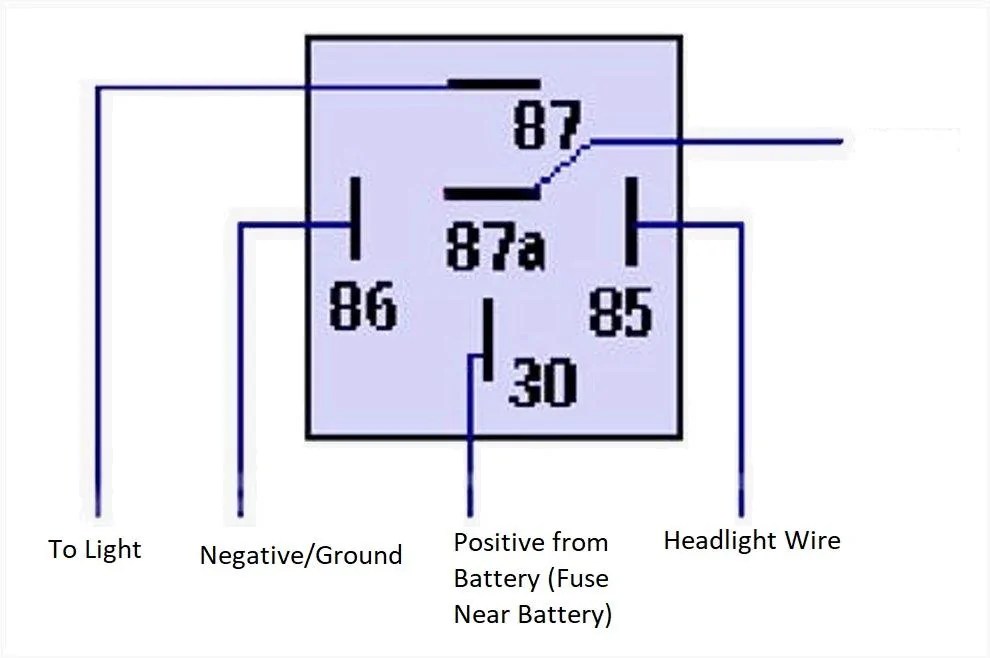

If you want to add the lights to come on with the high beams, wire a relay in with the high beam circuit. The draw on the relay coil is fairly low and will not affect the overall operation of the lights. You would then wire the contacts side of the relay to a power source (battery, spare fuse, Aux fuse location (since you don't have the Aux Switches). that way, when the relay is energized, the lights come on and are powered from a good source (and properly fused for the application, hopefully).

Not sure how "talented" you are with wiring, but i bet you could put together something with a relay and use the high-beam power wire as the "switch". I would think that you could wire-tap the power-wire on the high-beam and wire the rest. I have done similar wiring, but not this exact thing.

I'm not condoning what you wanting to do but this would the diagram for a relay. Each light would need a relay. Better to run one switch to all of the relays instead of using your headlight wire.
Andy
On edit, this isn't a good idea with LED headlights since the resistance would possibly cause Light out warnings and possible fuse blowing.
Rough Country makes a decent 6 switch panel https://www.quadratec.com/p/rough-country/mlc-6-multiple-light-controller-wrangler-jl/lower-70964 It is a fairly easy install and isolates your Aux lighting from Jeep wiring. (No Warranty Concerns)

As @JoeValkIS said, you only need a relay. I believe the one relay is enough for a pair of KC lights. They typically send what you need in the box. You run the coil to ground and the high beam, the other contacts to the lights and battery. It won't hurt the high beams at all to power the coil. If you want to add a switch you can, but it's not necessary.
