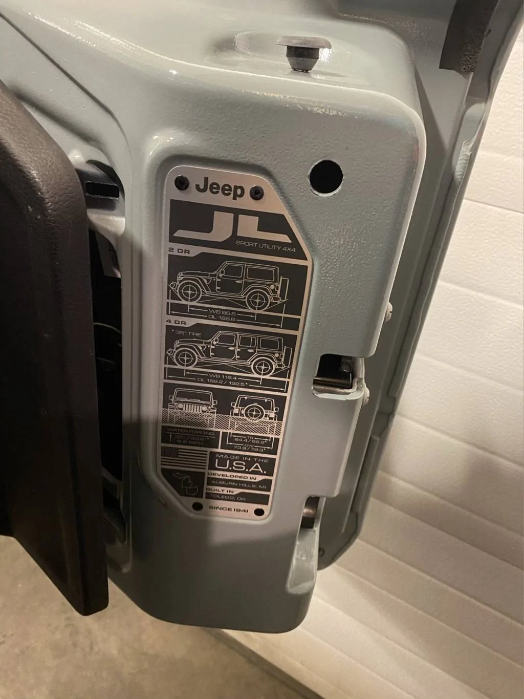

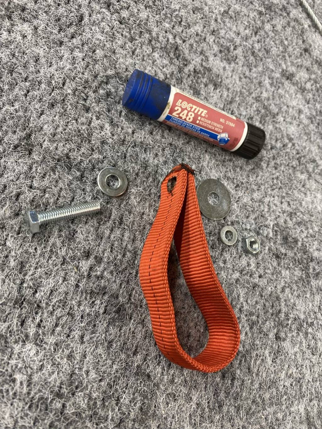

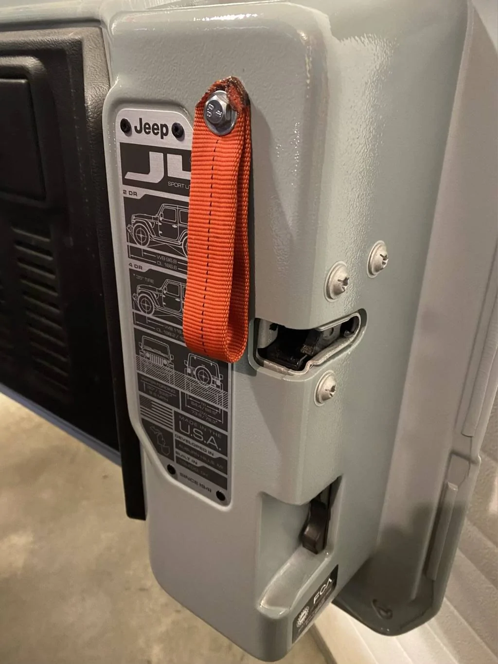

That looks good. I was tired of getting dirt on my hands every time I closed the tailgate too. I went for a webbing loop strap. I removed the tailgate trim panel to access the area behind the existing hole and used a single bolt - no well nuts.

Functions well - doesn't interfere with the latch - we'll see how it holds up.
