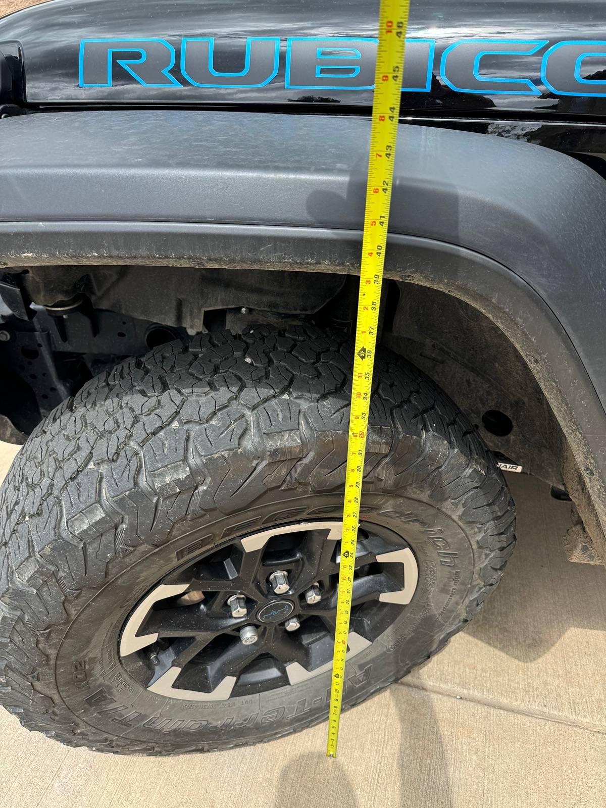

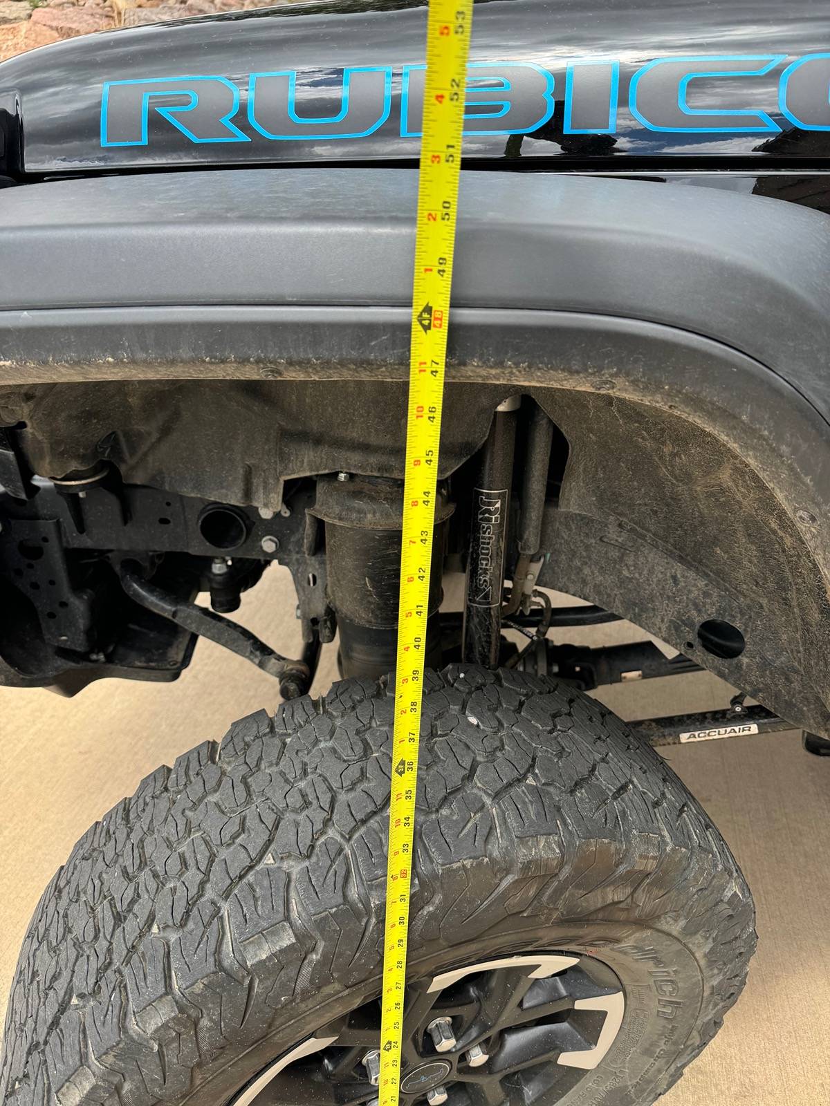

Jeep Wrangler JL Accuair install problems ('24 Wrangler) IMG_3116
Jeep Wrangler JL Accuair install problems ('24 Wrangler) IMG_3113
Lowest to highest. About 8” difference 0_o 🧐
