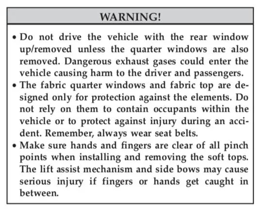

In Jeep's defense, they recommend not driving that way (although not for that reason).
Jeep Wrangler JL 70 miles and hour with back window removed EE2AAF73-F652-4E92-A720-86AA978A5472

Again, I don't understand why some elements of the new soft top seem to be perplexing so many people. To me, when I put the top up or take it down, it's fairly obvious that the back window is what really keeps everything tight and in place. Do you not feel the tension created when you stretch the back window's final tuck? I would never ever ever attempt to drive at any speed with the back window out but the side windows in, no matter how secure I would think them to be.

So I found out today (thanks @shadowhunter22) that soft top JLs ship with two elastic straps with snaps on, and those elastic straps snap into the inside rear of the soft top, and are to hold the rear window in place when rolled up. I imagine this is just for lower speeds, and only when the two front windows are also fully rolled down (to avoid the exhaust gas buildup issue), but I've had my Jeep a month and only just found out today that the JL rear window roll-up is possible. I haven't tried it yet, but apparently it is quite possible ... I'll be giving it a go soon!

Purely anecdotal, but I've driven plenty at highway speeds with just the back window rolled up and have not seen any issues. I also have the rear windows down (or at least cracked) to avoid exhaust gas buildup, but never worried about the rear quarter windows coming out. Mine take a solid tug to even get loose in the first place when I want to remove them.
So that’s what those are for! I’ll have to try when I put the windows in tomorrow.

Same here. I drove most of last summer with the rear window rolled up (used the Velcro straps). In retrospect I probably shouldn’t have due to the fumes. I’ll rethink it this season. But, at least to me, the side windows seem very secure. I really don’t think attaching the rear window makes much of difference. The side windows snap tight, the C pillars are tight in the pocket.
