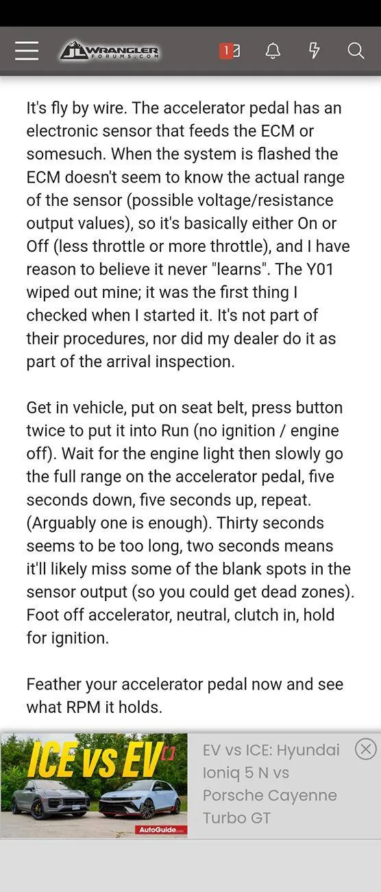

Try re-programming the accelerator pedal. Put the jeep into "run" but don't start it. Slowly depress the pedal to the floor and then back out. I've found about 15 seconds from out, to the floor and back works good.

Agree get the free new clutch. I did and it drives better than it ever did. I believe the revised program helps too. I also agree the drive by wire throttle is most of the problem. Zjamison can you explain the pedal reprogramimg in more detail. Like how do you finish the new setting. Thanks!
