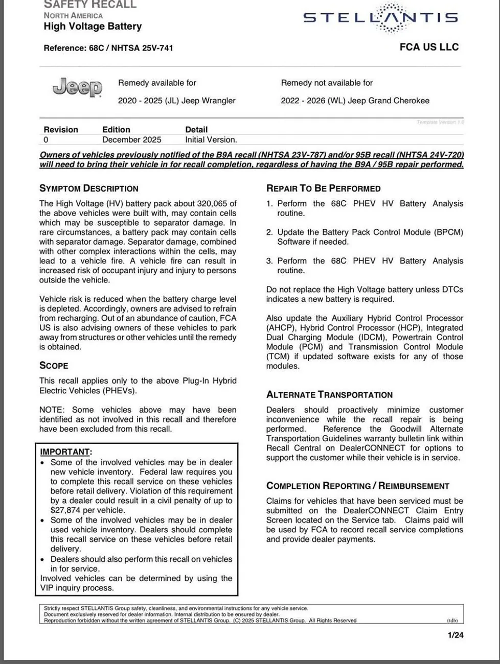

Well, sucks that it's not on the Grand Cherokee yet. I ended up trading my 4xe Wrangler recently, but we are hanging on to my wife's 4xe GC. But, glad that they are finally ready to start the testing. Again.
Also encouraging that they are being proactive and telling dealers to give everyone a loaner. Last recall on my Wrangler I had to push pretty hard to get the dealer to commit to a loaner, and I think that is only because I also had a warranty-covered issue that needed to be fixed at the same time

Thanks for posting this. I just called my dealer—they confirmed they have the update available and scheduled an appointment. She also offered a loaner if needed.
She explained they’ll run a diagnostic test first. If everything comes back clean, no further action is needed at this time. If an issue is detected, they’ll need to order a part or module and install it, along with any additional software updates.
She couldn’t say exactly how long the full process would take, but recommended planning to drop the vehicle off for the day.

The only part that will be physically replaced is the battery, so if they tell you they're ordering something that's what it is
They may or may not perform a software update on other modules like the charging modules and battery and hybrid controllers, but those are just software flashes

That could be what she was referring to. I just had my battery replaced last month as the 2nd part of the 95B recall.
Of course it was replaced with the previous battery. Not sure if they have a new updated battery ready for replacement??

Can confirm 68C recall is now available for JLs. Recall is almost identical to the 95B, though it seems the test drive part isn't always required anymore depending on what wi-tech spits out during the analysis.
Three fire recalls deep and we're still doing software updates.
On a side note, we've had so many module updates for the BPCM we've officially rolled over from AA-AZ nik levels over to BA. Very impressive.

you need to remove the bypass cables and connect the security module

This is my understanding as well. I had my modules updated/flashed a couple of weeks ago. Seems like the only action with this recall is a new testing procedure that they’ll run to determine if your battery needs replacement.
