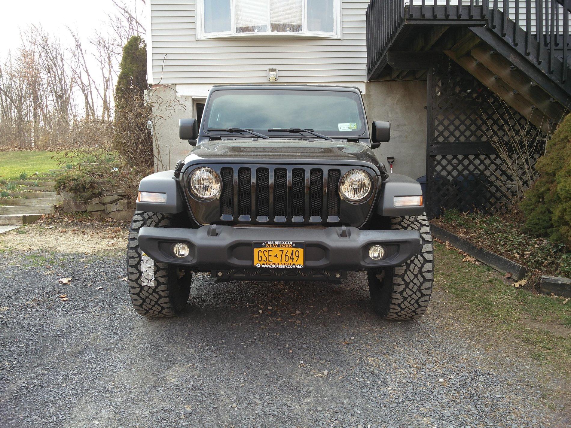

It was only rubbing on the euro insert bumper part but I had to take whole thing off to take the inserts out.
Like others have said... That is way too much tire for a Sport. Suggest taking off the 35s until you can install a lift. Your fenders will thank you.

That’s the funny thing. If he would have left his stock wheels it would have fit better till he got a lift. They wouldn’t be sticking out past the fenders.

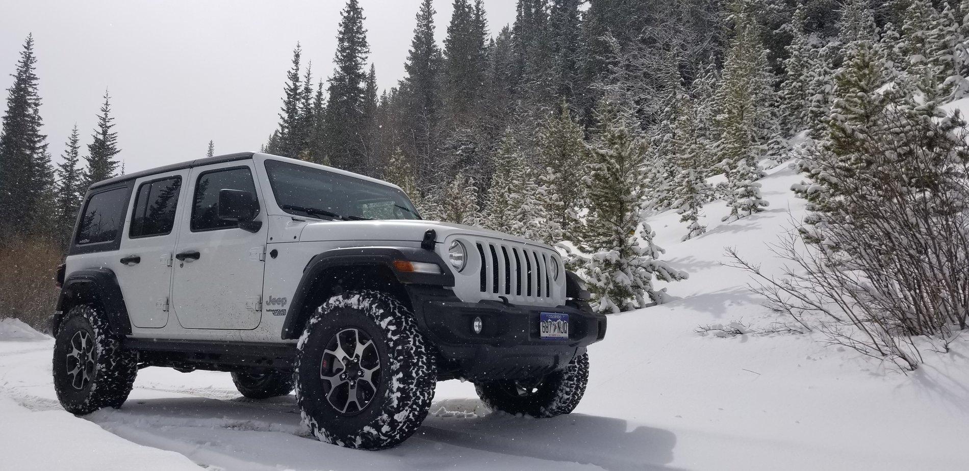

Them things are stuffed. Below is mine on stock wheels with 2.5 lift. I would hate to be behind you as you destroy everyone's windshields since your tires stick out 2" on each side..
I did my research.

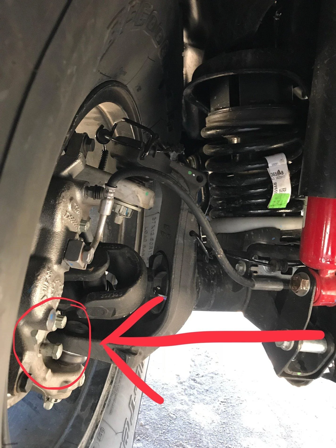

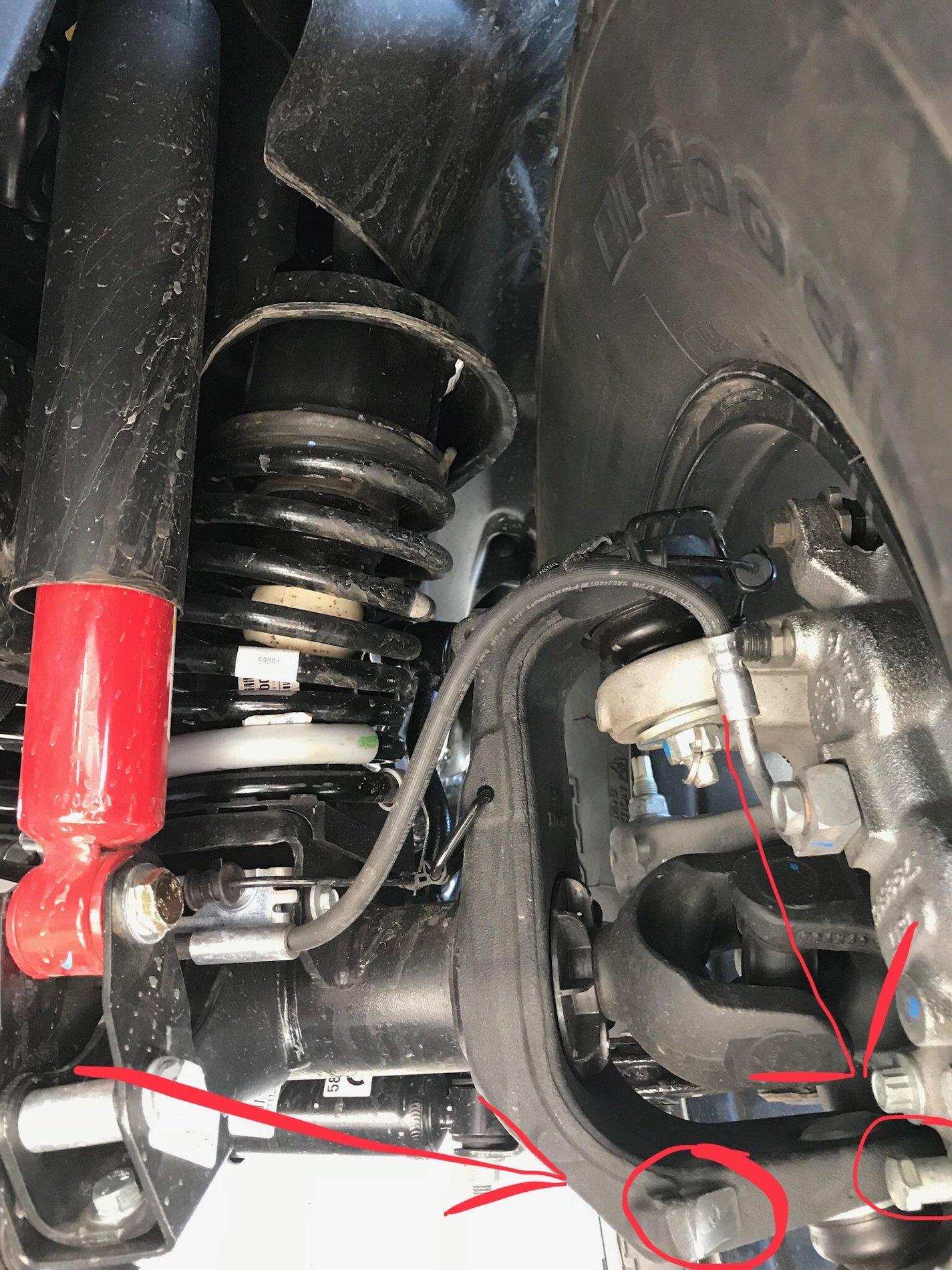

All you need to do is adjust your steering stops a couple turns out. Problem solved. No spacers needed.
Everyone pay attention to how mis aligned the spring perches are here.
