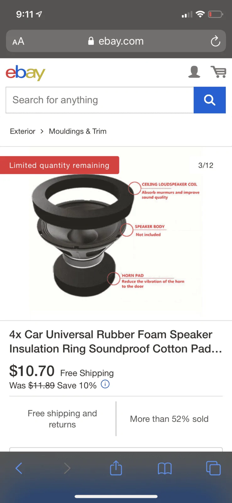

Found these, you think these will do the job. Also by the way I do not mind the advice at all. I’ll take all the advice I can get.

There's a link to the foam rings in my last post. Your local shop will have them, too. As for the polyfill, I've always used it, though I don't think the difference is significant when also using sound deadening material, too. It is cheap, and likely worth a shot since the speaker's haven't been mounted yet. Online sources seem to swear by it.
