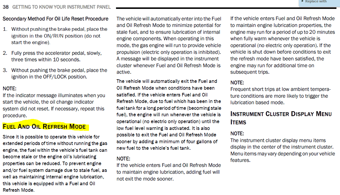

Was it sitting on the lot for a while? Sounds like FORM (Fuel/Oil Refresh Mode).
It's there to protect the fuel from getting stale if you only drive in electric, or the oil getting too much blow by fuel in it without a heat cycle to eliminate it.

Surprising FORM would hit that quickly. I'd give it some time, or at least until you do the Lubrication reset in the OM Hybrid supplement I posted above (20 mins at temp) before worrying too much.

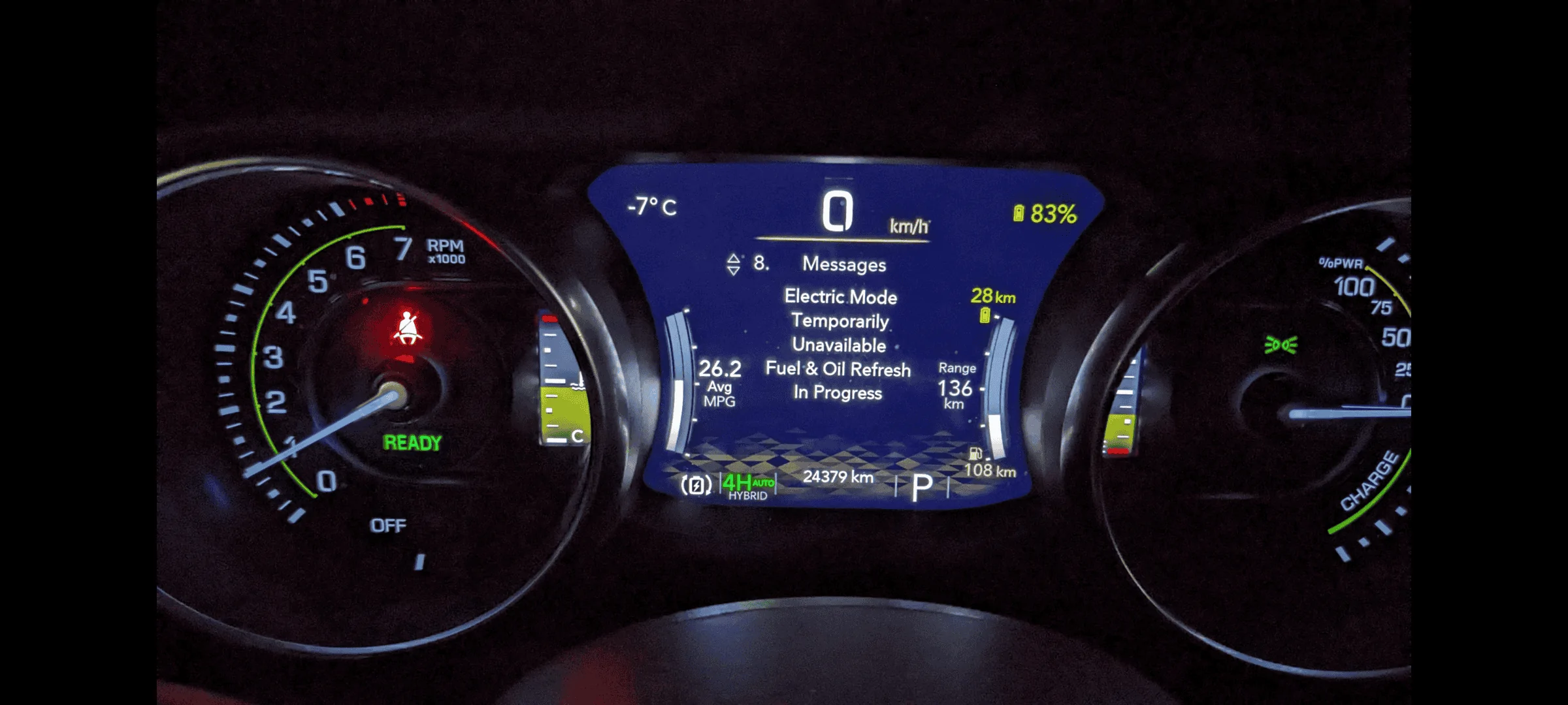

Cranking up the heater can also prevent electric mode.
This is me last December, I crank up the heater to defrost when the weather is crappy, raining usually, but most times I use the heated steering and seats, and no heater while driving in electric, the heater uses a lot of battery, if you require the heater going just run the gas engine.
