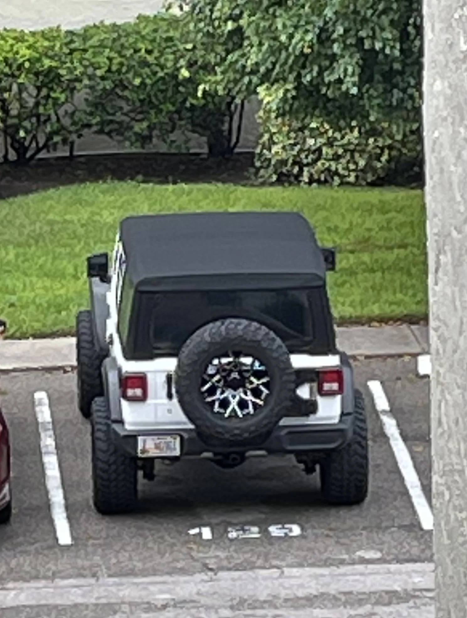

325/60/20 = 35.4/12.8/20 according to the interwebs i used.
Here's 35/12.5 on 20x10's at -24 offset on sport-width axles:
Jeep Wrangler JL 325/60/20 IMG_1388

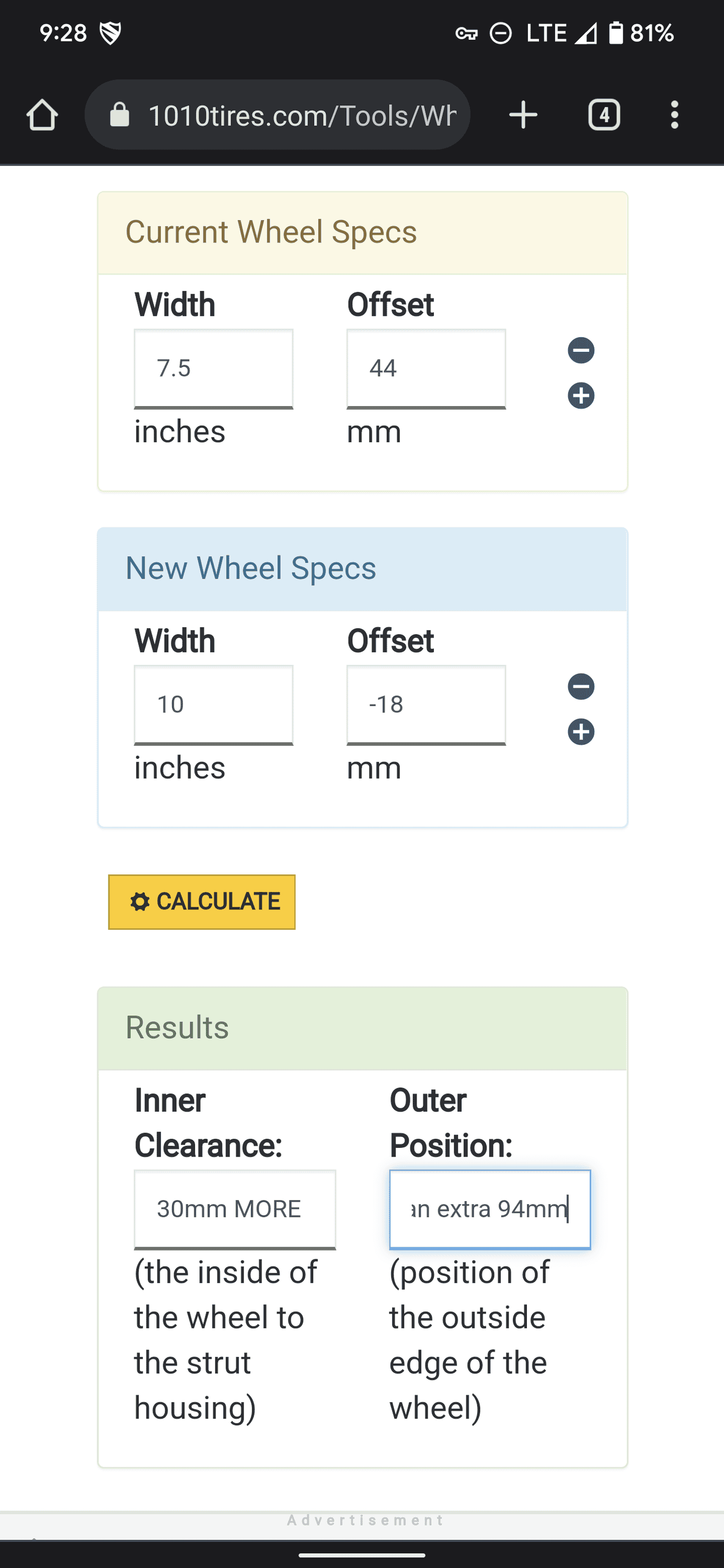

Looks like the inboard edge of your wheel will move out 30mm or 1.18" and the outboard edge of your wheel 94mm or 3.7". So, you can take a ruler and press it up against your setup up now and at roughly 3 and 3/4 inches is where you'll poke too.
Jeep Wrangler JL 325/60/20 Screenshot_20220812-092829
thank you for this!!

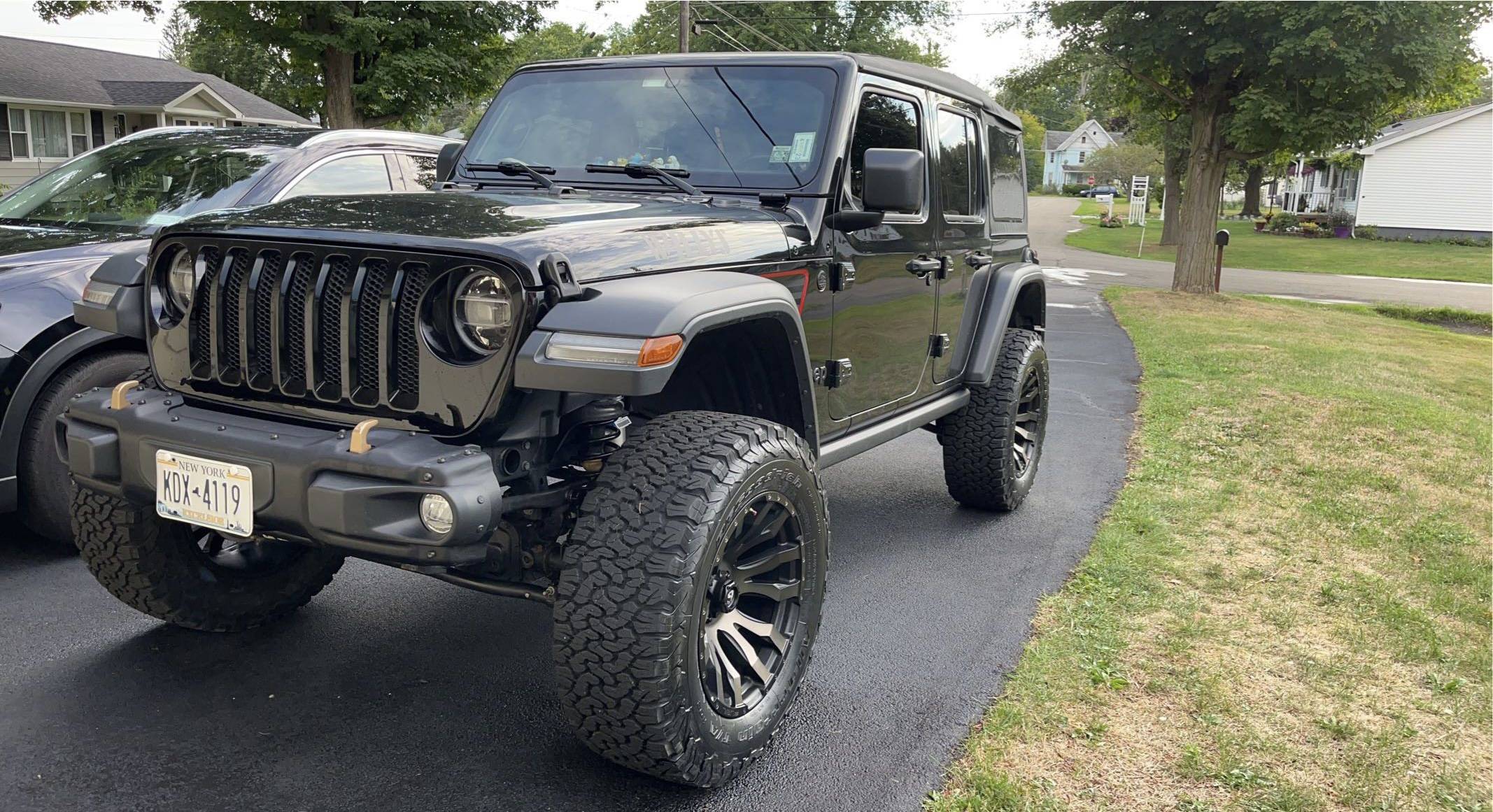

Thanks for all your input!! Here is the final result! 325/60/20, Mopar Lift, 20x10 -18
Jeep Wrangler JL 325/60/20 B37197C9-794C-4BD4-9267-6EE41B77A73E
