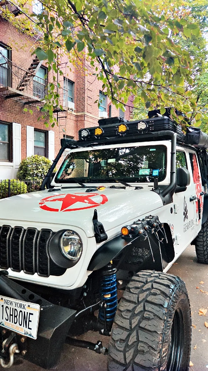

I want on and off on
Light schematics/instructions would be helpful. Some systems use a momentary on in their circuit. We would need to know what lights you are working with.
Some amazon knock off look at the pics

I can't really tell what they are, so... 🤷‍♂️
Good luck in the search for your answer.

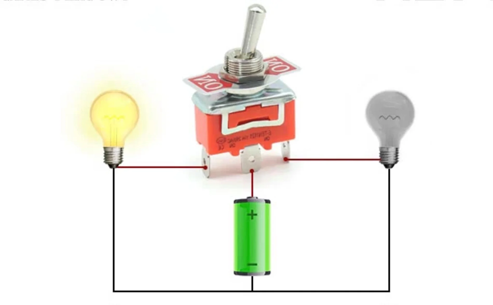

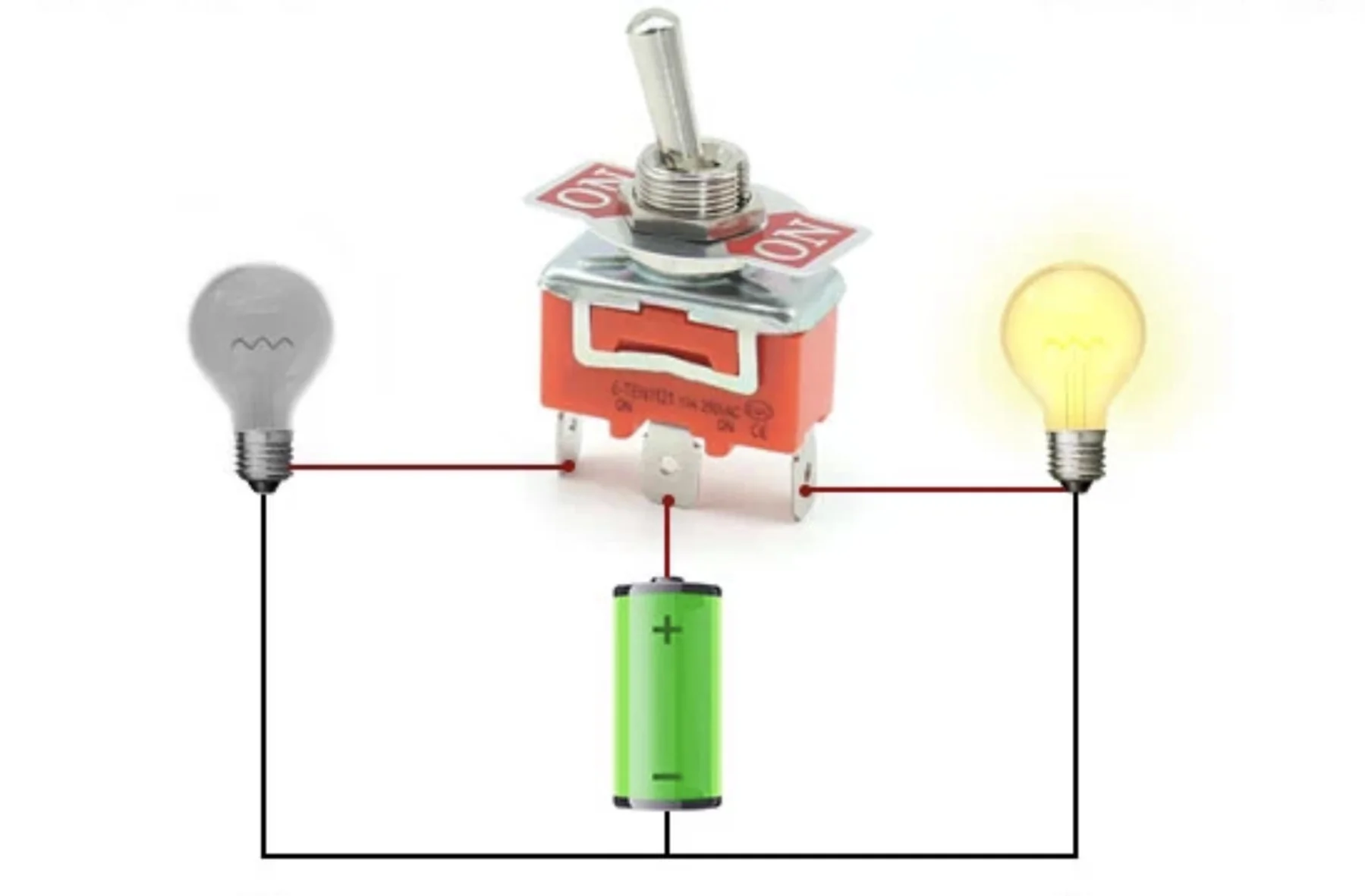

Do you want to control two devices from one switch so they are on separately? if so you want a 12 volt 3 prong on-off-on rocker switch.. In the center position nothing receives power.
This isn’t intended to be a wiring diagram, or advice you should follow, just a basic but incomplete concept. With the toggle (or rocker) moved to the left hand side the right prong receives power. If it’s moved to the right side the left prong receives power. Move the toggle (or rocker) to the center position and both sides are off.
You will need to provide a lot more specific information for anyone to give advice. I don’t have the knowledge to recommend specific switches, relays, or wiring diagrams based on what you’re saying. Nobody wants your Jeep to burn down because of a miscommunication on either side. Any reputable car stereo shop could safely do this for you at a reasonable cost.

You need an “on-off-on” switch that will mount wherever it is you’re planning to mount it. Depending on how you want the lights to work, and the current they consume, you may need relays and diode as well.
You really have not provided enough specifics for anyone to give you an exact answer.

Those pics I posted are just to try to explain a basic on-off-on switch, not a wiring diagram you should follow. If you’re not 110% sure what you're doing there is no shame in having someone else do the job.
