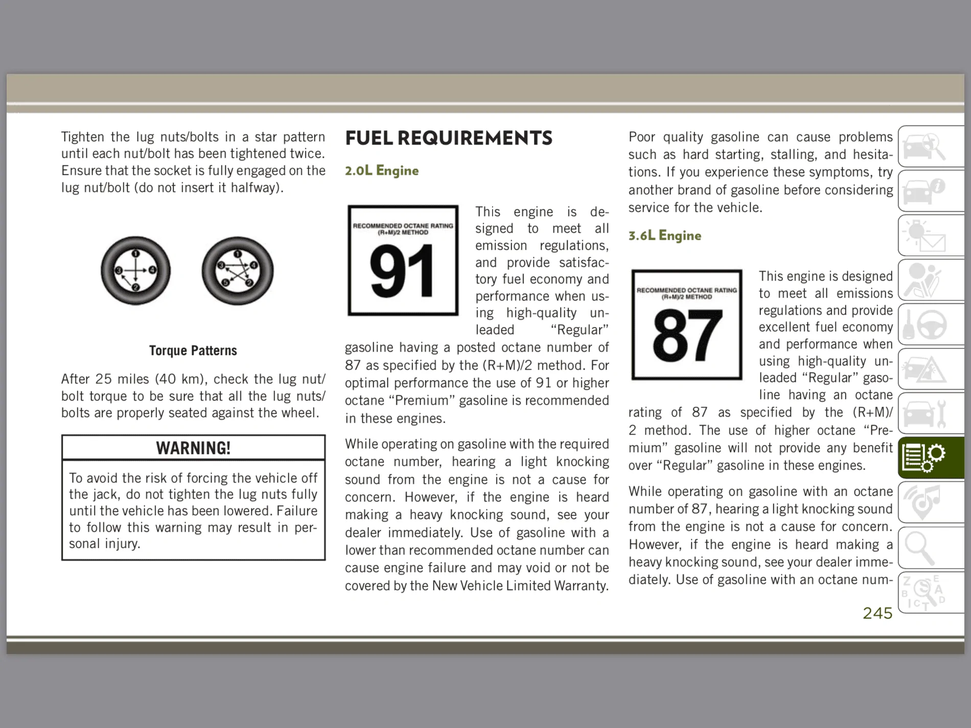

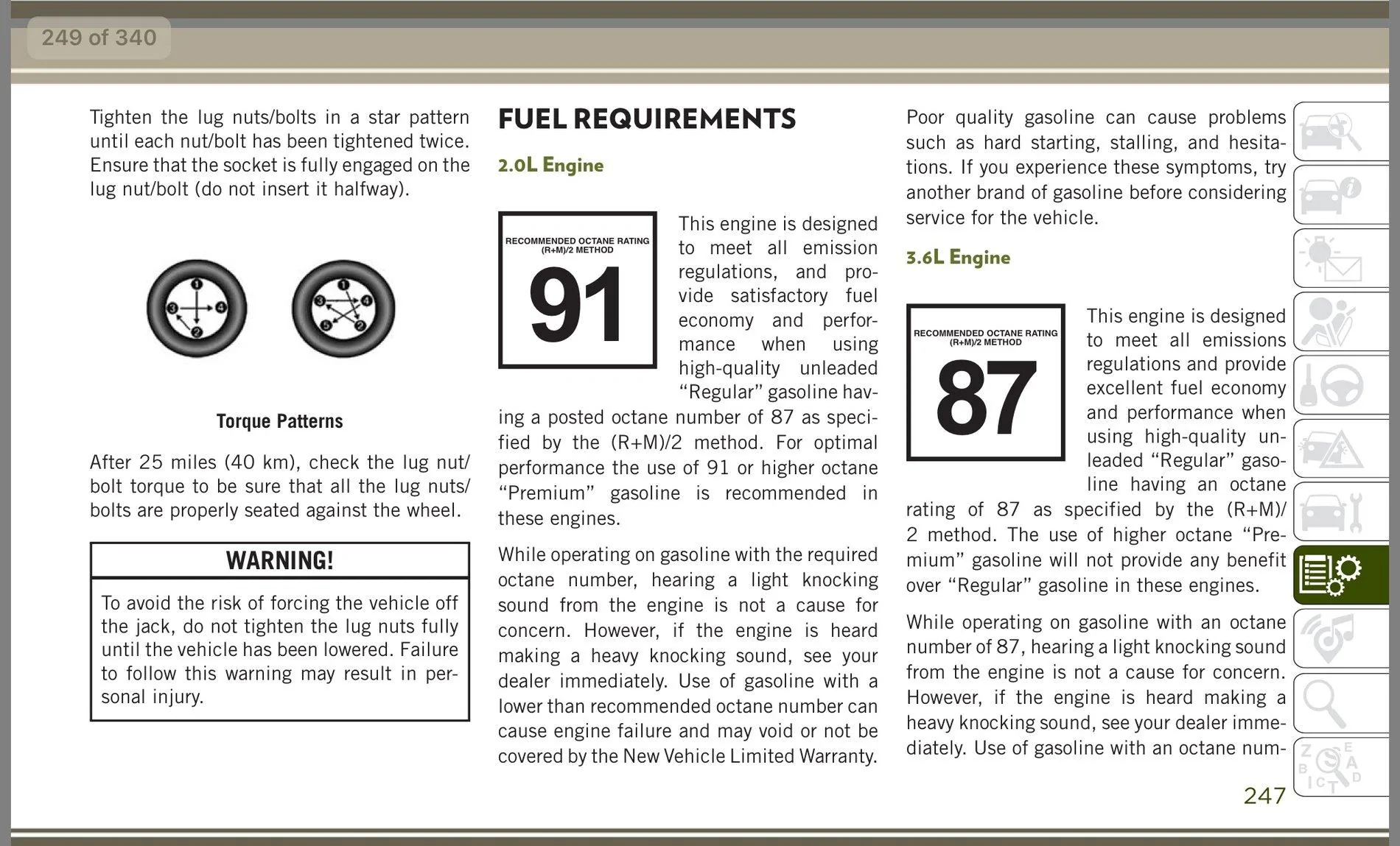

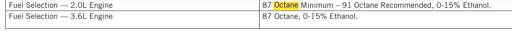

Please feel free to check my math but I think the 3.6L Auto is actually still the more efficient engine over the 2.0L...
So based on my local gas station (Lewisville, TX) it’s
$2.23 for 87 Octane (What the 3.6L needs) and
$2.89 for 91 Octane (What the 2.0L needs)
Let’s say we use 20 gallons of the 21.5 gallon tank that the 4 door has.
3.6L: 20 gallons X $2.23 = $44.60 per tank refill
2.0L: 20 gallons X $2.89 = $57.80 per tank refill
Well the 2.0L gets better gas mileage you say (Which it does)….
3.6L: 18/23 = 20.5 mpg avg
2.0L: 21/24 = 22.5 mpg avg
So how many miles does each engine get you?
3.6L: 20.5 mpg X 20 gal = 410 miles
2.0L: 22.5 mpg X 20 gal = 450 miles
So basically you get 40 miles more for $13.20 more. If you fill up every 2 weeks that’s 26 fill ups in a year. It will ultimately give you 1,040 more miles but also cost you about $343.20 (gas prices will fluctuate as well) more a year to drive the 2.0L over the V6. I love the idea of all that the 2.0L has to offer but when you factor in all of the things that could break on the 2.0L Turbo (Mild Hybrid) I’m starting to lean back towards the proven V6. What are y'all thinking?
P.S. I'm excited to get my first Wrangler in the spring/summer!
I was going with turbo really excited but a lot more can go wrong you can’t go wrong with V6 has lots of balls and will last for 20 years . Turbo we don’t know . So winner is V6
