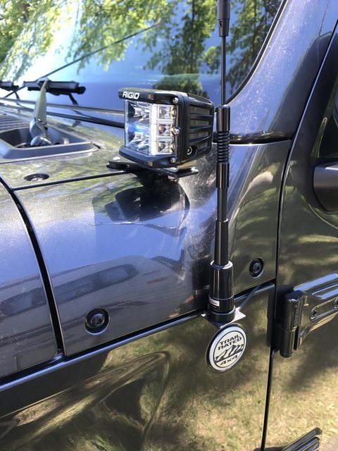

If I were you, I'd mount the antenna on the side of the hood...which is where I have mounted mine on my Ford. The hood can act as a bit of a reflector for your signal however; since you are talking about 2m/70cm, you're normally just accessing repeaters in the local area. I plan to mount an antenna on my JLUR in roughly the same location as my truck once I get around to purchasing a new radio and antenna for it. In the mean time, you really shouldn't have a problem with signal propagation. Most of the repeaters/repeater antennas in the Austin area are at considerable height and are easy to hit and/or "kerchunk" via "line of sight". Just an FYI -- I can hit one of the Austin repeaters from the rest area on I-35 that is just south of Salado. I'd be more concerned if you are wanting to do HF communications.
