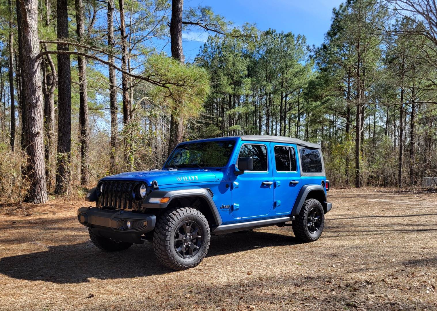

Hey all,
New to me 21 JLU pavement princess that will occasionally pull her hair up and explore the fire service roads. I would like to put a little lift and tire upgrade on it just to standout from the stock beach jeeps all over the Eastern North Carolina coast. Has to mild with no regearing, additional suspension mods, or change o on stock ride feel so my wife still feels very comfortable driving it also. Shared 2nd vehicle for us both. After much reading in these forums i am thinking about teraflex 1.5 spacers and 34 x 11.5 (or metric equivalent) on stock rims. What do you think? And if I do that package does the Willy's need the bumpstops that the sport package does? Willys has sport springs and fenders but ruby red shocks? Thinking it won't need shock brackets???

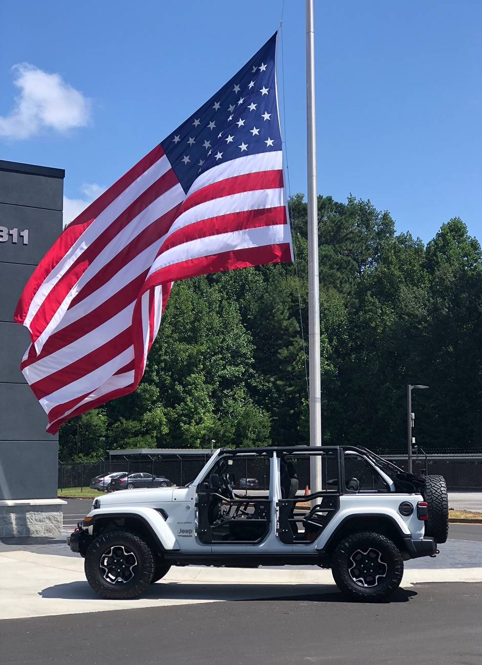

@The Last Cowboy is spot on. I ran the same combo on my Sahara several years ago . . . . TF 1.5 spacer, 34’s, stock/Rubi wheels, etc. I can’t comment on your Rubi shocks, but I know the shorter Sahara shocks were overextended and rode like crap IMO. I added some longer shocks and have been happy since. I’m still on the original bump stops without issue, but I did add some Rubi fenders. I’ve swapped out stuff since, but here’s an old pic appropriate for the upcoming holiday . . .

@6th Floor Mule your ride looks awesome. Just to be clear, that pic is 34s on the TF lift and all else stock?
