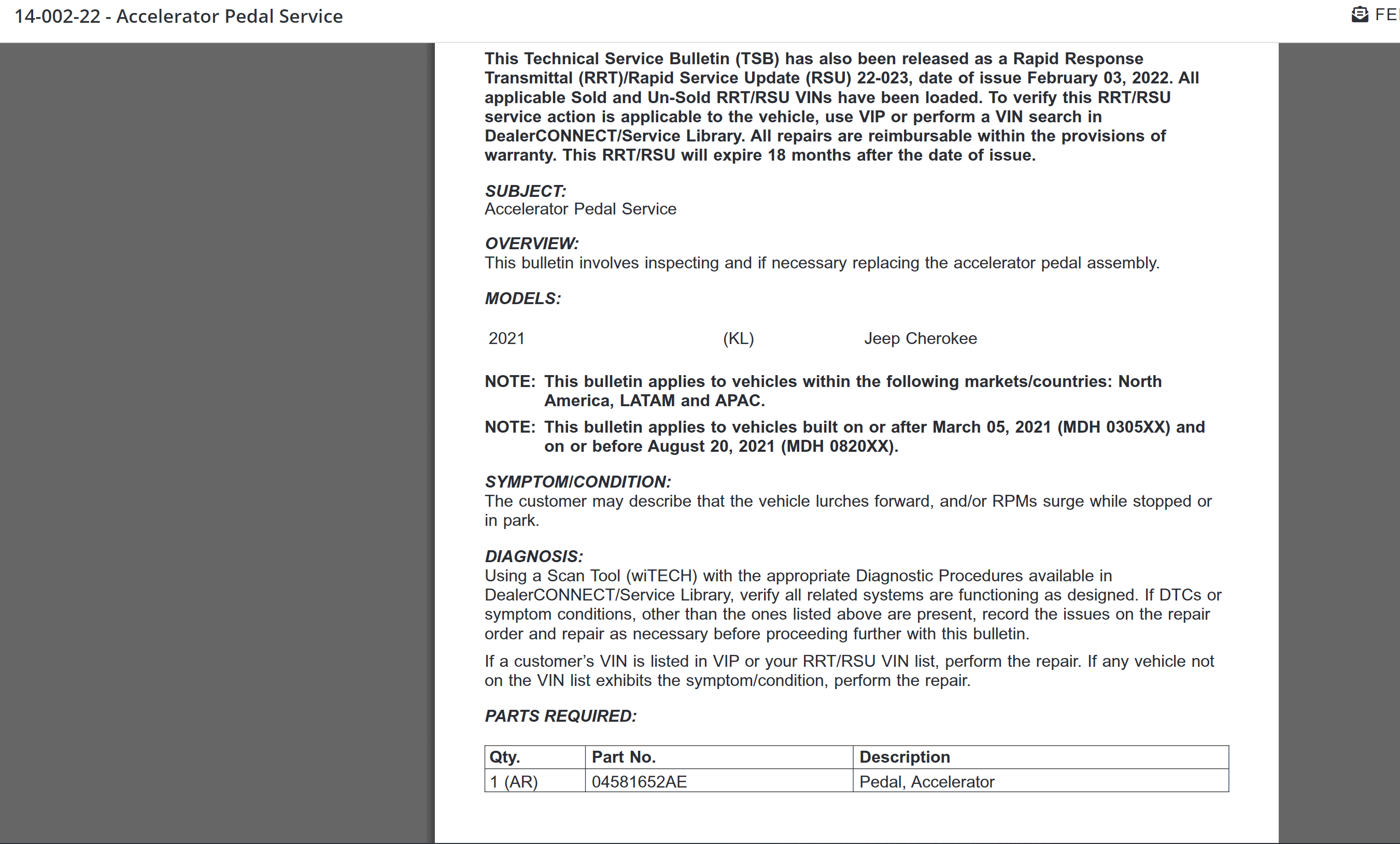

You're actually in luck, there's a TSB on this exact problem. It involves replacing the accelerator pedal. Tell your dealership to lookup TSB 14-002-22. Looks like it is indeed a case of poorly calibrated APP sensors. Explains why you're not getting a code, too.

I got a voicemail message from the service manager last night. He said that TSB 14-002-22 may be spot on. They are going to check that and let me know. Thanks again.

Update: It appears that this was the fix. We have not had the problem ever since. 3 dealerships could not figure out the problem/solution, but you did. Thanks so much!
