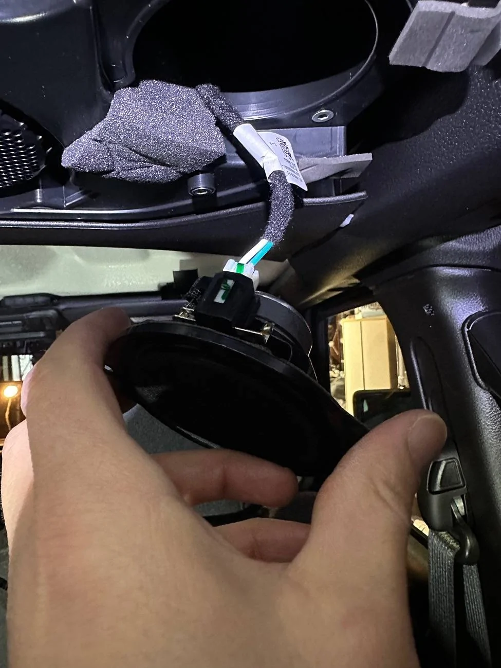

Good morning,
Has anyone attempted tapping into the soundbar/rear speaker wires in the B-Pillar for aftermarket audio amps in a 2024 yet? Do we know if the braided speaker wires are the same color as 18-23? The reason I ask this is due to the new updated radio in the 24's. Looking for responses from someone who has actually tapped into the wires in a 2024 and not hearsay from what you may have read across the internet. If I can't get definite proof, i'll likely pull the sound bar and confirm, but i rather not disassemble things if i don't have to. Thanks in advance!

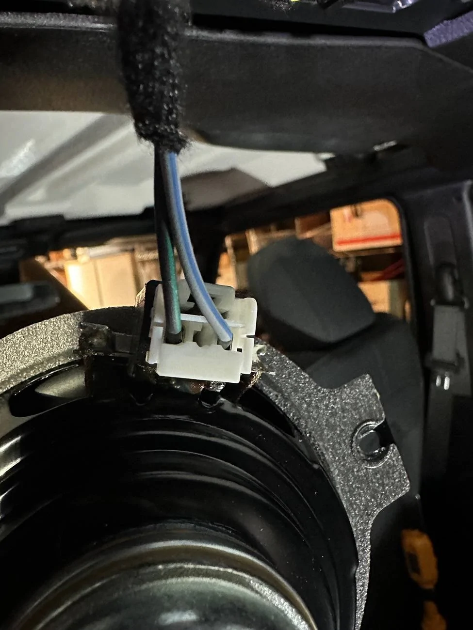

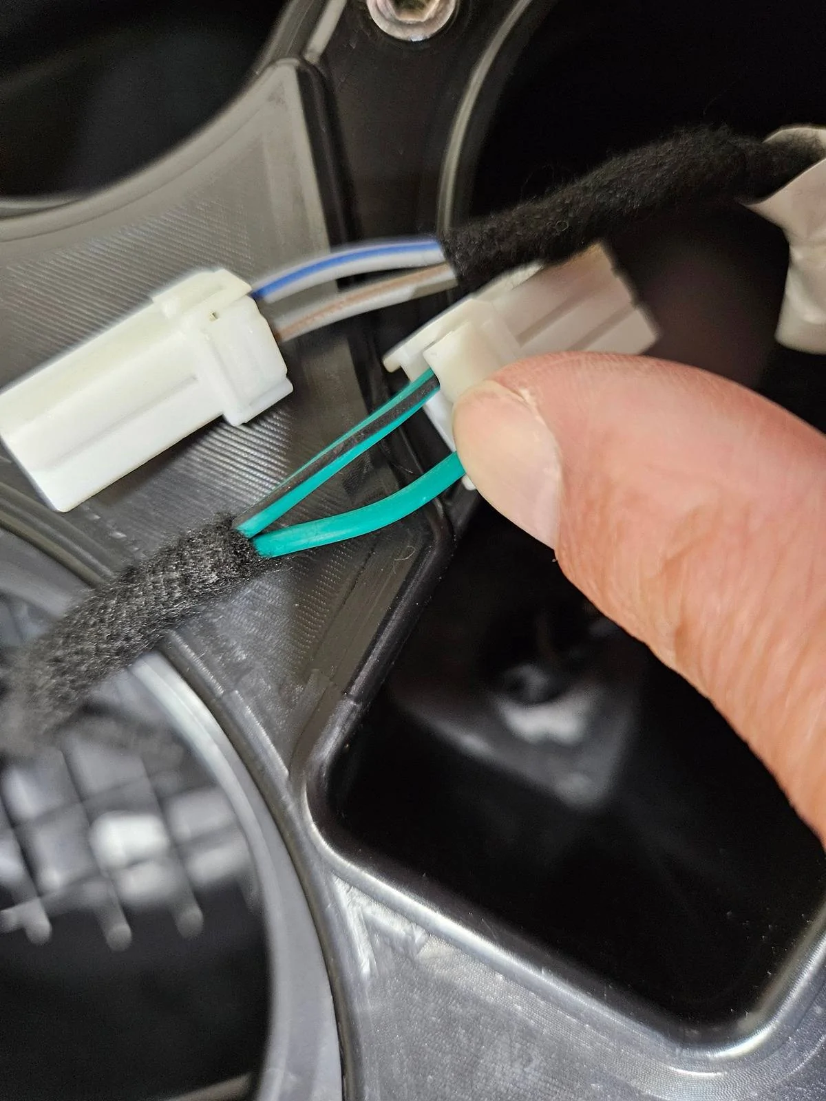

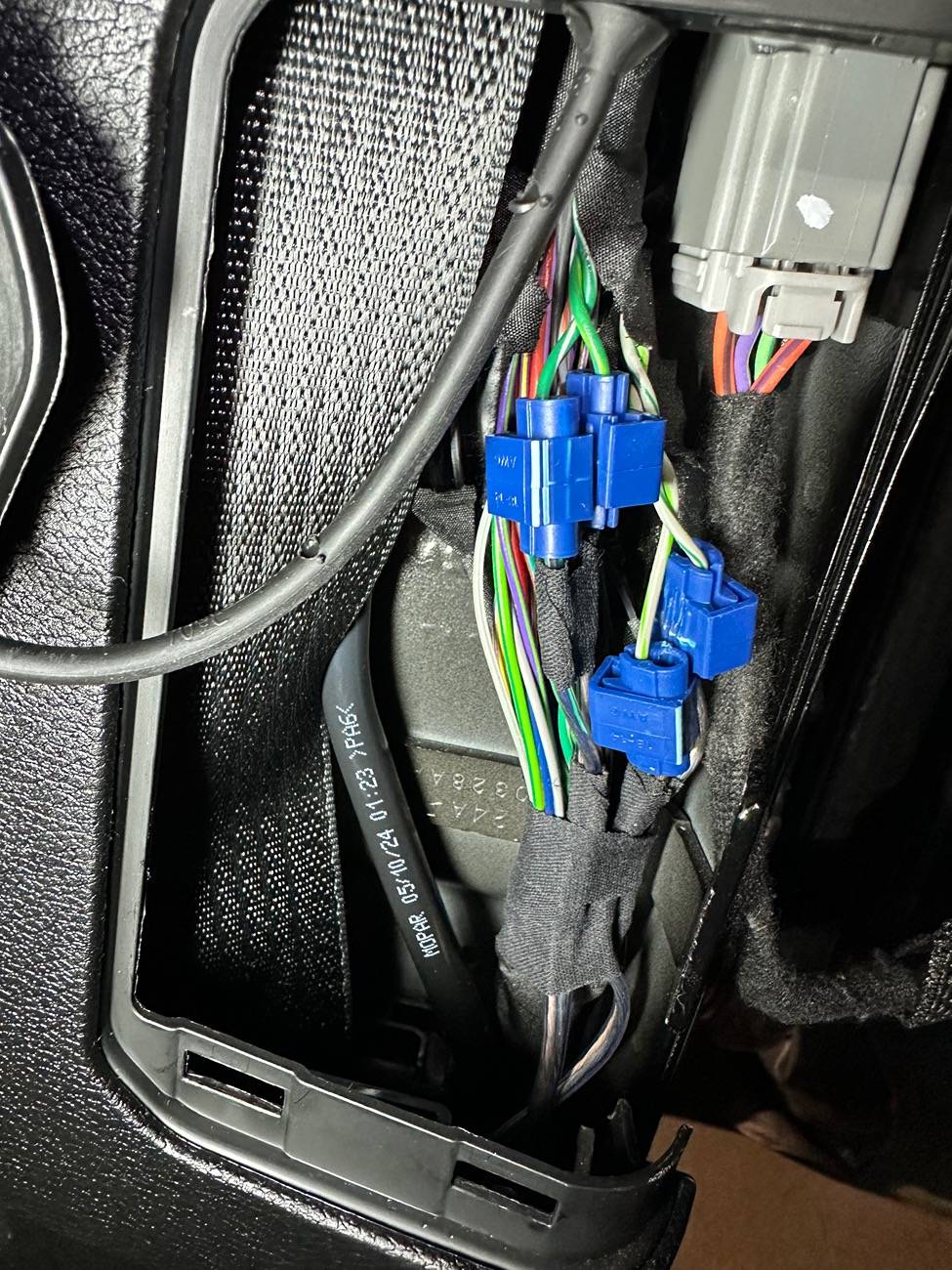

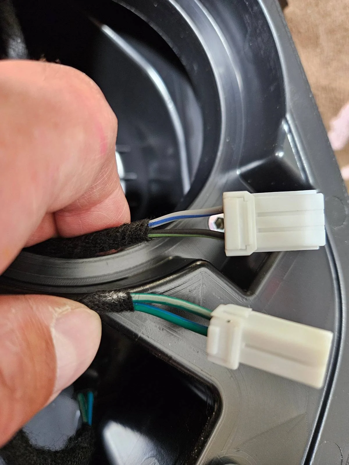

New here to the forum.
I just tapped into the b-pillar speaker wires for a small powered sub under my seat. I have a 2024 Willys with base audio.
The speaker wires coming off of of the speakers don't match the wiring scheme in the pillar. They must split at some point. Seems to be the same as the 2023 wiring diagram for the b-pillar.
https://www.jlwranglerforums.com/forum/threads/jeep-jl-wrangler-wiring-diagrams.19185/
No issues with the install, ill probably go back and solder the tapped wires at some point. Not saying what I have is correct, but just how I did it. Cheers hope this helps.
Left rear

Right rear
Jeep Wrangler JL 2024 B Pillar Speaker Wire Colors IMG_8170
B-Pilar tapped wires
Jeep Wrangler JL 2024 B Pillar Speaker Wire Colors IMG_8177
