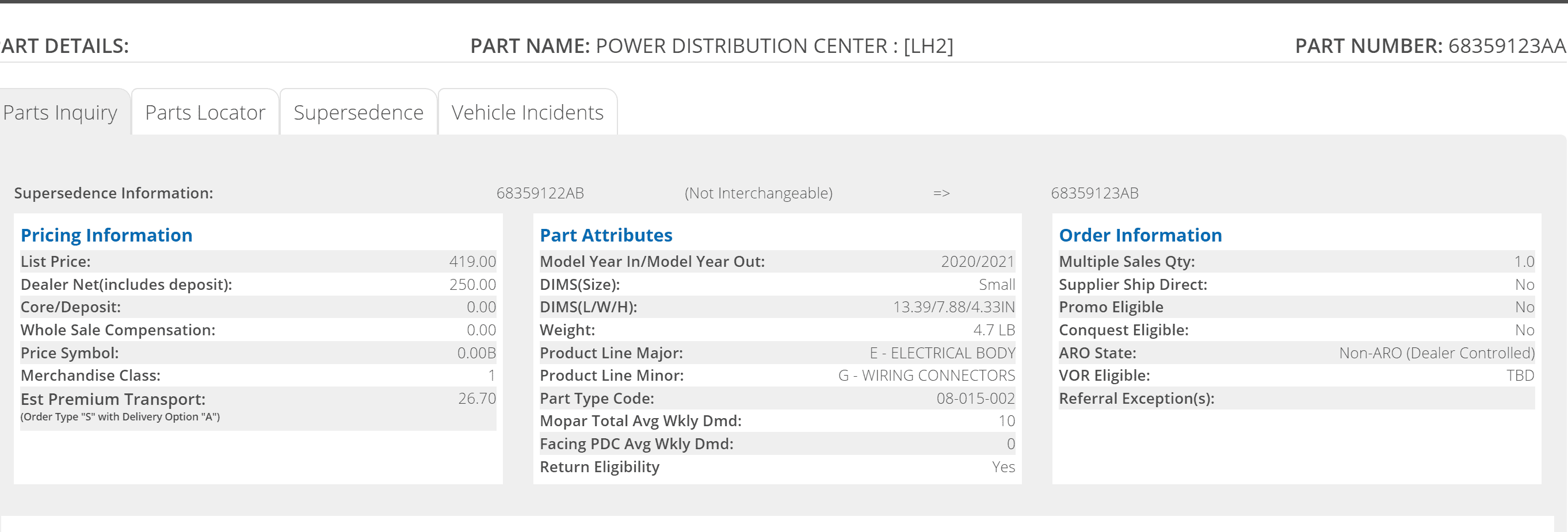

ckmarble
Aug 25, 2023
Utah
2020 Jeep Gladiator Rubicon
MSRP 419 dealer cost is 250. You're getting fucked in the A and it isn't even Saturday.
Not surprised, I hate my local dealer. If I do find out it's the PDC I'll shop it out.
