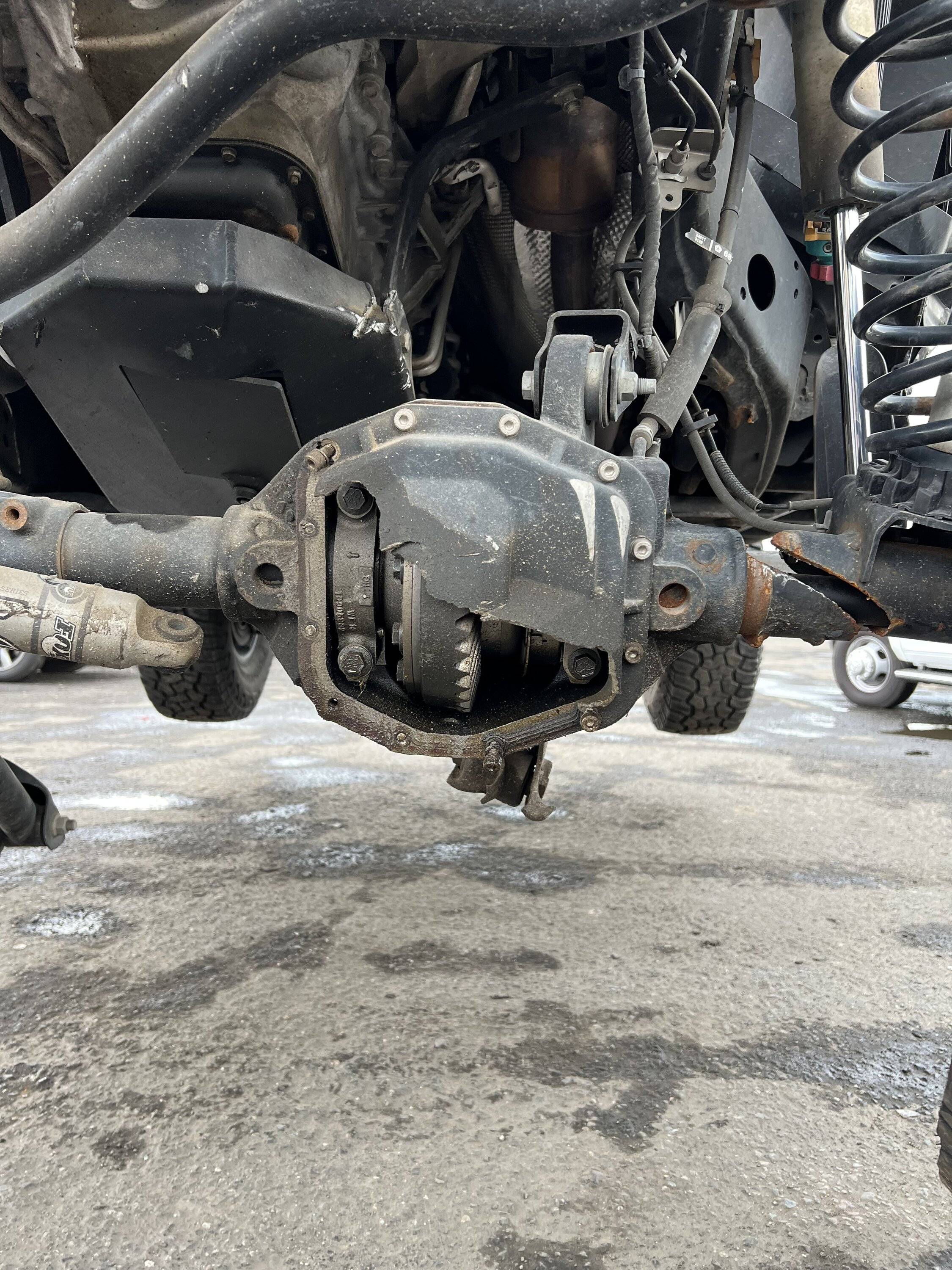

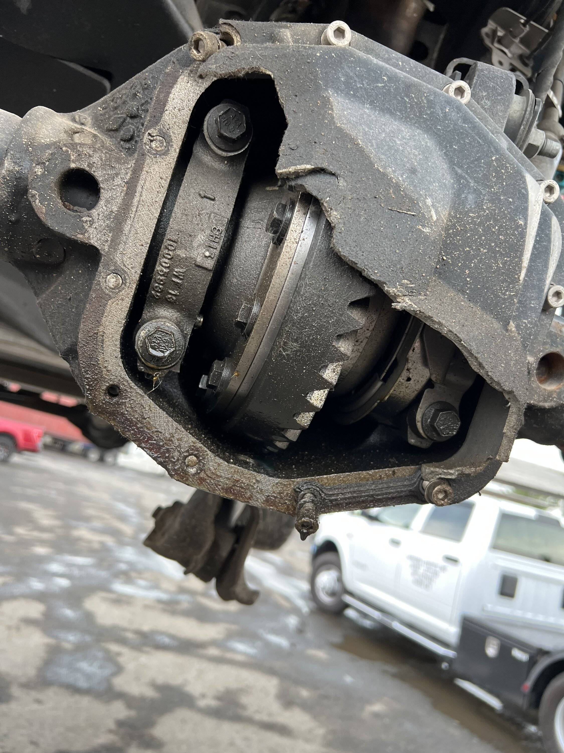

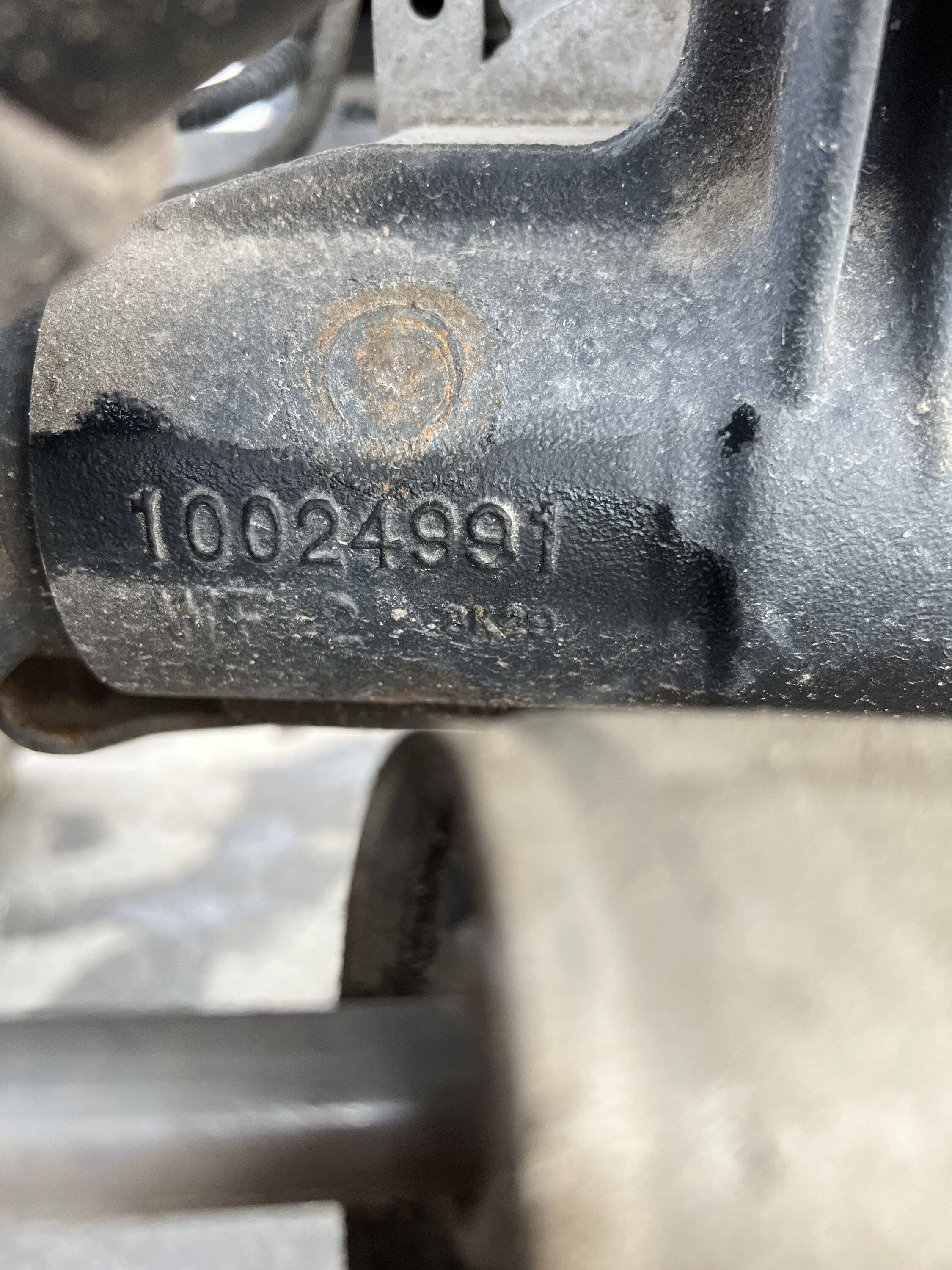

Hello guys. I bought 2019 damaged Rubicon and I know it has Dana 44 but I dot not know what ratio it has or if it’s M210 or M186 and how can I found out? Also I don’t know if previous owner made any upgrade inner axles. One I know it has 37 inch wheels and rear axle is AFE powered. I know inner axles is not damaged and wondering how much is gonna cost to by front axle Dana 44

Standard is dana 44 1:4.10 gear ratio. Easiest for me would be to connect OBD dongle/ phone with JScan app and read what the actual gear ratio is. 37" tires, diff cover and steering damper are not stock, so its possible a previous owner did a regear.
I bought a Rubicon front axle for $1k and new rubicon crate axle were about 2.5k some time ago. As far as I understand, a lot of front axles are on back order now so prices are most likely higher. Try 77072405 part number. If you get lucky you might find a leftover rubicon front axle for a reasonable price.

I would just buy another axle. If you count the ring gears and divide the number gears on the pinon will give you the ratio.
My best guess is 4.10 or 4.11
