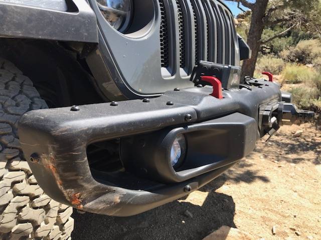

Second mod was hitting a tree and denting the front bumper end cap. I didn't mind too much since they were coming off anyway, but I also bent the bumper slightly. I tried installing a Mopar winch guard but the bolt holes wouldn't line up with the bent bumper.

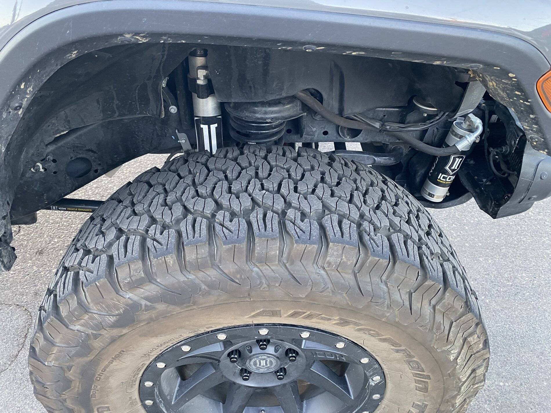

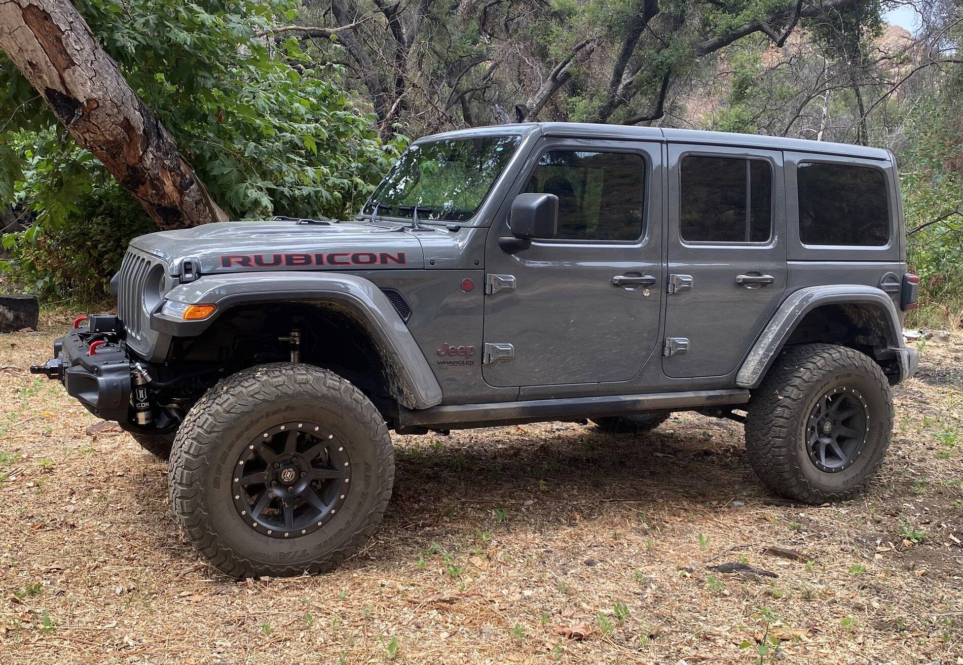

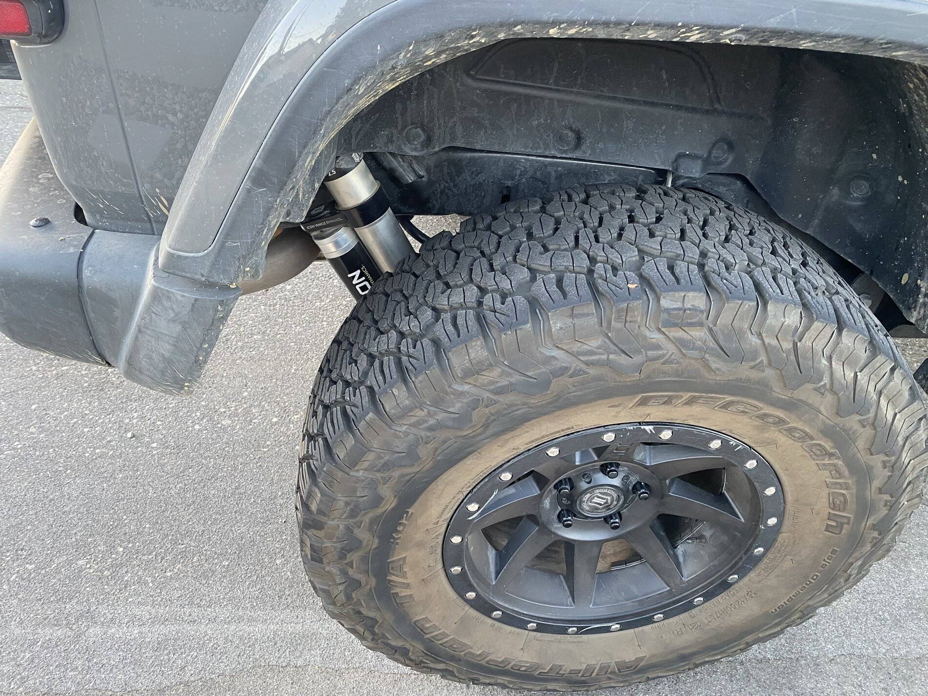

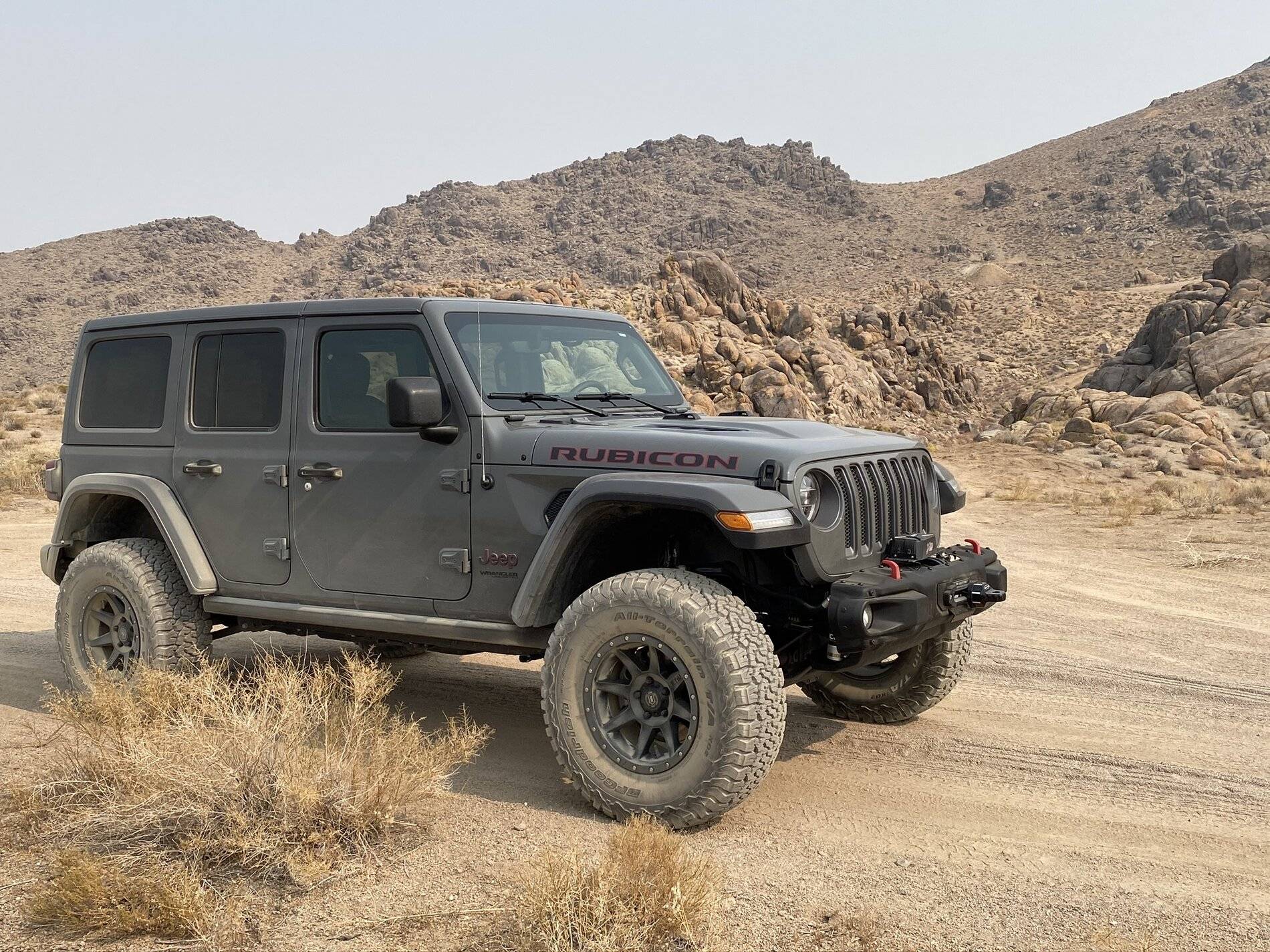

Next was the lift, tires and wheels, tire carrier, and Flashcal F5 Programmer. I went with the Icon Vehicle Dynamics Stage 5 2.5" lift with 2.5" reservoir shocks. A lot of my off roading is in desert areas so I wanted a shock that can handle the heat. I also went with Icon 17x8.5 Rebound wheels and KO2 35's. Before and after measurements showed that I actually gained about 4.5" of lift. I had a hard time deciding on AT or MT tires, but stuck with the KO2's since I have used them on most of my other trucks and they're snow rated. Plus I can always replace them with MT's once they wear down. Added a Smittybilt HD Pivot tire carrier to handle the heavier wheel.
I'm very happy with the Icon lift system and wheels. It handles great both on and off road. I've had a few "oh shit" moments going a little too fast in sand washes and hitting bumps and ruts, but this suspension just eats it up. Great on the rocks, too.

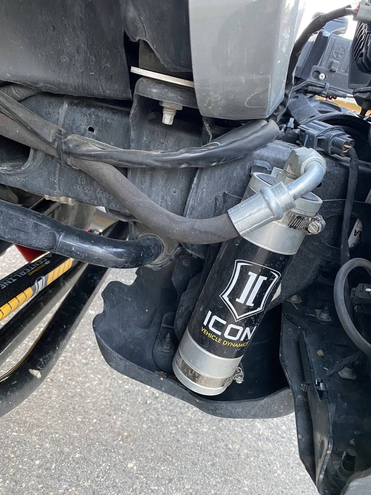

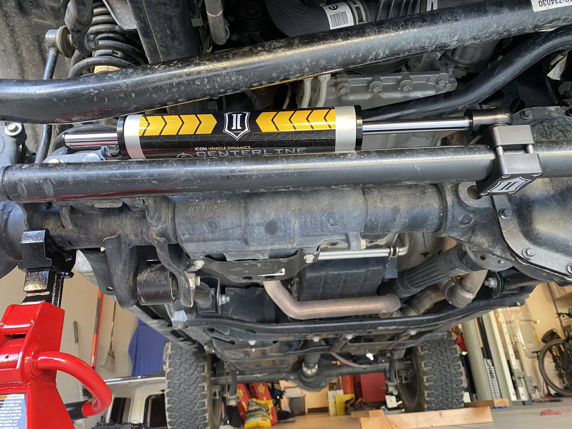

Added the Icon Centerline Steering Stabilizer.
Jeep Wrangler JL 2019 JLUR Icon Build IMG_0982
Jeep Wrangler JL 2019 JLUR Icon Build IMG_0983

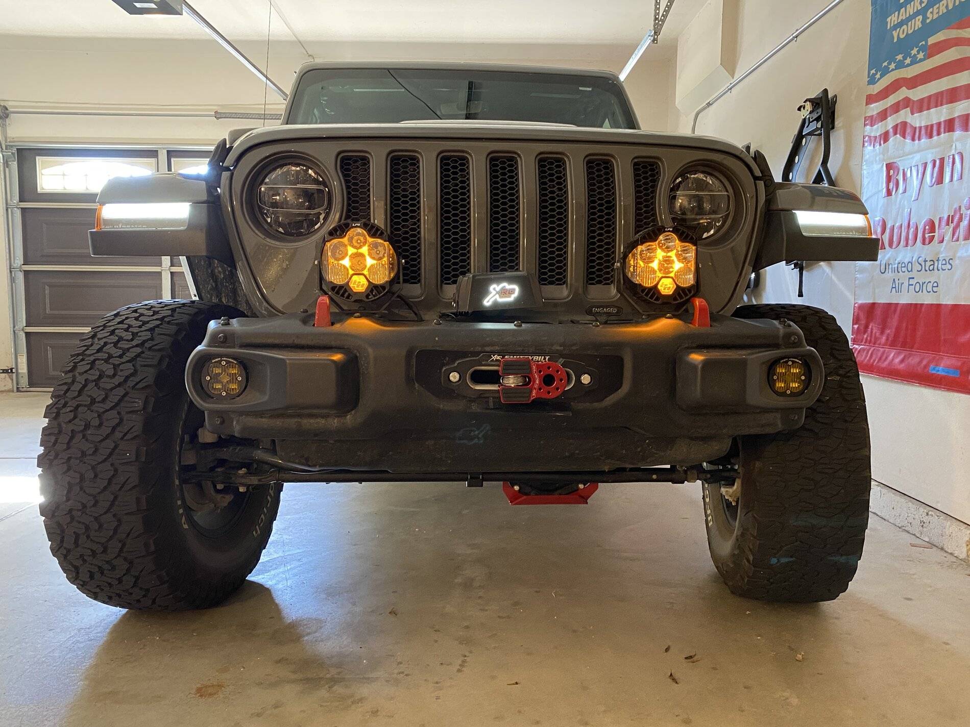

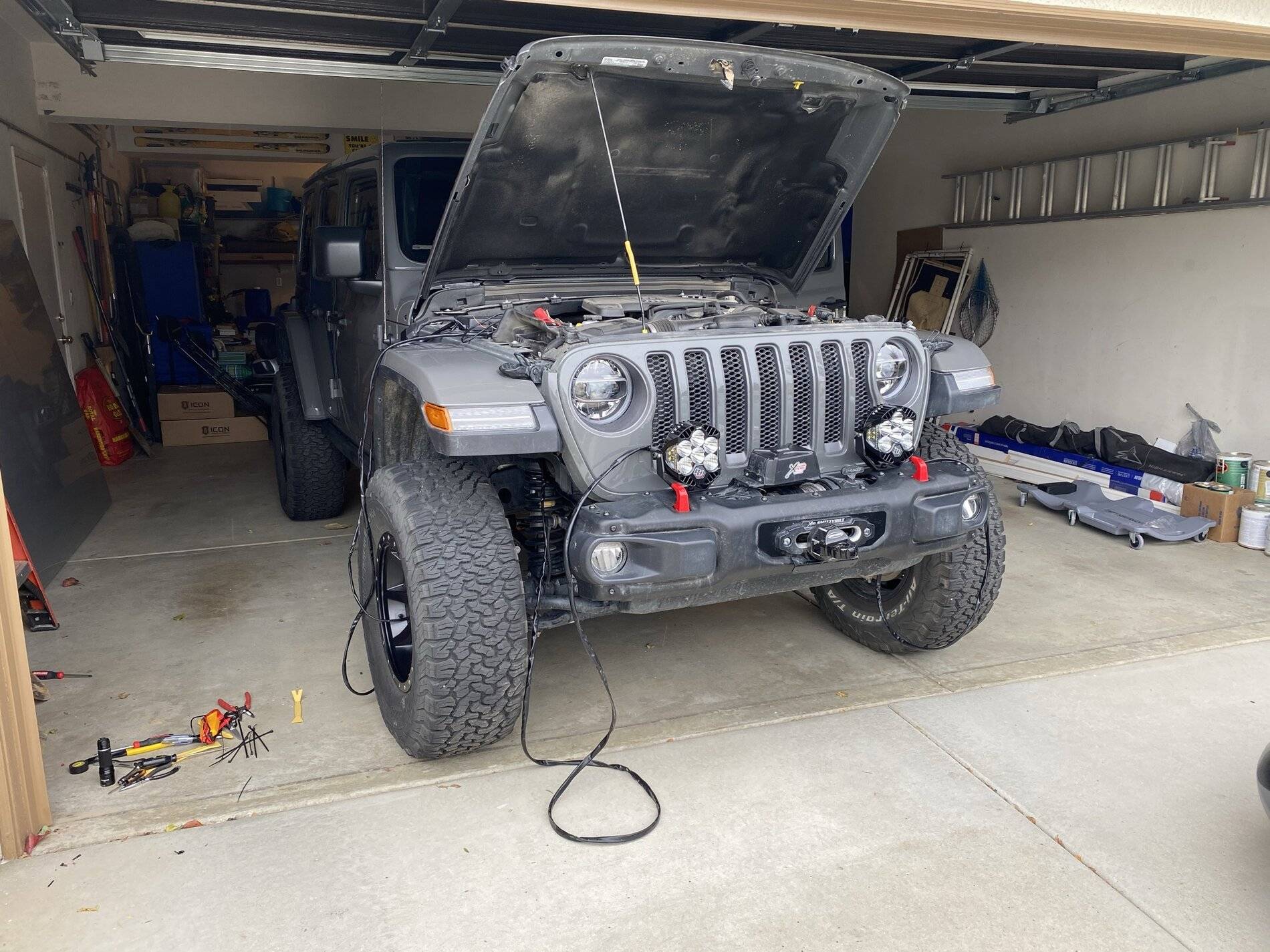

Lights:

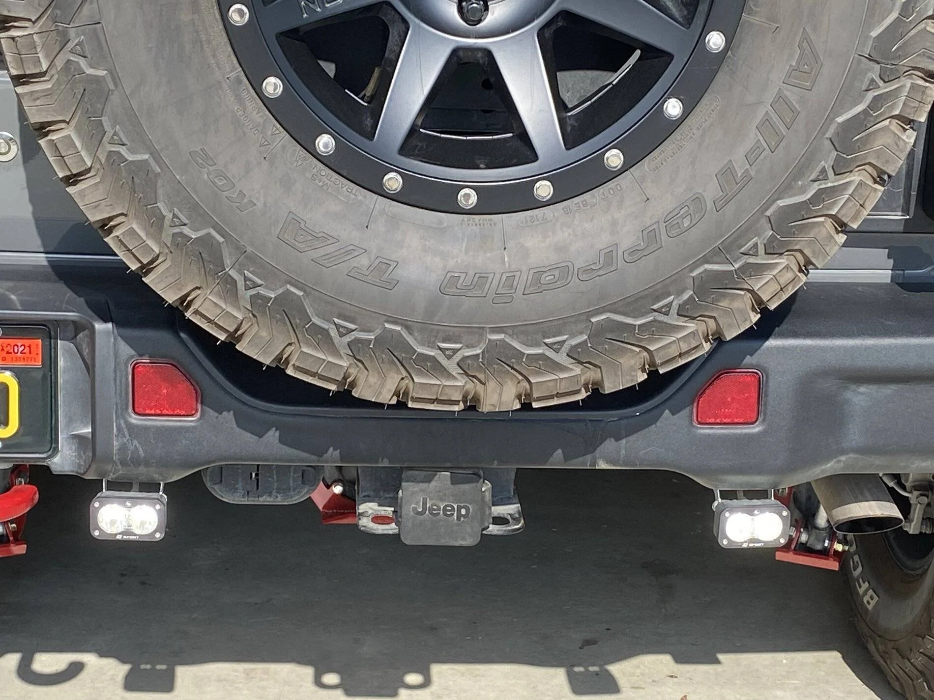

Went with the Baja Design LP6's up front using the upfitter lockout harness connected to the factory auxiliary switches. Swapped out the factory LED fog lights with a pair of BD Squadron-R amber lights. Finally, installed BD Reverse Kit Dual S2 Sports lights. The LP6's are so bright that I doubt I'll never need to add any additional lighting.
Jeep Wrangler JL 2019 JLUR Icon Build IMG_1125
Jeep Wrangler JL 2019 JLUR Icon Build IMG_1139
Jeep Wrangler JL 2019 JLUR Icon Build IMG_1140

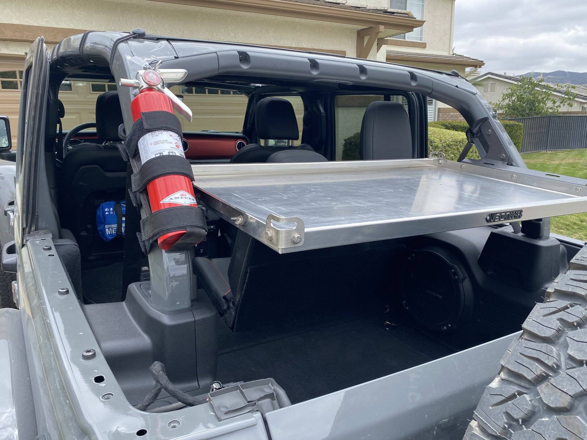

Added a Vector aluminum platform and cargo net to increase rear storage space. I can hold two Front Runner Wolf Pack boxes on it and still have room for my tent and other gear.
Jeep Wrangler JL 2019 JLUR Icon Build IMG_0990

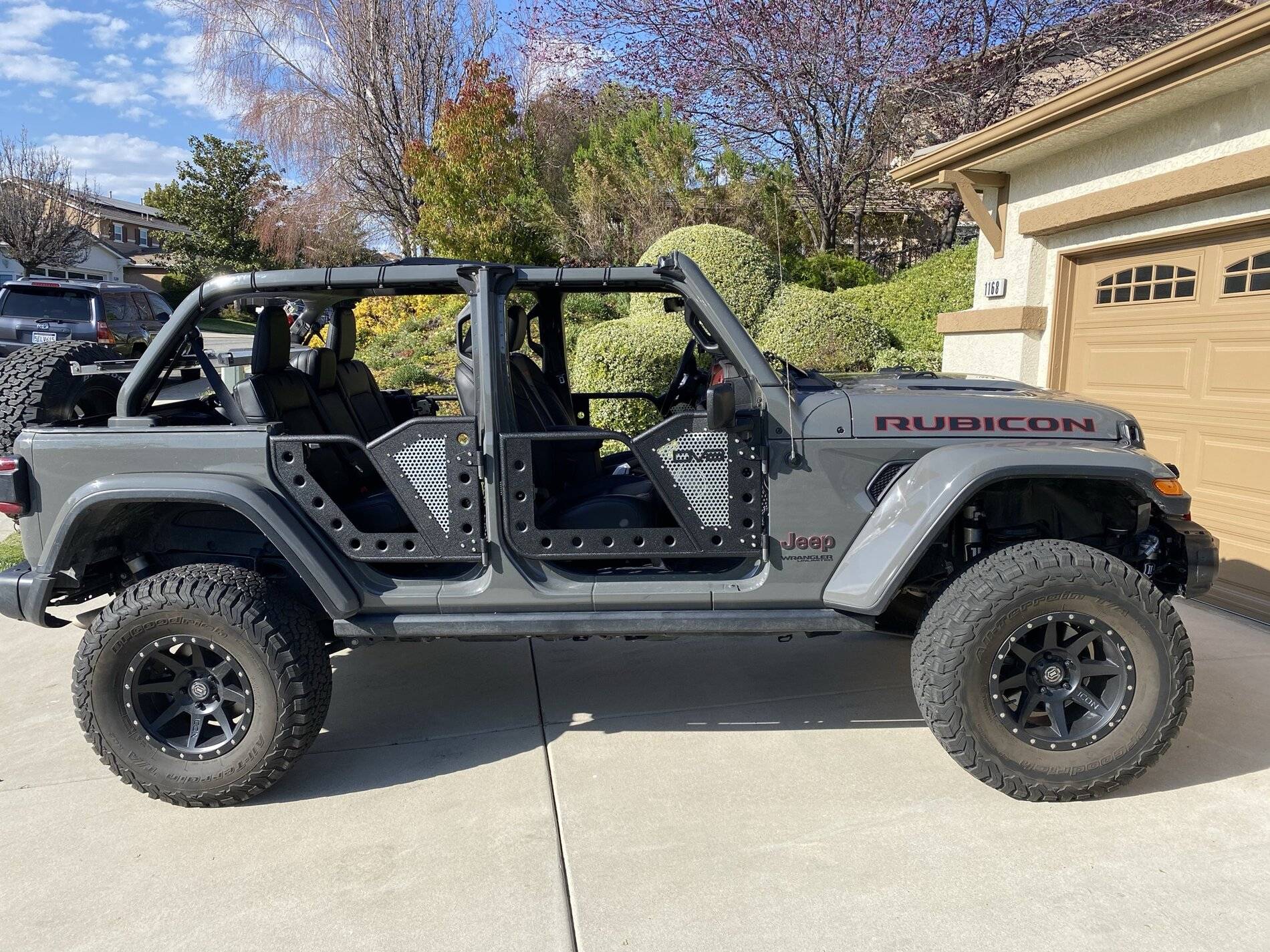

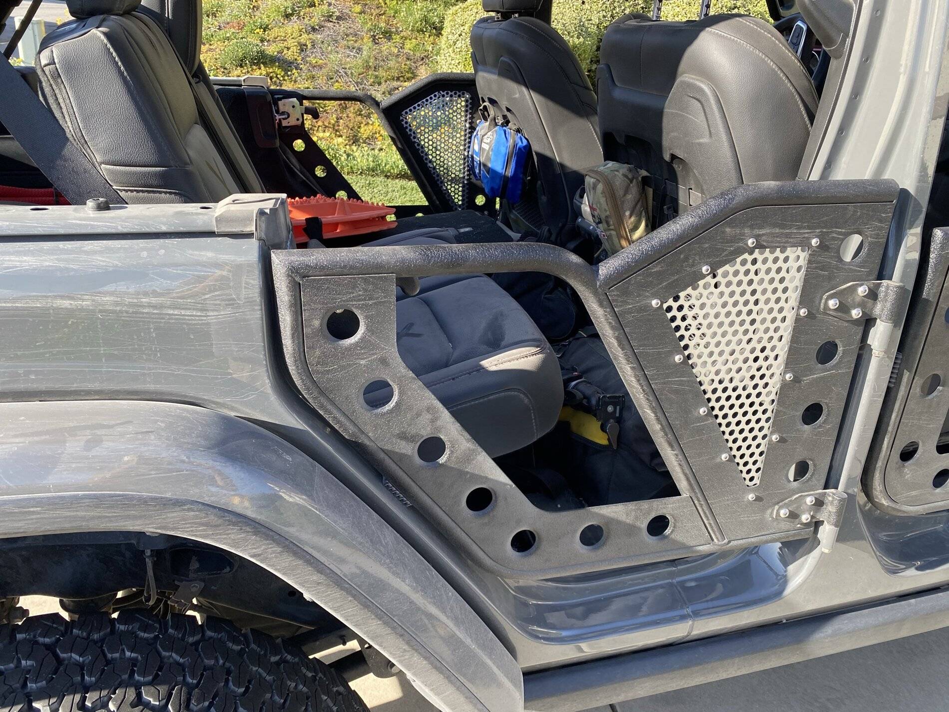

Next up, DV8 doors and SpiderWebShade.
Then took it out to get dirty.
Jeep Wrangler JL 2019 JLUR Icon Build IMG_0931

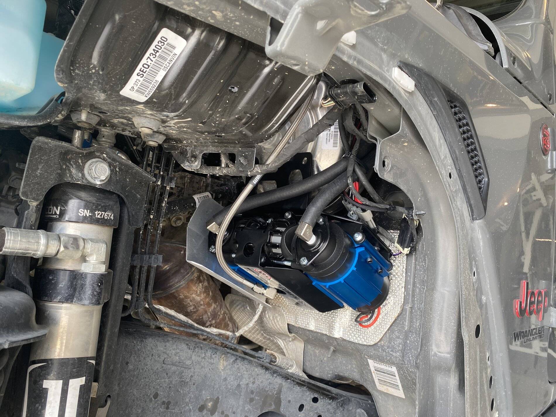

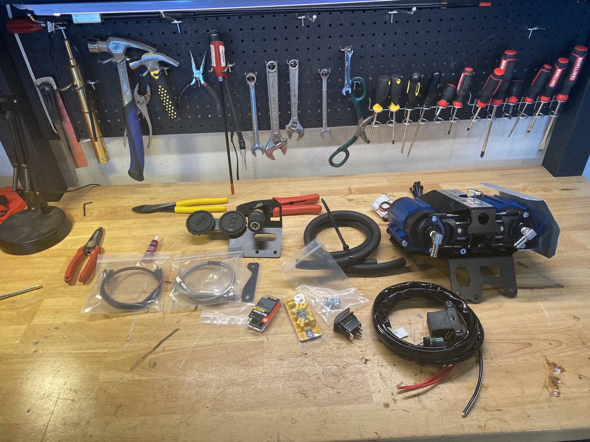

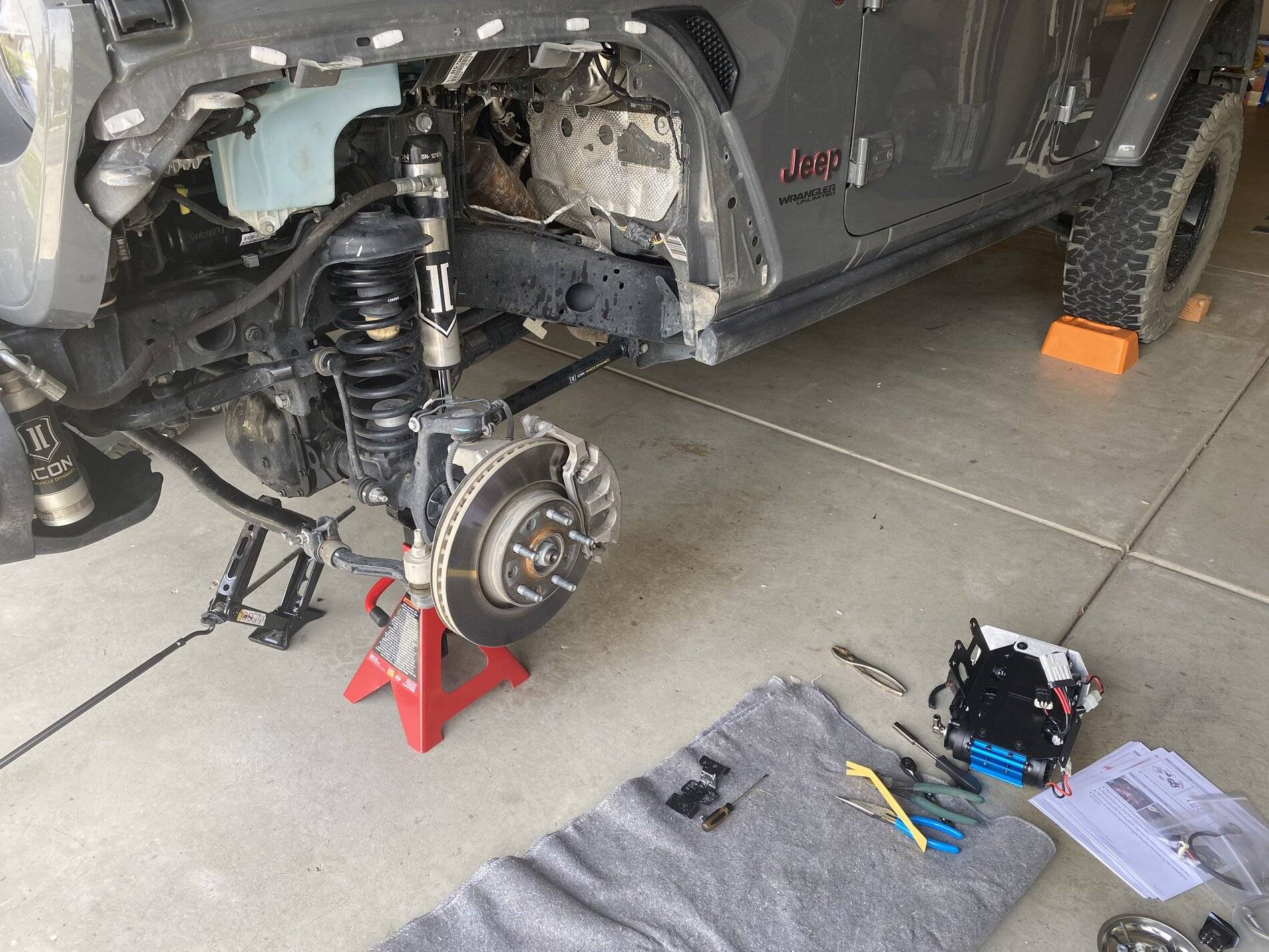

ARB Twin Compressor and Grimm Offroad Mount.
Jeep Wrangler JL 2019 JLUR Icon Build IMG_0970 (1)
Jeep Wrangler JL 2019 JLUR Icon Build IMG_0971
Jeep Wrangler JL 2019 JLUR Icon Build IMG_0972
Jeep Wrangler JL 2019 JLUR Icon Build IMG_0973

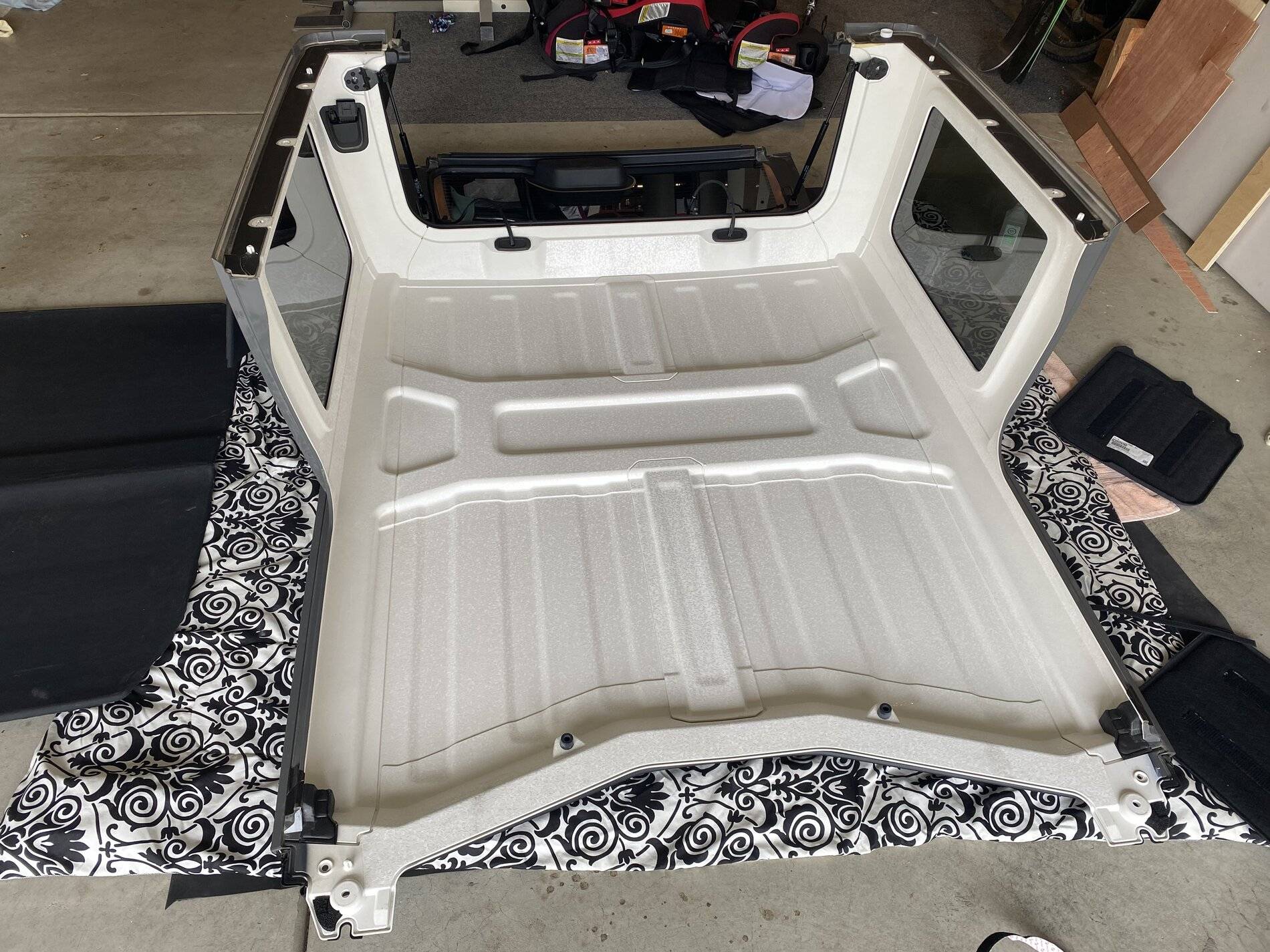

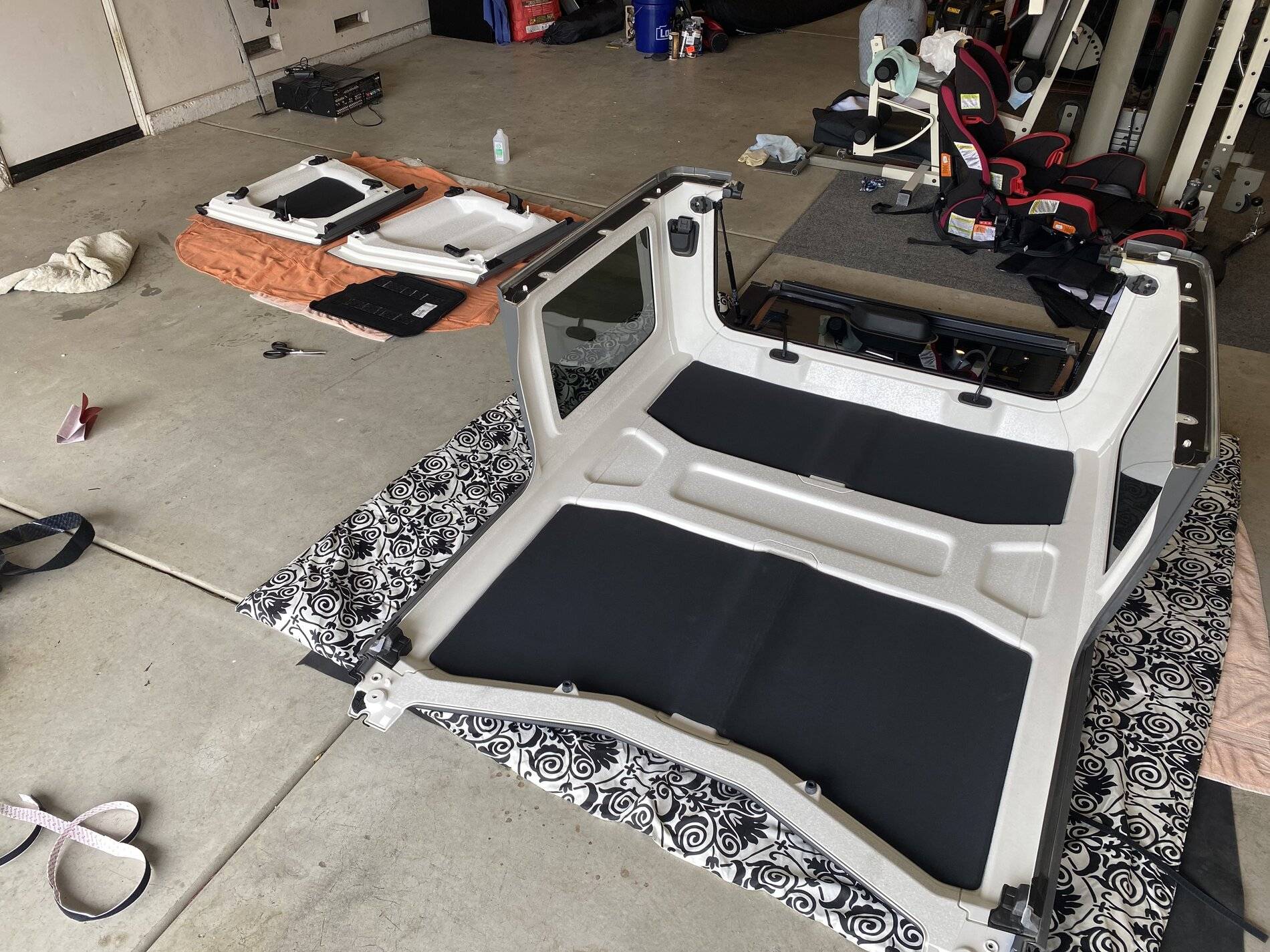

When I went to the body shop to get the rest of my stuff out of the totaled JLUR I also took the headlines and installed them in the new one.
Jeep Wrangler JL 2019 JLUR Icon Build IMG_0988
Jeep Wrangler JL 2019 JLUR Icon Build IMG_0989

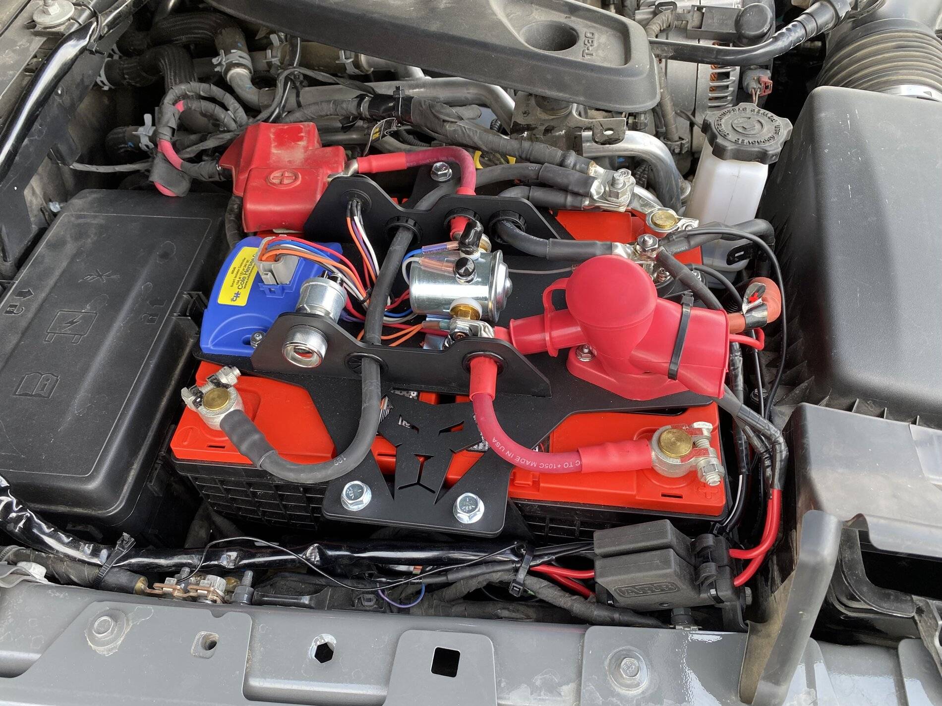

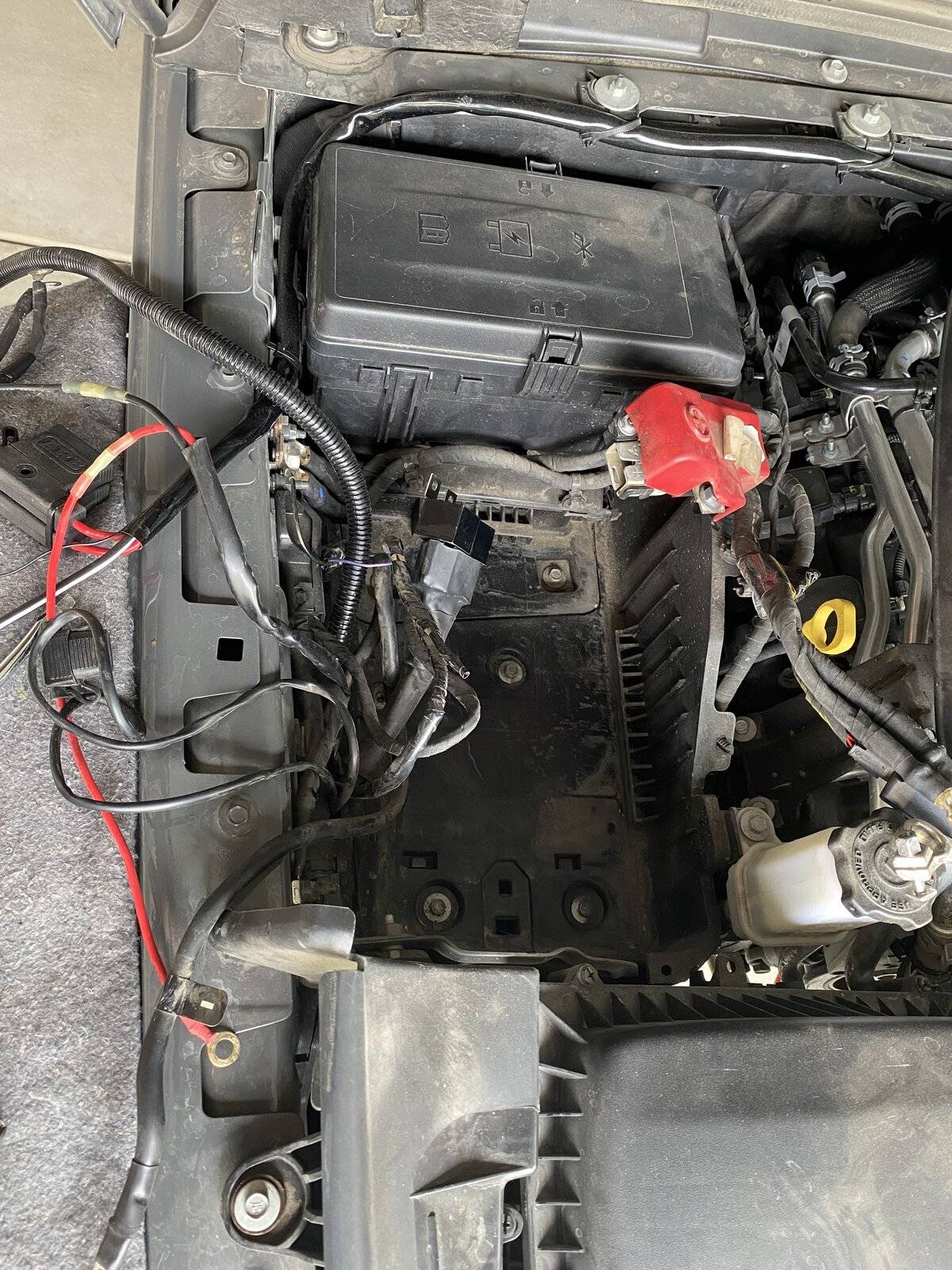

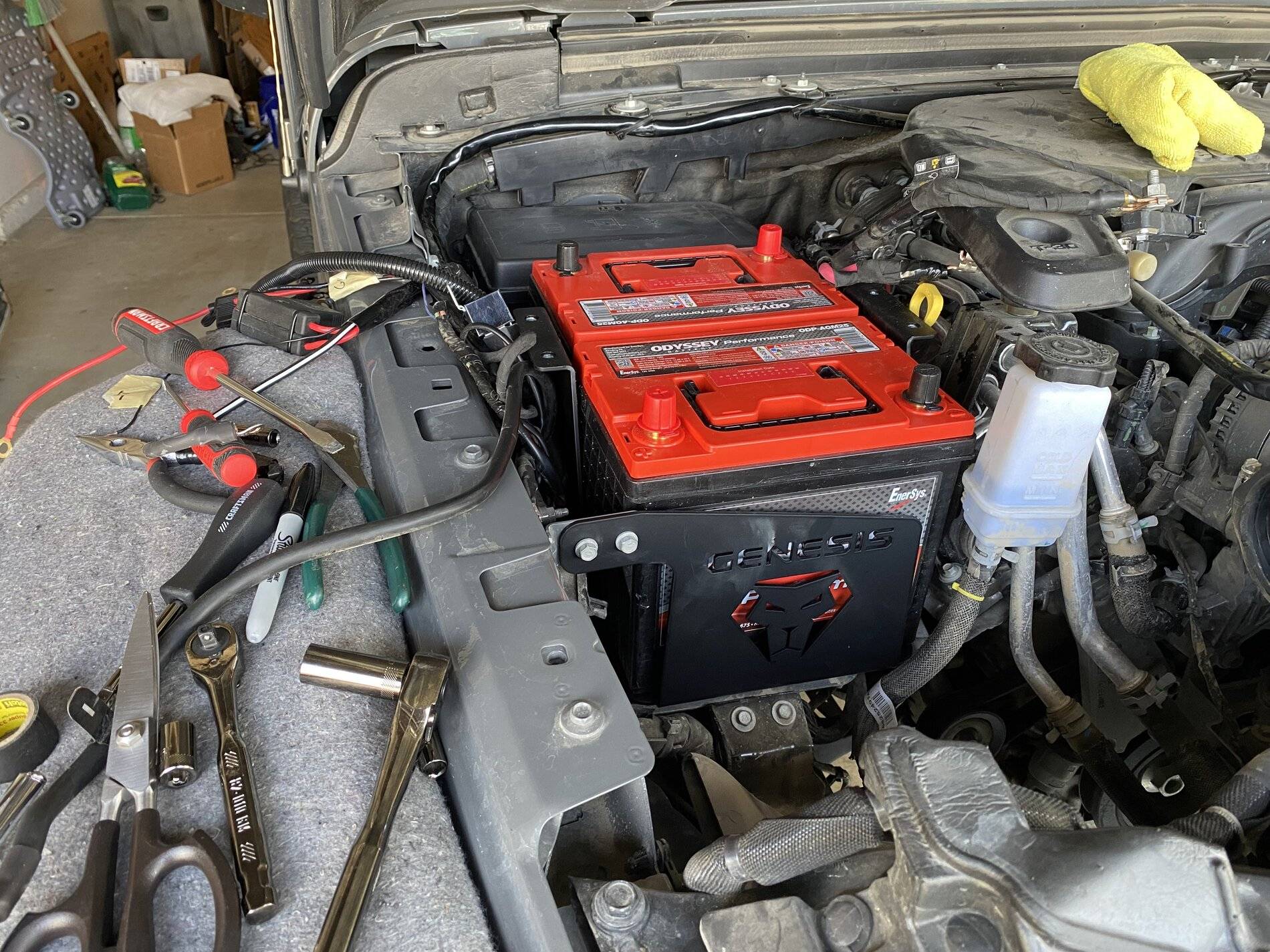

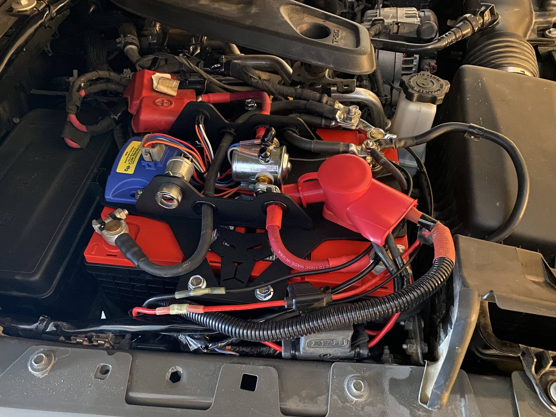

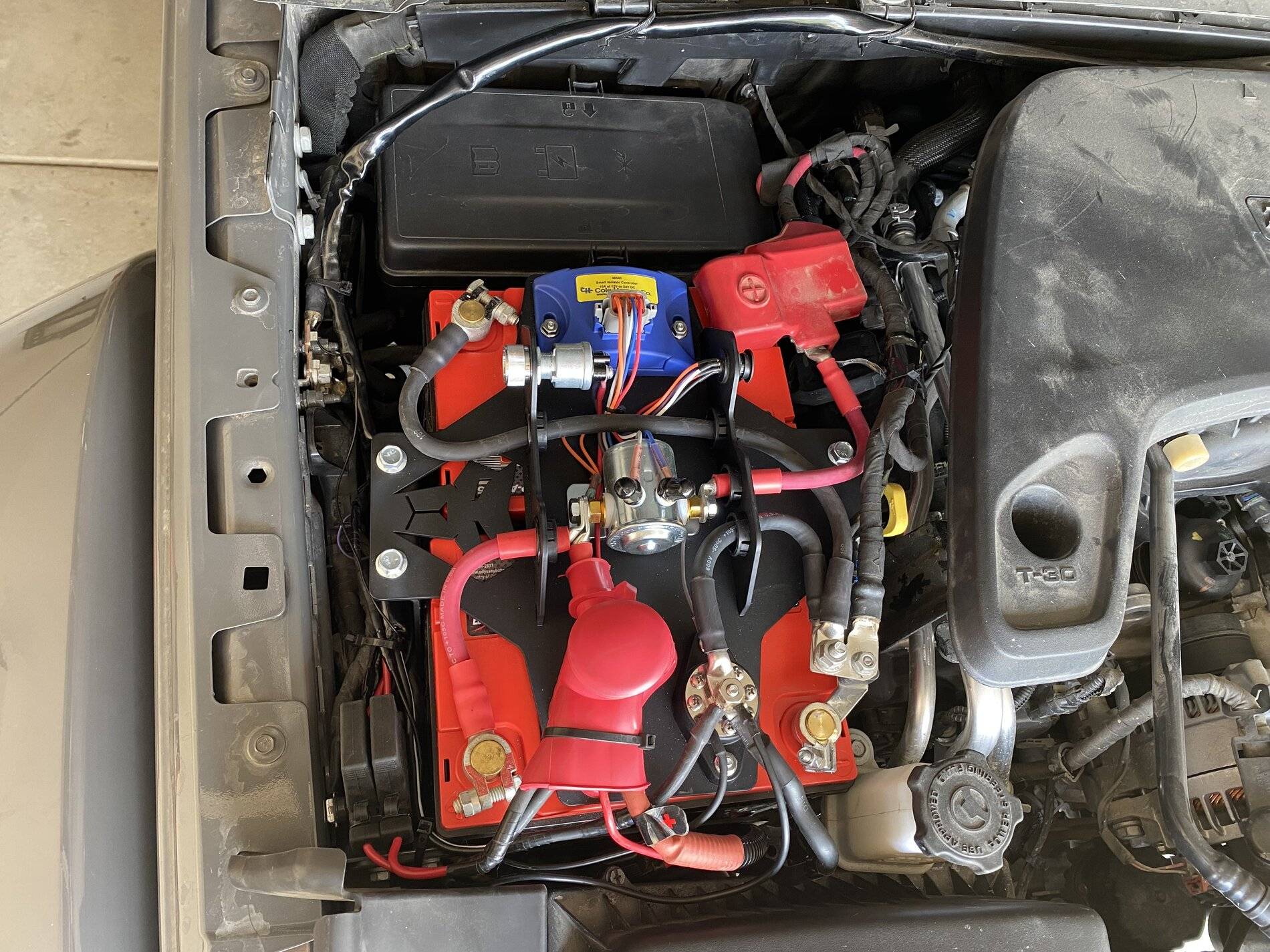

Installed the Genesis Dual Battery kit with two Odyssey batteries. The OEM auxiliary battery and high amp fuse failed twice in a five month period, leaving us stuck in busy intersections and needing a tow to the dealer. "Luckily" these failure happened close to home and not while off road in the middle of nowhere. After doing a lot of research, mostly on this forum, I decided to go with the Genesis system and do away with the OEM aux battery altogether. My winch, 2 BD LP6 lights, and ARB twin compressor are now connected to the Genesis bus bars and I may add a frig in the future. The install was a bit intimidating since I haven't done anything like this before. The Genesis install video does a great job explaining the process, but it still took me a good 3 to 4 hours.
Jeep Wrangler JL 2019 JLUR Icon Build IMG_1144
Jeep Wrangler JL 2019 JLUR Icon Build IMG_1145
Jeep Wrangler JL 2019 JLUR Icon Build IMG_1146
Jeep Wrangler JL 2019 JLUR Icon Build IMG_1147
Jeep Wrangler JL 2019 JLUR Icon Build IMG_1149
I went back and cleaned up the wiring after the initial installation.
Jeep Wrangler JL 2019 JLUR Icon Build IMG_1153
Jeep Wrangler JL 2019 JLUR Icon Build IMG_1164

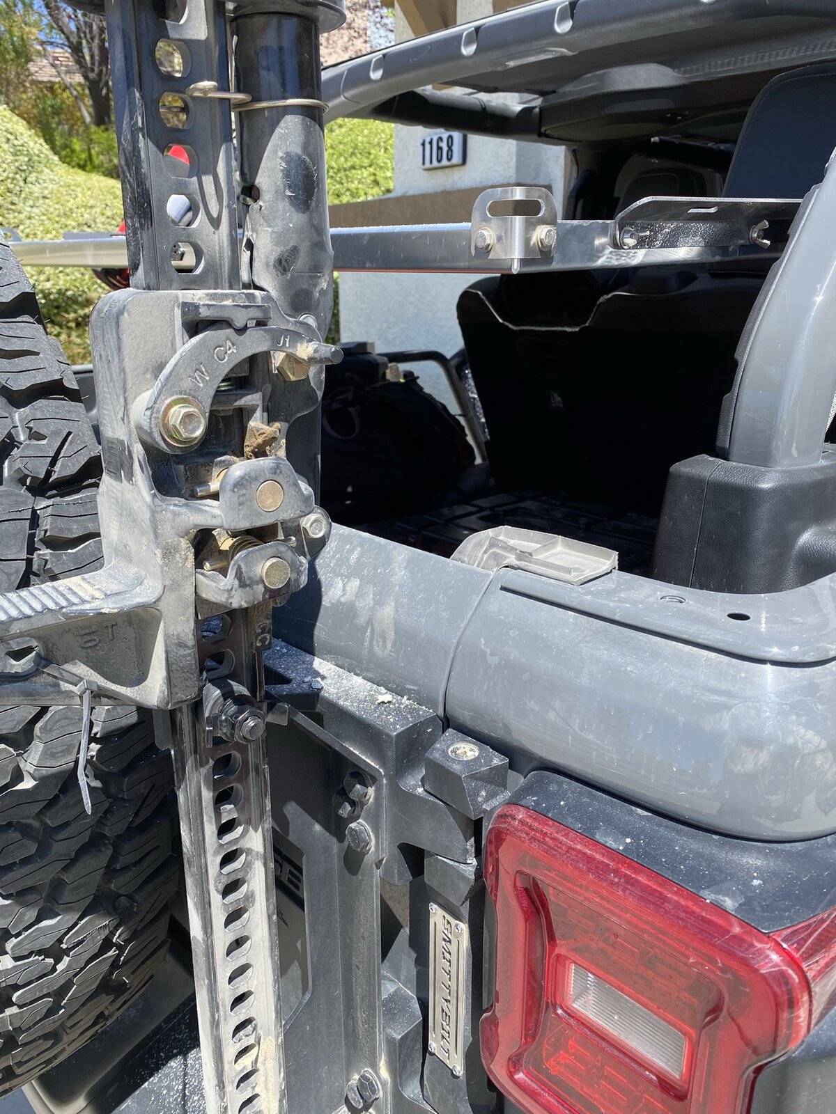

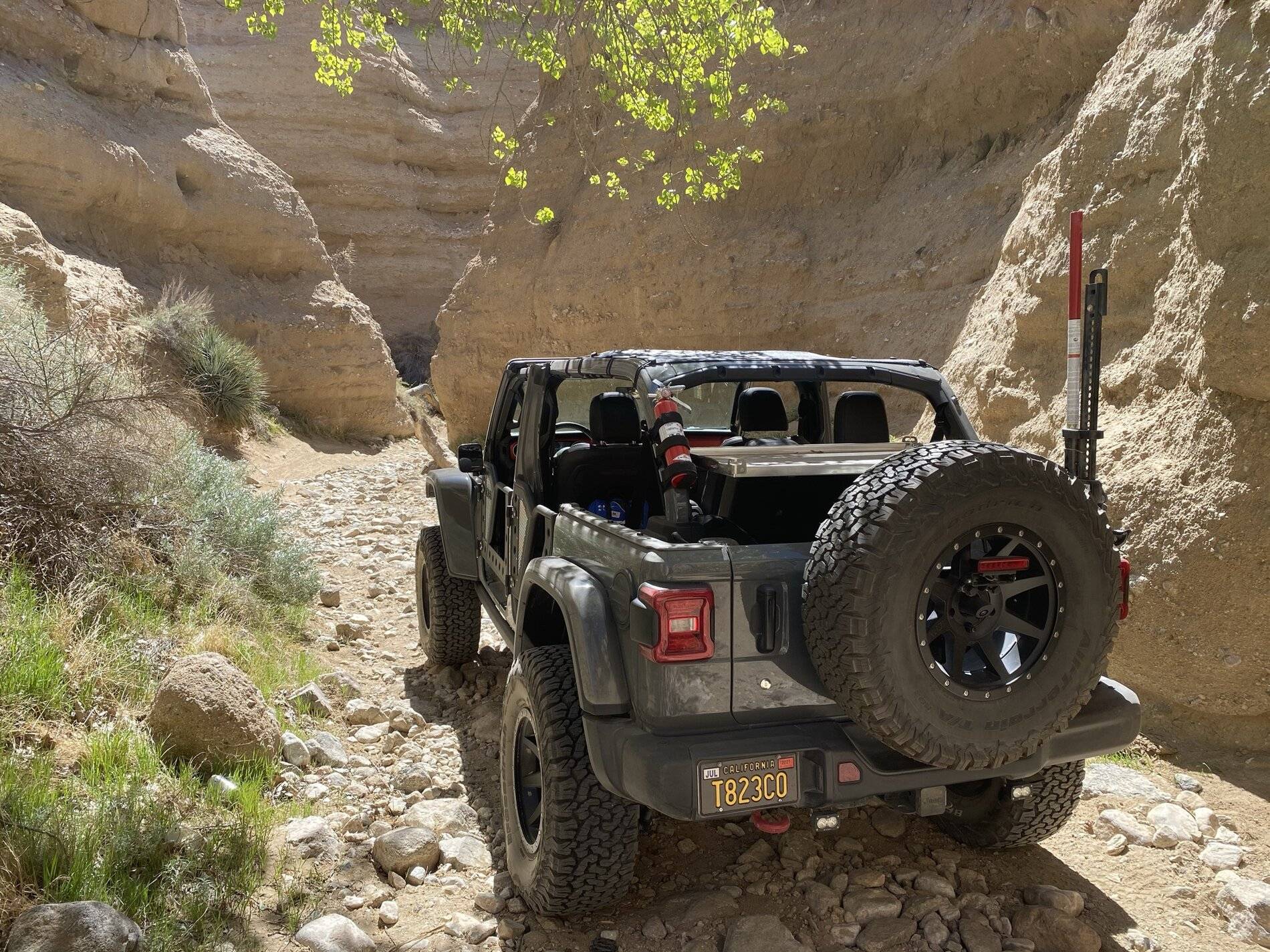

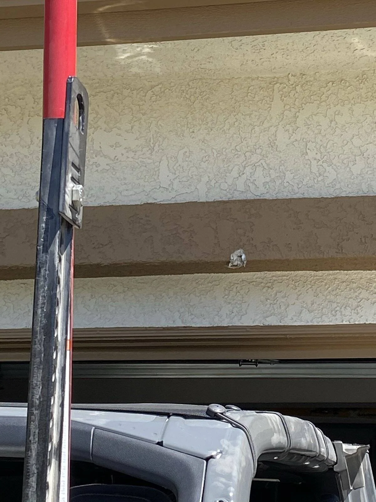

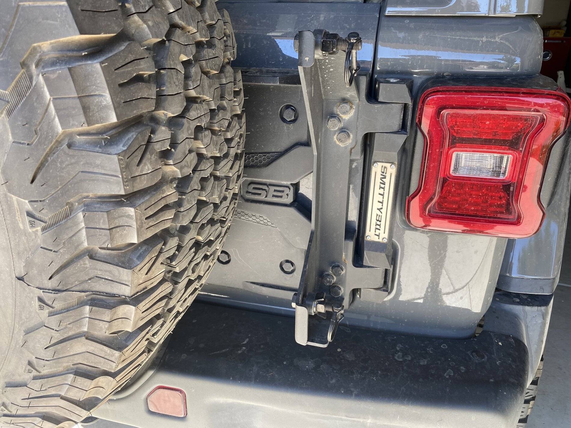

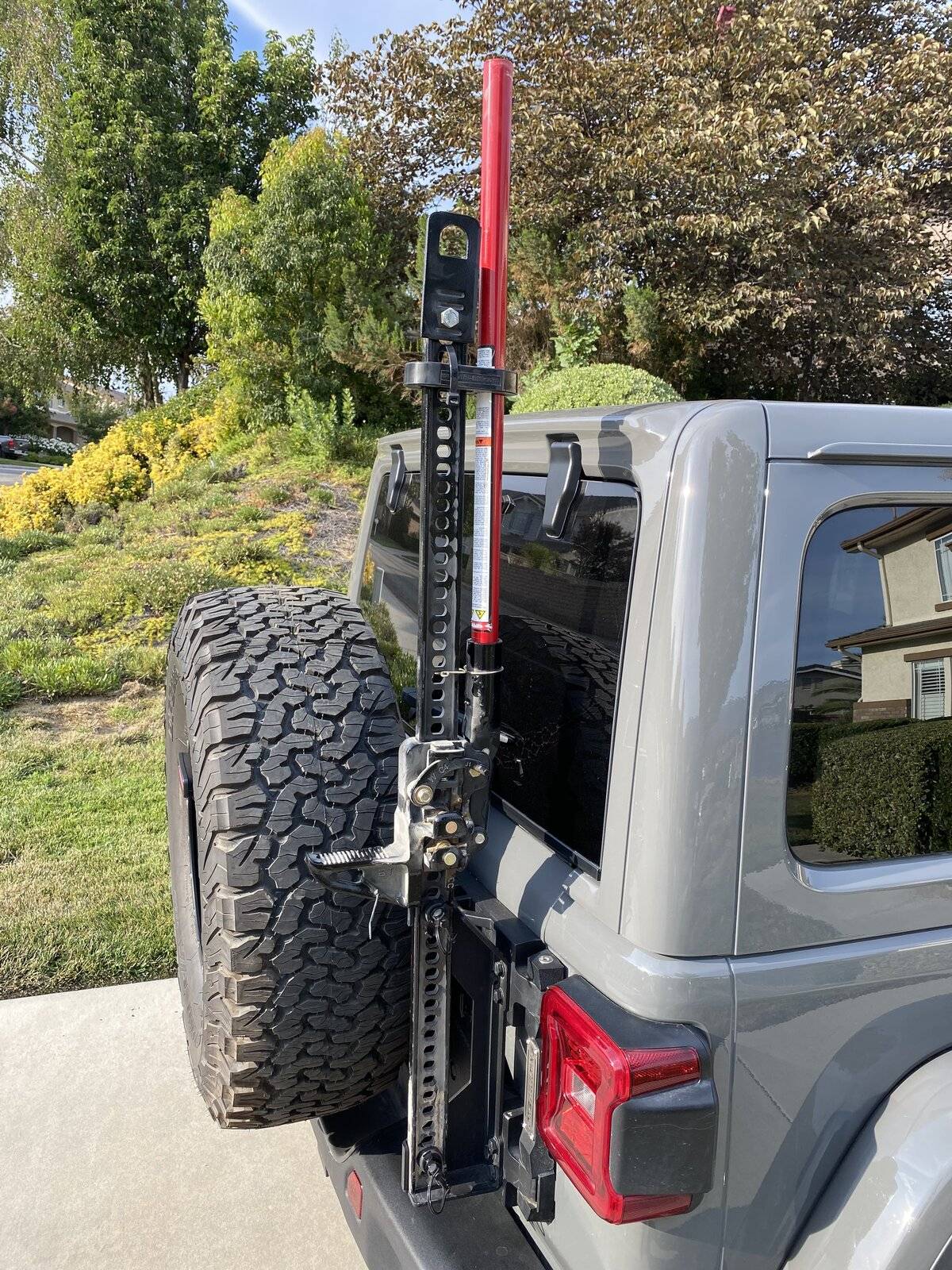

I added a Smittybilt Hi lift jack mount to the Smittybilt HD Pivot tire carrier. It does a good job keeping the jack secure, but I don't like how high the jack handle extends beyond the hardtop. I only attach the jack when I go off road and so far it hasn't been an issue, except for the one time I forgot to take it off before pulling into the garage. I heard an awful crunching sound and knew exactly what it was. I was expecting to see damage to the tailgate or tire carrier, but luckily the handle hit a soft spot on the garage trim and only damaged the house. My wife was not as happy about this as I was, specially since we just had the house painted. I doubt I'll make that mistake again, but just in case I now put something in the garage to block entrance after attaching the jack.
Jeep Wrangler JL 2019 JLUR Icon Build IMG_1122 (2)
Jeep Wrangler JL 2019 JLUR Icon Build IMG_1165
Luckily the dark brown trim is made of styrofoam and the jack handle cut through it like butter. Had it hit lower on the garage the outcome could have been a lot worse.
Jeep Wrangler JL 2019 JLUR Icon Build IMG_0937
The white debris on the tire carrier is part of the garage trim.

I don’t think it will make much of a difference but there is a lot of discussion regarding this issue on the forum. I had the aluminum steering box replaced with the steel one and that helped more. Not sure if that’s the case with your recon.
