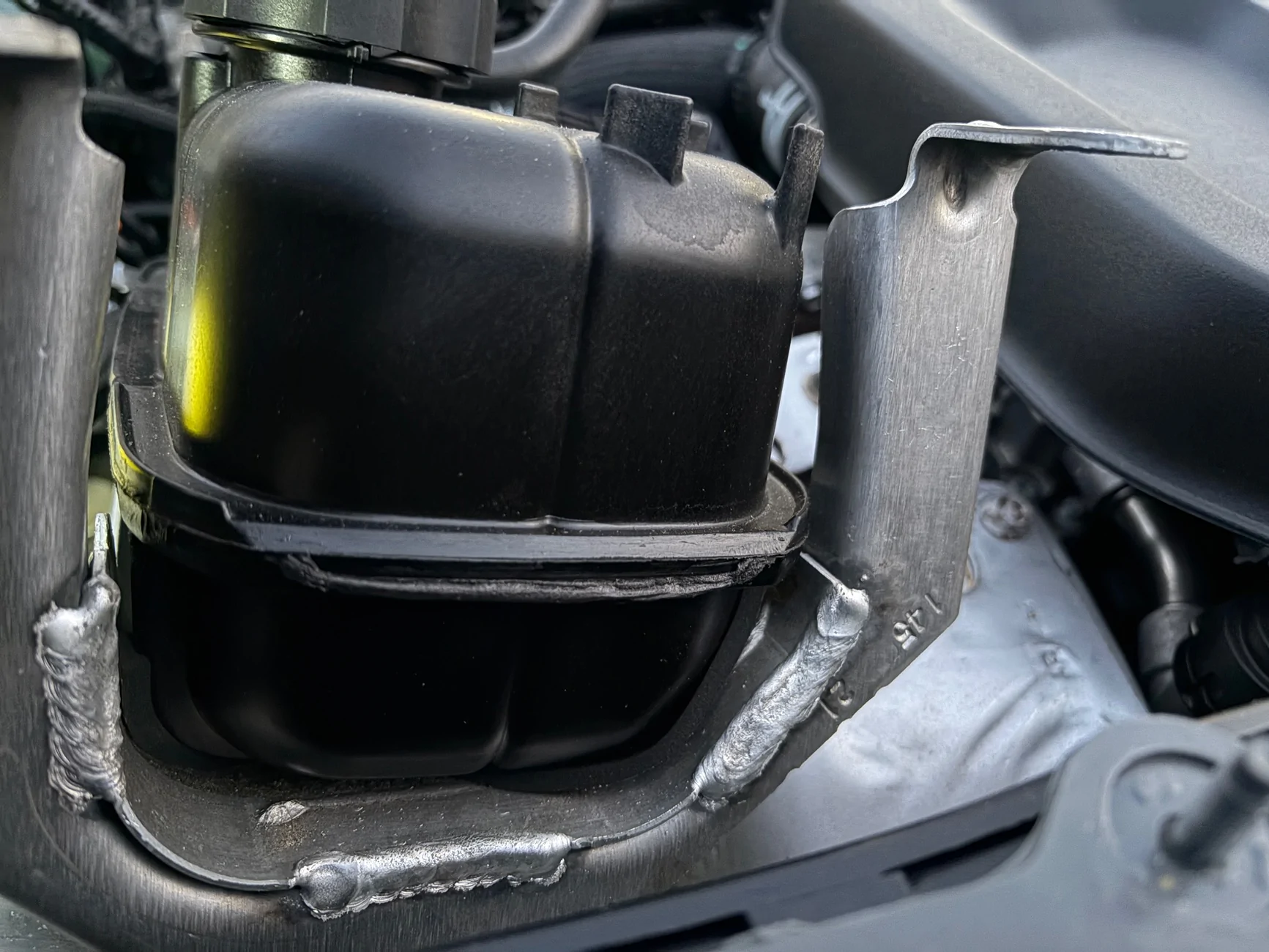

Curiosity got the best of me and I went and pulled the box off. Sure enough the firewall side is deformed and I’m willing to bet I’m loosing coolant through steam or something. No physical leakage that I can tell. But this is definitely deformed.
Jeep Wrangler JL 2.0T low coolant IMG_6088

Okay so update.
So I know the tank looked janky but don’t think it was completely failed or even leaking, yet anyway. Filled at 7pm last night. Drove a hour to work today, up to gas station, back home an hour and out to eat and back. Just checked. Still where I left it. May have been air in the system I finally got out.
Still gonna keep the parts I ordered and install them when I get time. But think we good for now!
