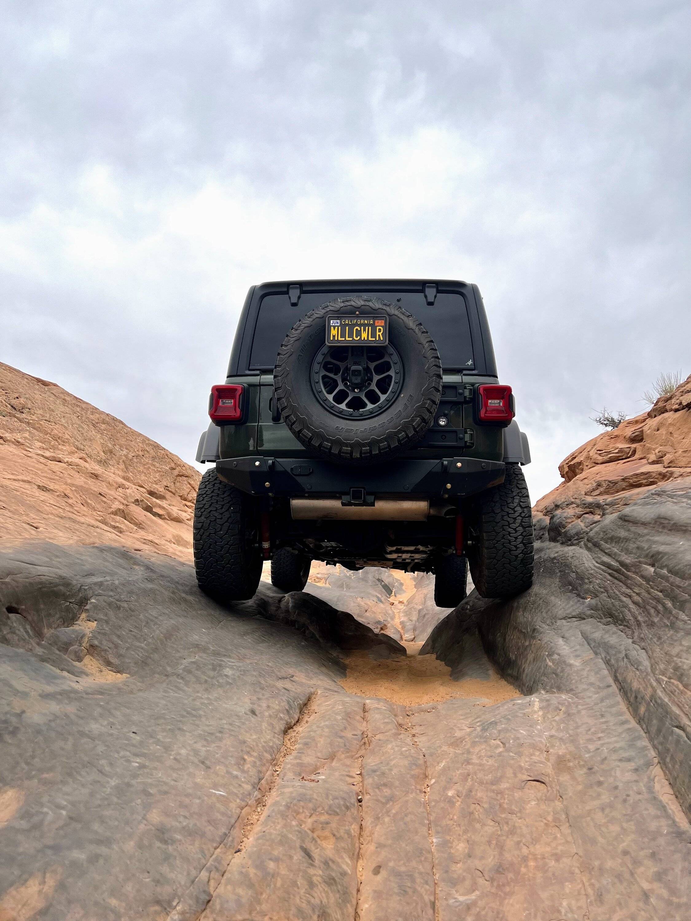

Hit a few trails in the meantime (with a Moab trip thrown in there). I have to tell you this thing does great stock:

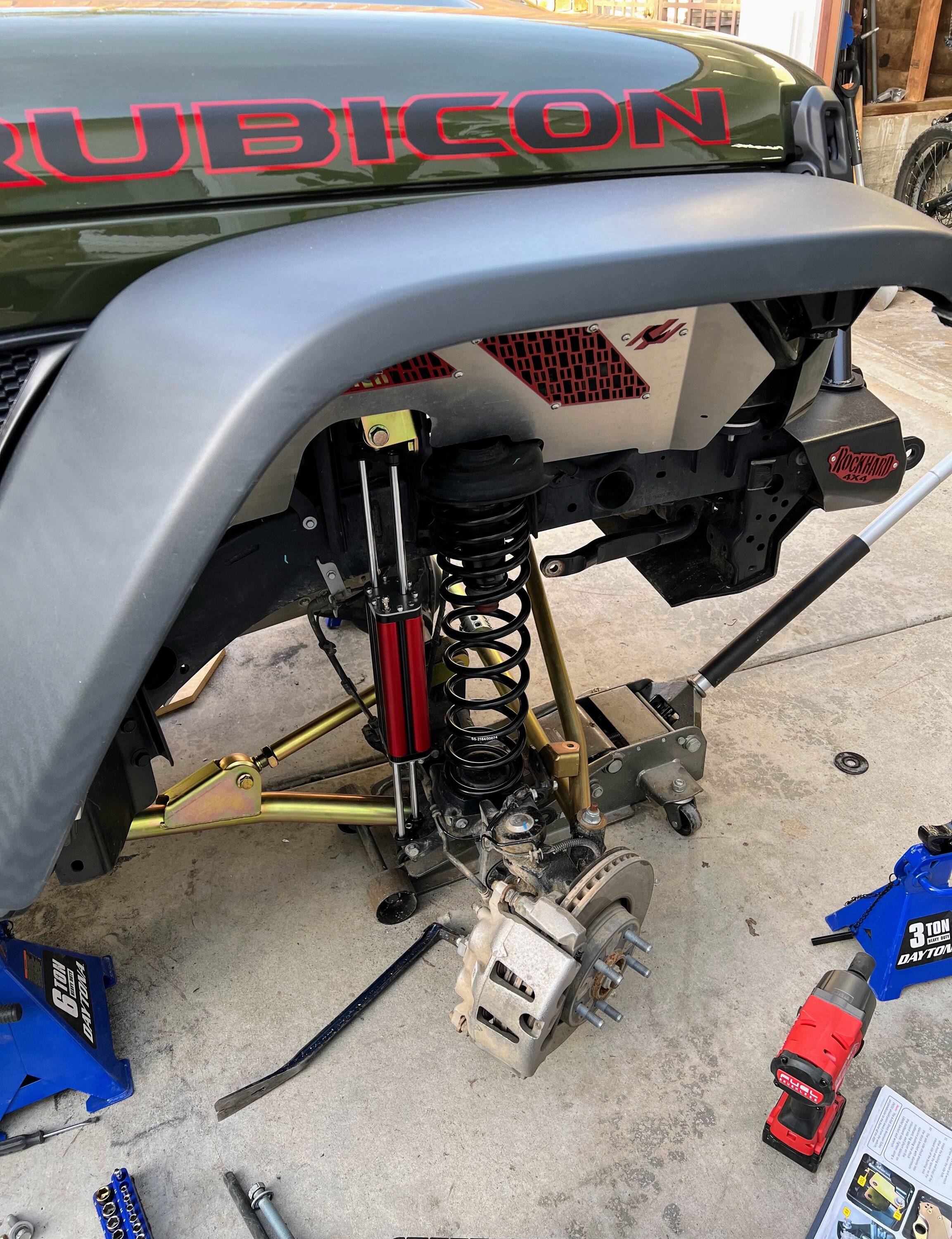

But, of course this was all in preparation for adding a lift. I ended up going with the MetalCloak 3.5" Lock-n-Load with 6pak shocks. The long-arm kit is a lot more involved on an installation so if you're doing it yourself, leave lots of time (took me 2 weekends).

During installation. You need to cut off the front control arm brackets. No going back now!
Jeep Wrangler JL 2022 JLUR Xtreme Recon (Sarge Green) IMG_5577
Jeep Wrangler JL 2022 JLUR Xtreme Recon (Sarge Green) IMG_5580 (1)
