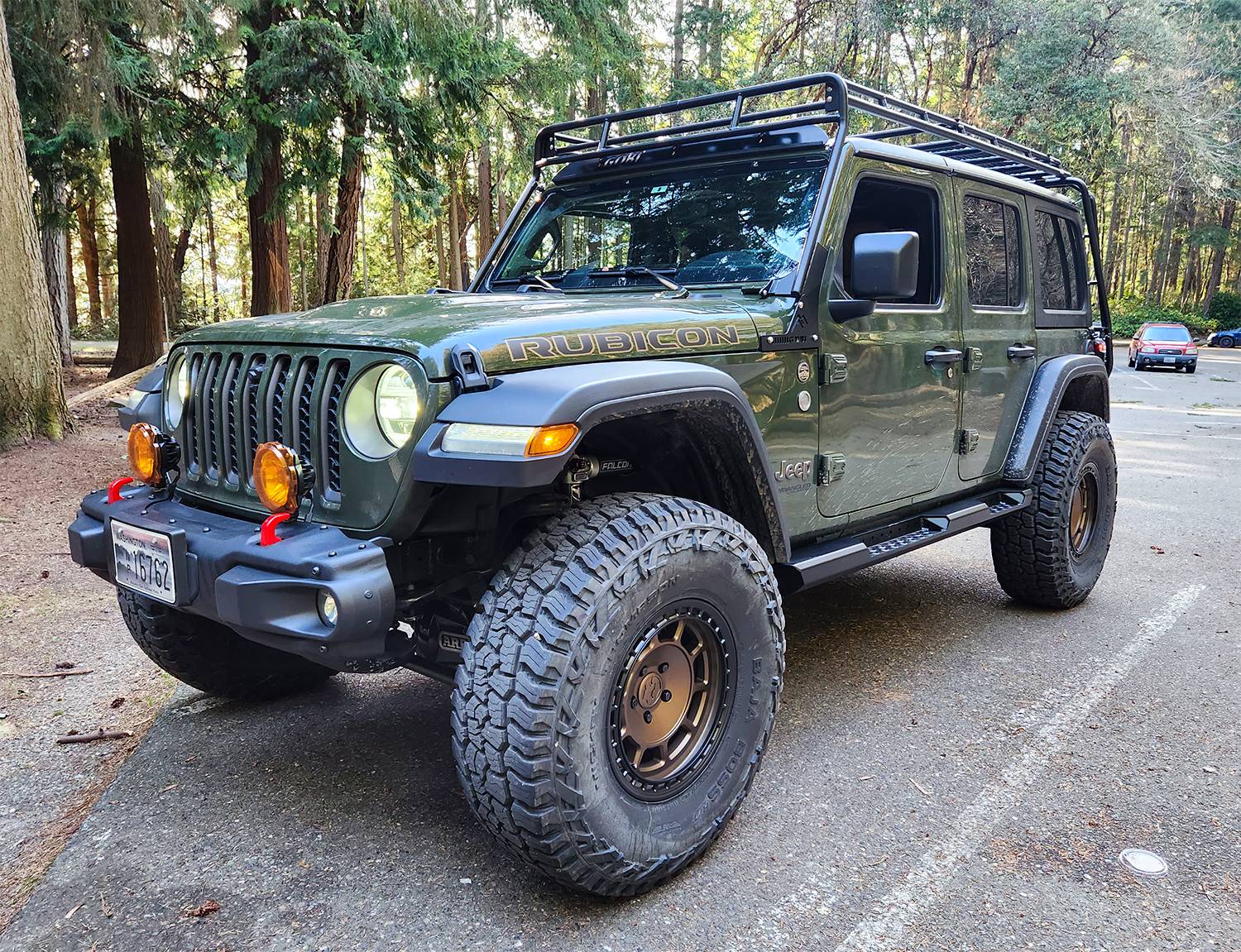

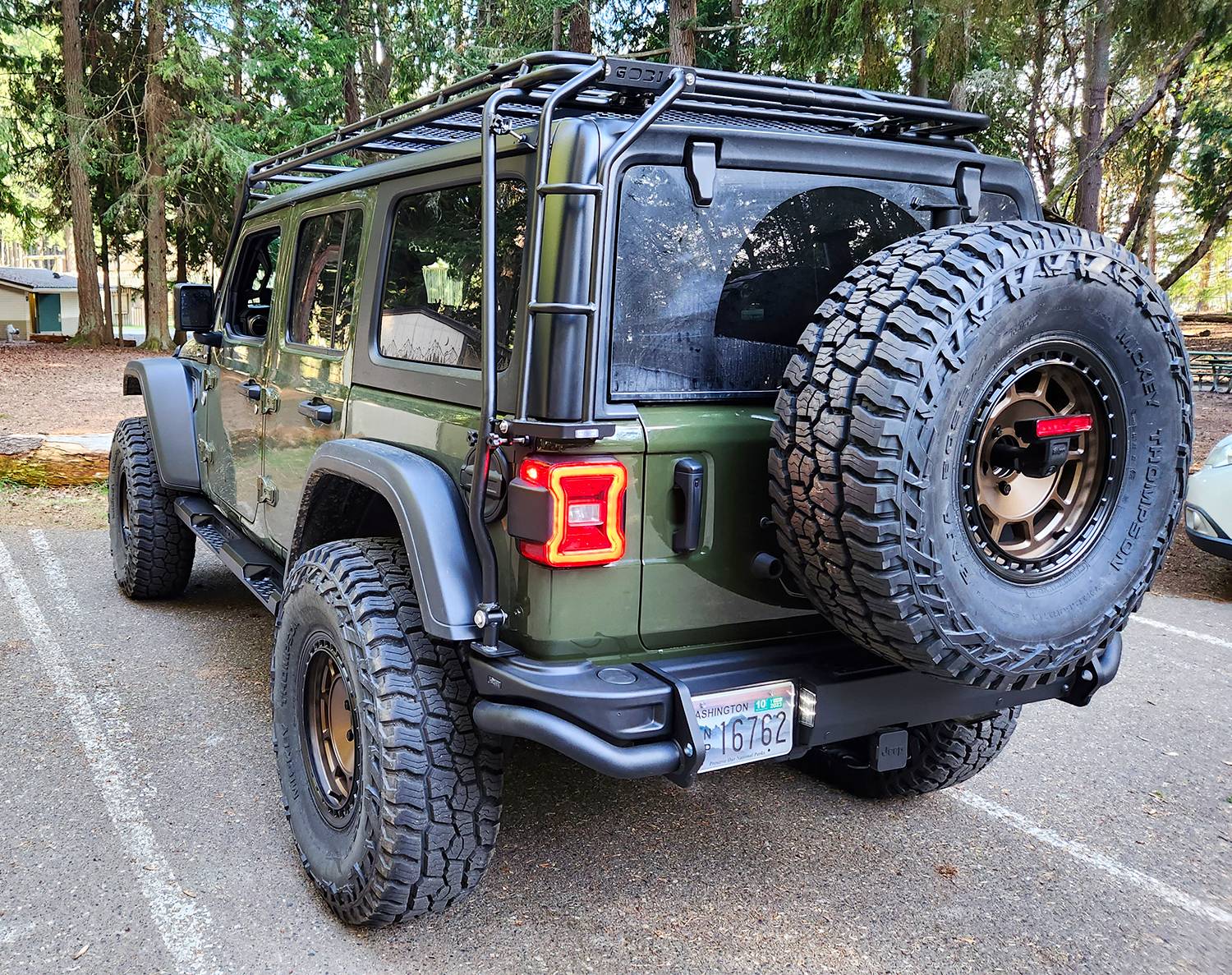

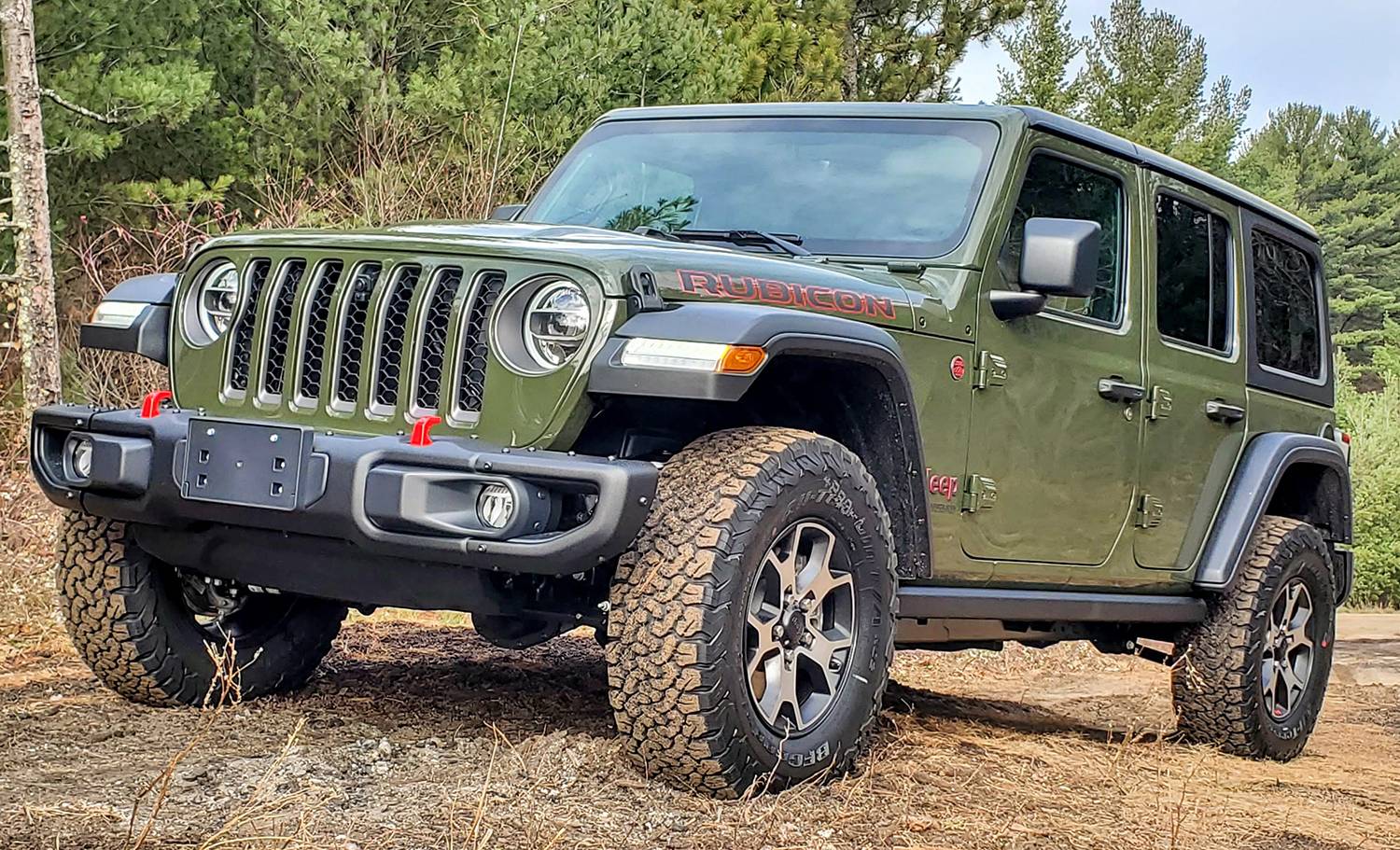

Quite a bit has been done to the Jeep now, and I still have a huge list left to accomplish. Figured I would start up a build journal and document the progress.
2021 JLUR
Sarge Green
Dark Saddle leather
3.6 E-Torque, Automatic
3-Piece hard top - Black
  • Integrated Trail-Cam
  • Cold Weather Group
  • LED Lighting Group
  • Safety Group (standard not advanced)
  • Steel-Bumper Group
  • Trailer-Tow and Heavy-Duty Electrical Group
Ordered September 5, 2020
Picked up October 26, 2020
Name: Kahiltna. Kal for short. The name originates from the Kahiltna Glacier, which is part of Denali. The name is personal and has multiple meanings. My cousin was a leading glaciologist in Alaska and accomplished significant work on Kahiltna Glacier to monitor climate changes. My cousin embodied the word adventure. The landscape of Denali is massive and challenging - leading to the discovery and exploration aspect.
Build type: Overall the Jeep is being built with an expedition mindset, meaning an emphasis on discovery, exploration, and capability. Suppose you could say the build is more for ‘overlanding’ although personally I have tried not to throw that word around as much. A few of my passions guiding the build are landscape photography and adventure travel. I picked the Wrangler due to many reasons, the main being its capability and ability to individualize. As a Lego fan, having my own full size lego machine is a dream of mine! I have tried to be very purposeful with my build, selecting items that not only aid the capability part of the build, but also being mindful of weight and functionality, along with staying aesthetically pleasing. Weight is obviously a big factor with using a Wrangler for this type of build. I try to have a bit of a backpacker mindset with my selections, while focusing the weight on certain key parts (and cutting w/ others).
Stock Current build (as of April 2023)
Jeep Wrangler JL Kahiltna - Sarge Green JLUR Build Journal jeep_stock
Jeep Wrangler JL Kahiltna - Sarge Green JLUR Build Journal Jeep_front
Jeep Wrangler JL Kahiltna - Sarge Green JLUR Build Journal Jeep_rear1
Jeep Wrangler JL Kahiltna - Sarge Green JLUR Build Journal Jeep_rear2
Current build items: General list not all included/Updates will be posted in this list as well.

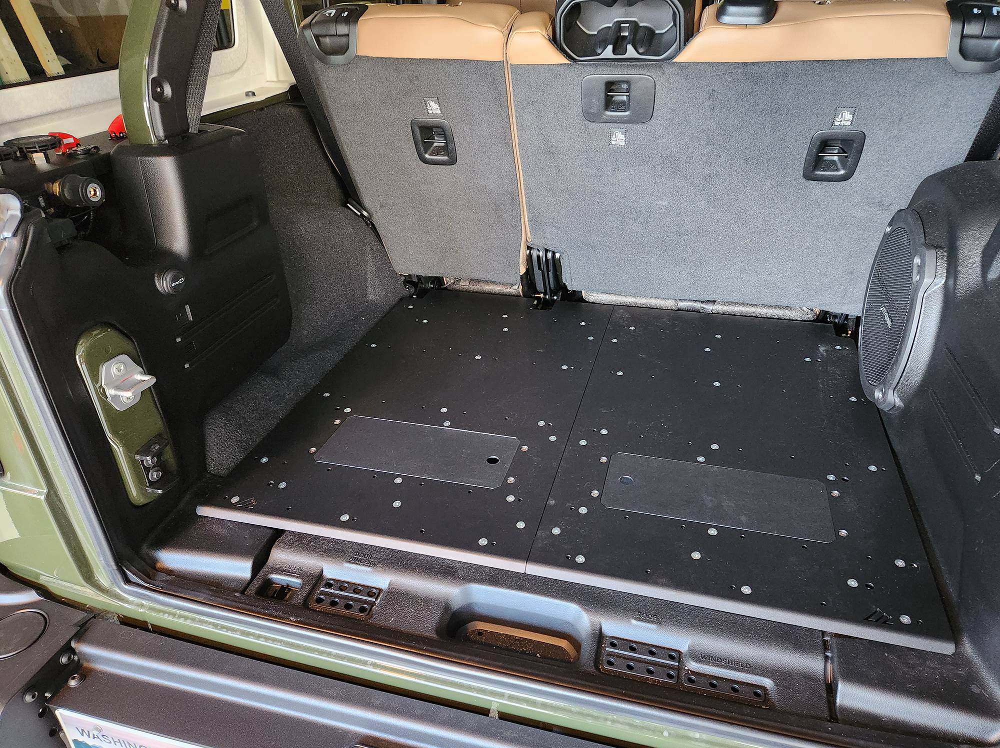

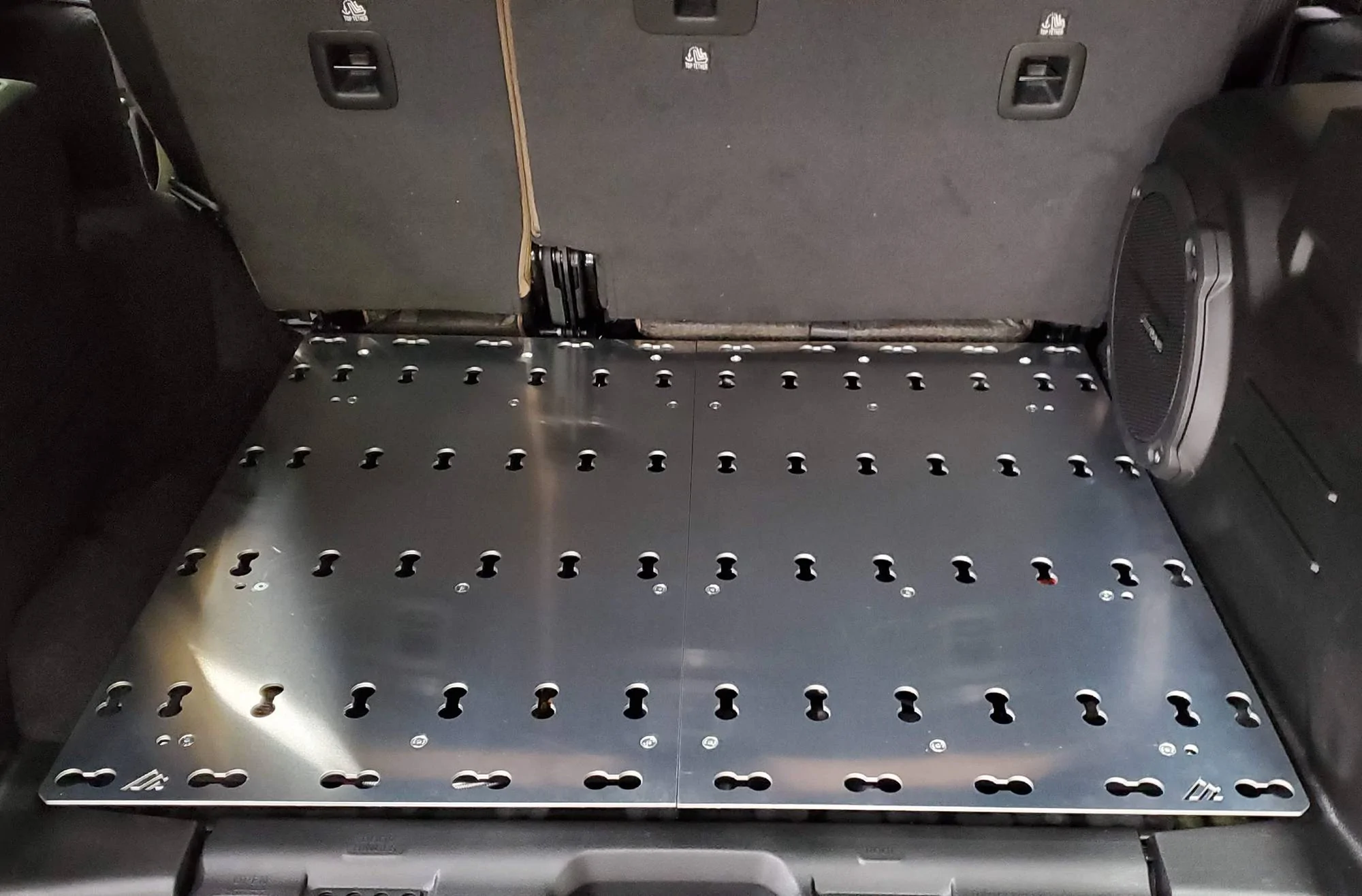

Replaced my American Adventure Labs MASS platform with the new MASS + platform. Much prefer the new design. Having the door/hatches to access the rear cubby with the air compressor is very nice. There are braces that fit the back side of the platform. The two front braces have a section that shows behind the AAL logo. I used some Rust-Oleum metallic paint in Champagne Bronze to match the the other bronze/gold accents around the Jeep. Very close in color.
Will be most likely adding the fridge slide and drawers to the rear as well. Have not decided on the drawer layout yet though.

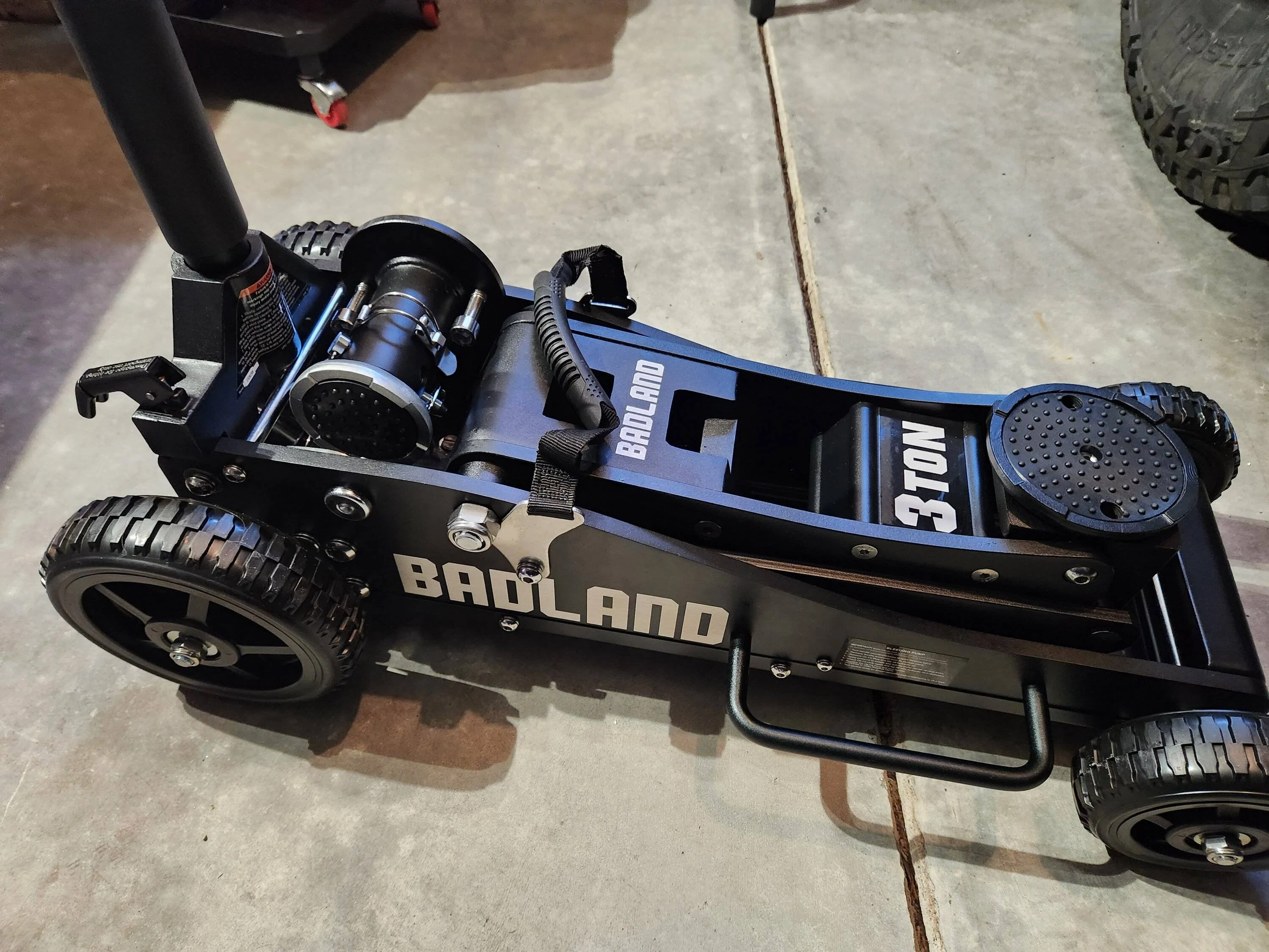

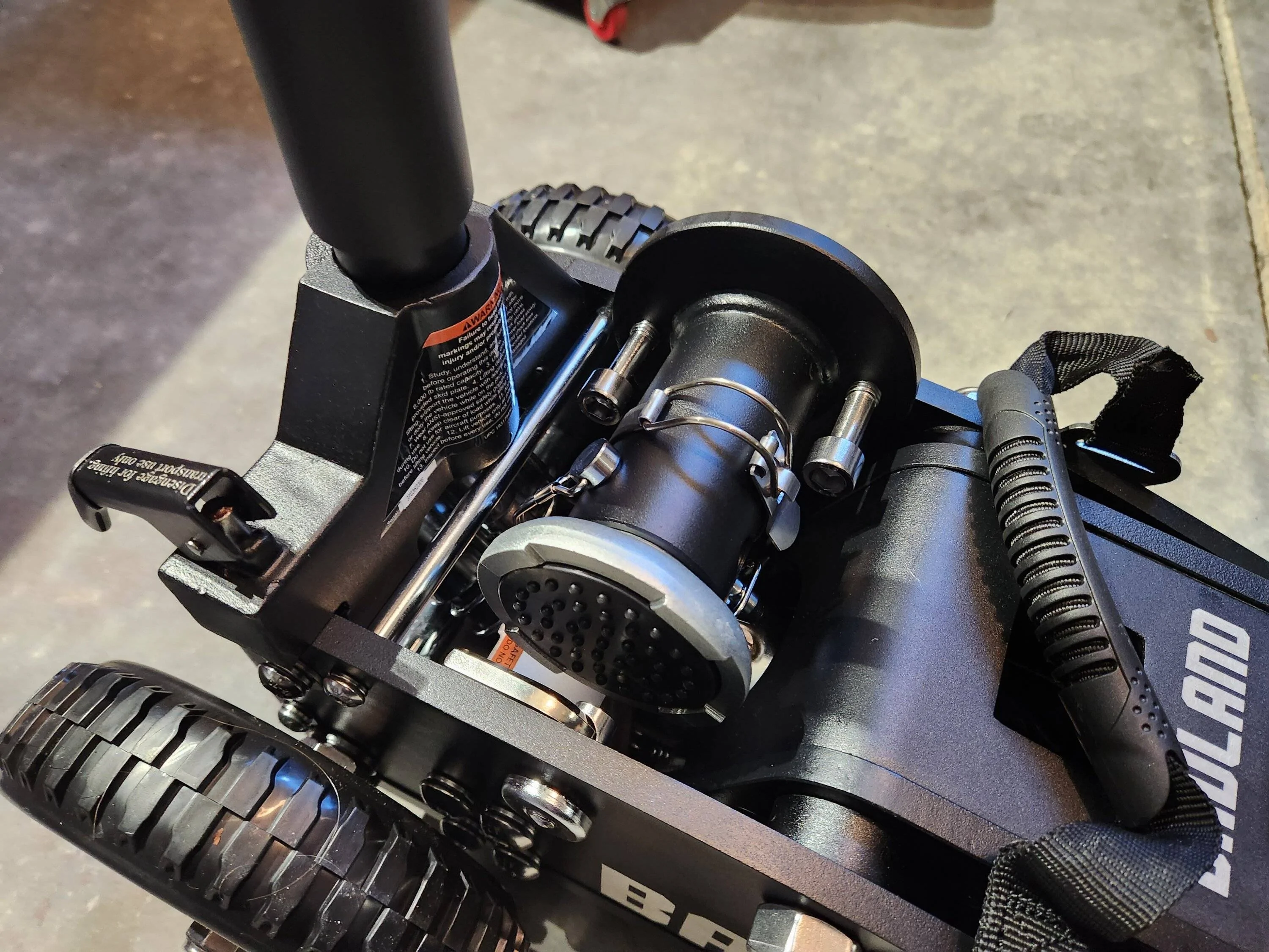

Also... "Assembled" my new HF badlands floor jack. Really only required installing the wheels and the clamp to hold the optional extension.
So far, very impressive build. The main structure has got to be 7/16 to 1/2in think steel. Also really like the carrier for the optional extension. It fits securely in it's housing when not in use. Easy to add the extension as well, and even includes an Allen key (that has a mount on the jack). For $300 I would say it's a very good buy vs the competition (pro eagle).
Ooooo....I want one....need a second jack and this fits the bill!
