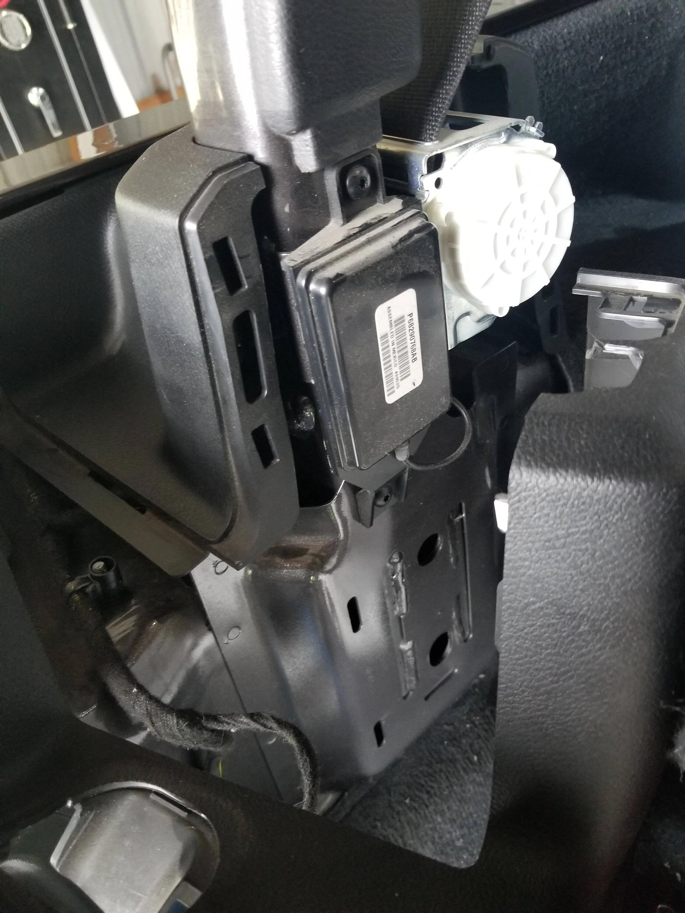

Thought I would post how I fixed my cargo rattle in case someone else has the same problem.
It was mainly over bumps and coming from the driver side. I removed the rear drivers side cargo panel and found this black module to be the problem.
They used plastic inserts to secure it and they loosen up over time. I tapped for two 8mm bolts into the frame and put a little lock tite on it.
Jeep Wrangler JL Cargo area rattle...FIX.  UPDATE with 2nd rattle. 20230924_091633
Edit: Had another loud squeak start about a week after I fixed this one, I was like wtf. It was also coming from the rear drivers side. I found the protective tape had come off the tailgate bracket here....
Jeep Wrangler JL Cargo area rattle...FIX.  UPDATE with 2nd rattle. 20231021_043628
I had some spare PPF so I cut off a small piece to replace what was there. All quiet now!

Took a trip out to Silverton CO in August and developed a rattle when going over larger bumps. I’ll have to check this out! Thanks for the info!

I've got a squeak too that's not the tailgate. I know it's fairly common as I've heard it in other youtuber videos as they were driving..
Do you have a sound clip of the squeak? I'd love to find it and fix it.

No sound. It was a pretty loud rattle of plastic against metal. Definitely not a squeak.

NICE!

Awesome, thank you! I've been trying locate where that is coming from.
