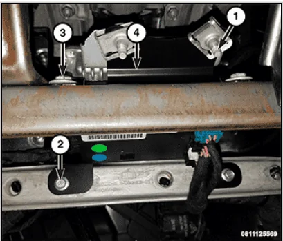

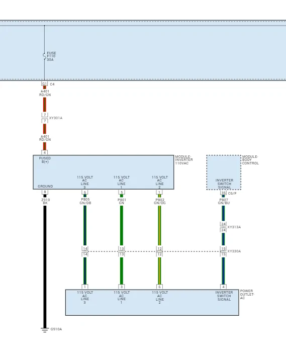

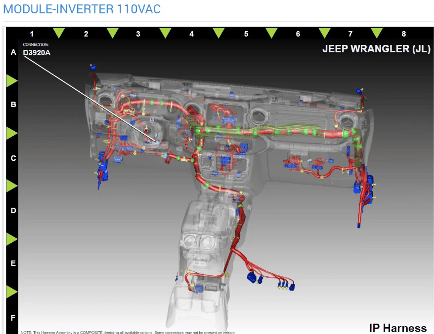

Inverter location:
Jeep Wrangler JL 110 inverter not working, Need some help.... 1700662116894
Jeep Wrangler JL 110 inverter not working, Need some help.... 1700662136035
