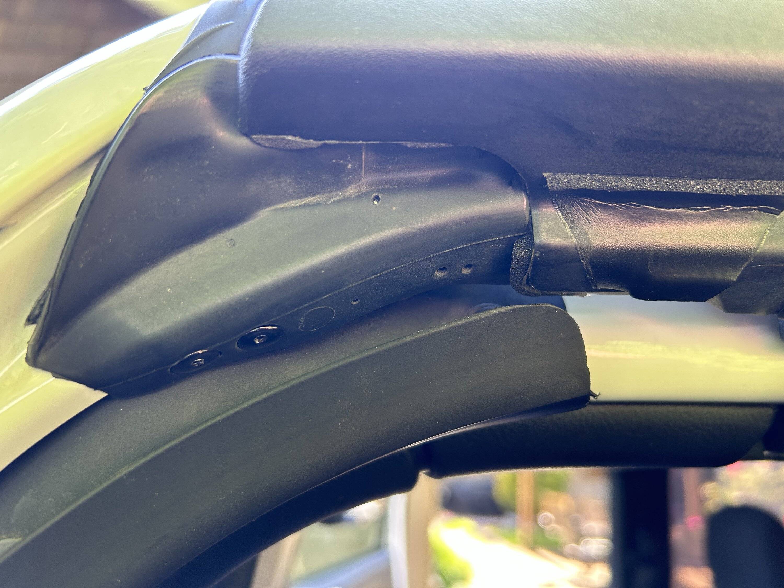

I know there’s quite a few post on this issue; but never saw one addressing the issue that I discovered on mine. So I thought I’d share it.
I bought this soft top Jeep end of January. Sometime in April I started getting a lot of wind noise mostly around the passenger door & a little on the drivers. Beginning of May the passenger side soft top latch popped loose!
I tightened the latches & some of the wind noise went away; but I still had a lot of it. I think as the temperatures started warming up was a contributing factor in all of this.
So I continued to unsuccessfully hunt for the issue. Yesterday, I discovered the previous owner incorrectly reinstalled the plastic overhead door surround after putting the top back on. The corner gaskets were trapped underneath. This morning commute was back to normal soft top noise. What a relief…
Before:
Jeep Wrangler JL Wind Noise Problem Solved IMG_3826

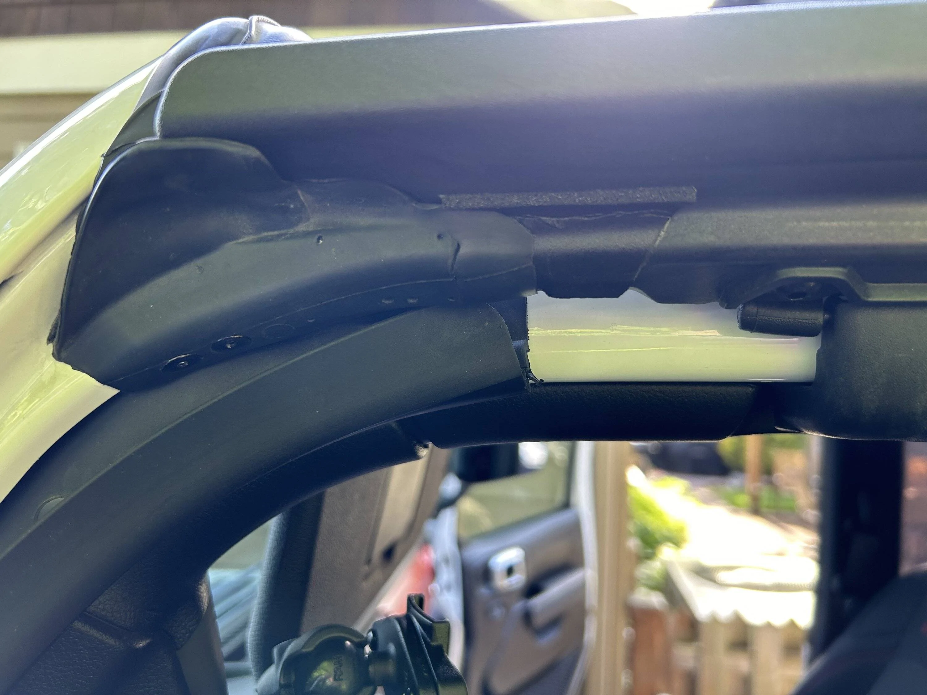

After:
Jeep Wrangler JL Wind Noise Problem Solved IMG_3827
