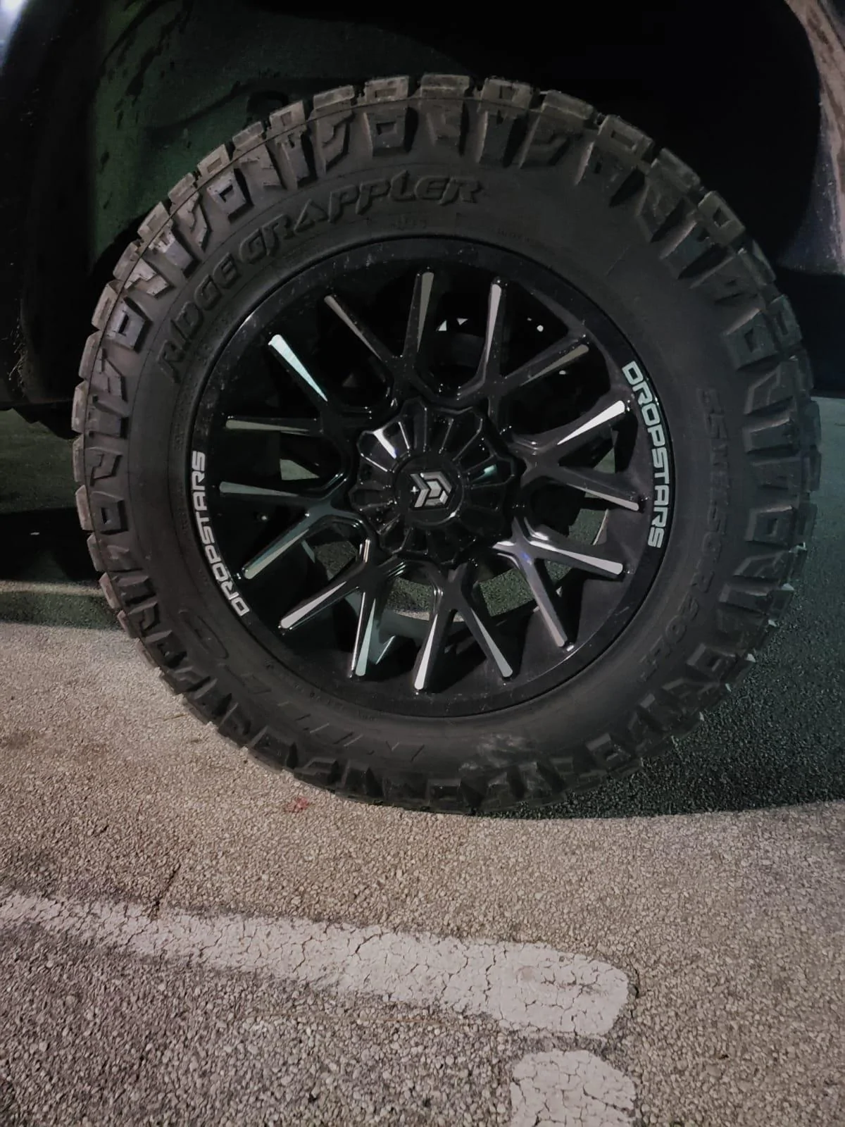

New to Jeep obviously...mybrother has these on his Ram And is planning on getting a Ram Rebel. So hes gonna take them off and offered them to me. 35x11.50x20. Would they fit without mods or do ineed to level/lift kit. If so what do u guys recommend.

If you had a Rubicon they would fit without rubbing, on a Sport you'll probably want a small lift. Do you know the specs of the wheels (width & offset?)

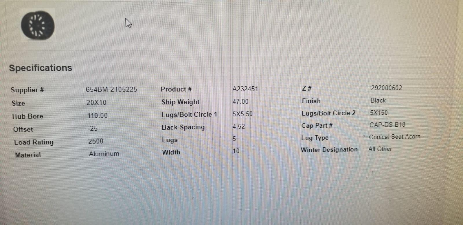

These are the specs. Is the lug spacing right also?

So any recommendations on what I should be looking for: Where to buy and I am really lost with the offset. What would be best measurements for my JLU without too many modifications?
Do you have a Rubicon, Sahara, or Sport? That will impact what fits.
On a Sport you should be able to run a 285/70r17.
On a Rubicon 35/12.5r17.
