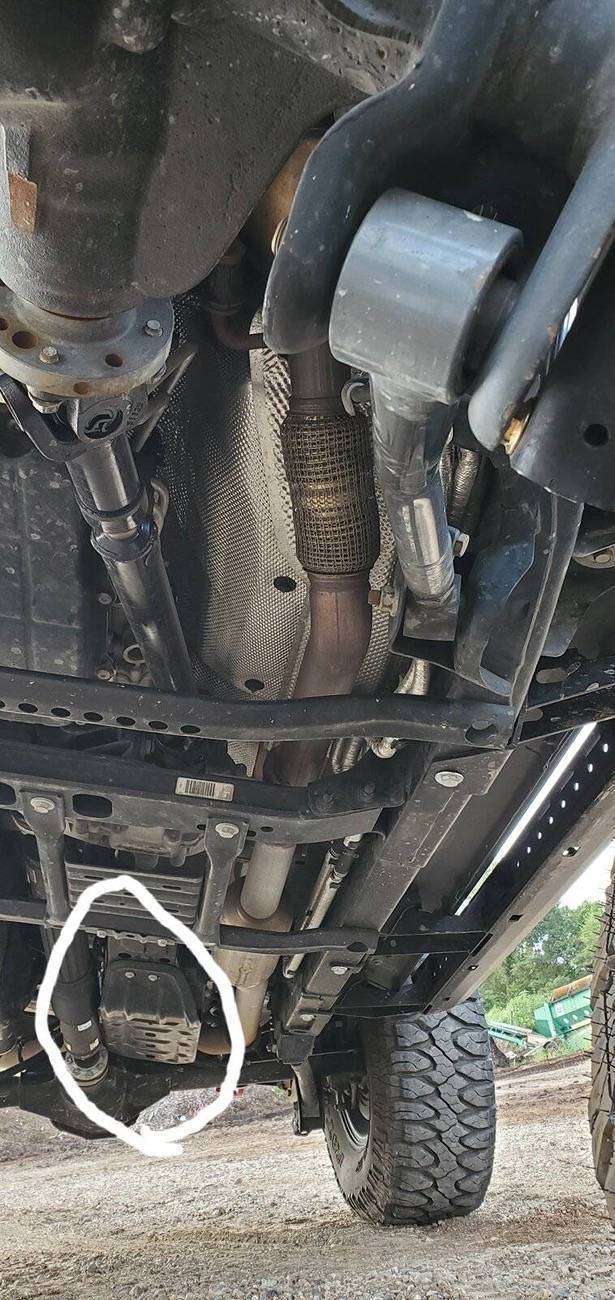

Etorque system is still built with an empty battery box for a secondary battery in the fender well. Rather than counting battery cables and coolant tanks, simply take a minute and look under your Jeep. If you see this you have an etorque. If not you don’t.
You are correct. I do have the e Torque!
