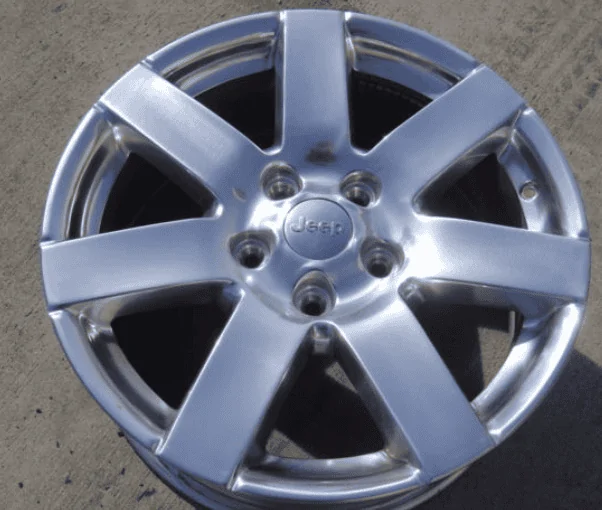

Does anyone know if the 2017 Sahara 18" rim would work on a JLU Sahara? I'm not wild about the stock options and don't have the $ to buy aftermarket this year. I'd swap these from my current jeep if i could. thoughts?
Yes, they will. The JK and the JL have the same 5x5 (5x127) bolt pattern.
