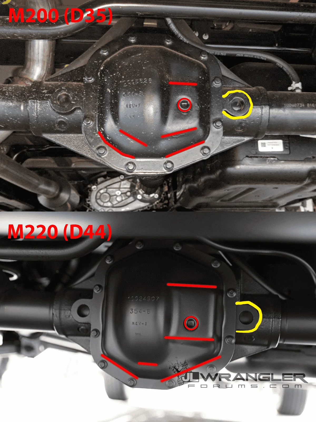

So I bought front and rear ARB diff covers for my 2021 Willys from Northridge. According to NR they would fit. The rear dosen't. The box says Sport/Sahara. My window sticker says anti spin. Is that the same as limited slip? Thanks in advance!

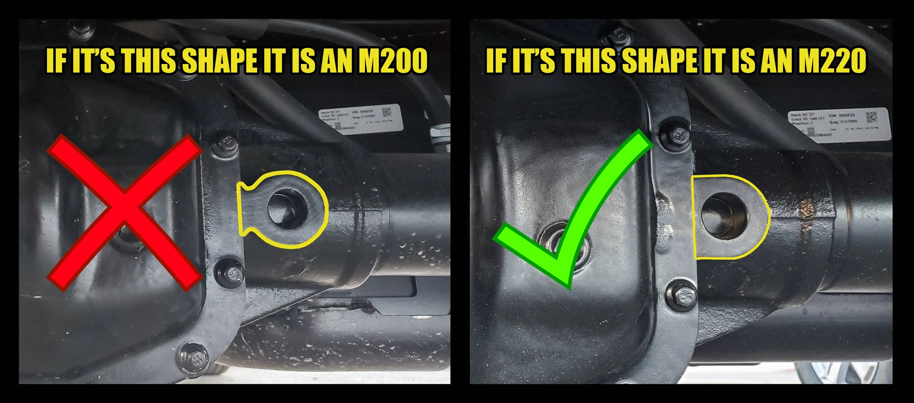

There are 2 different size axles available. They use different covers.
The smaller M200 is standard. The bigger M220 comes with the anti-spin differential. And yes, that is the limited slip.

So I have the M220?

Yep, definitely the bottom one. M220 Thanks!
