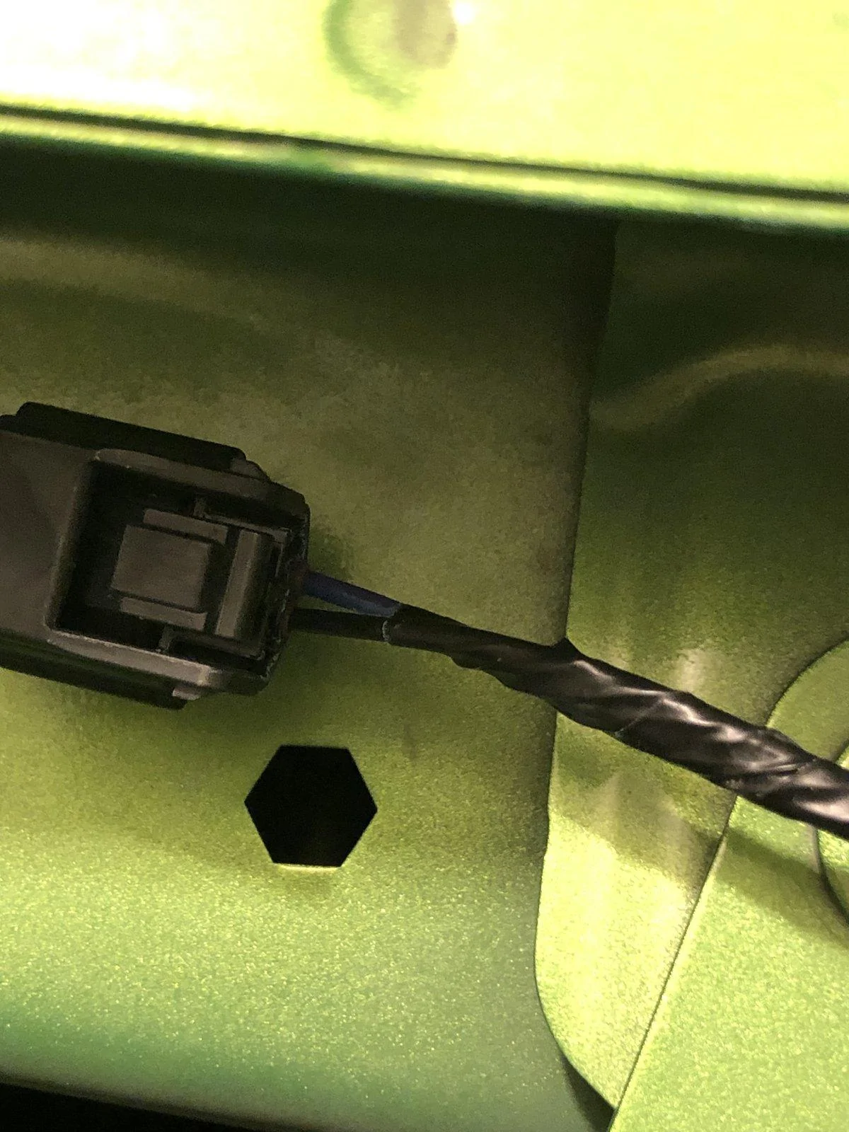

I was installing my 2m/70cm antenna today (thanks White Jeep) and found this unused connector under the upper body apron.
It's not part of the Auxiliary switch system as I have worked with those already.
Any clues?

No idea, I don't remember seeing that on my 2018. Maybe an option on 2019 models. Its very weird to have a harness with nothing attached though.

Wonder if it connects to the ACC if equipped? Just a thought. No clue actually.
WOW!!!! WINNER!!!!

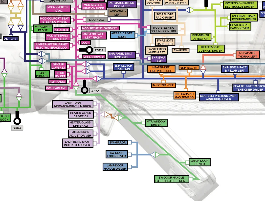

Out of curiosity I checked if mine was connected. It is, and wire colors match the ones connected to the windshield where the defroster grid under the ACC module are connected.

it can be whatever you would like it to be, lol however that just capped with a "dummie" plug anyway I wouldnt worry about it.
Jeep Wrangler JL What is this connector? Screen Shot 2019-02-25 at 8.26.22 PM
Colors are all over these Jeeps. Three sets of Orange/White go to the rear.
Gage is a bit small for ant AUX control.
Did you test it?
