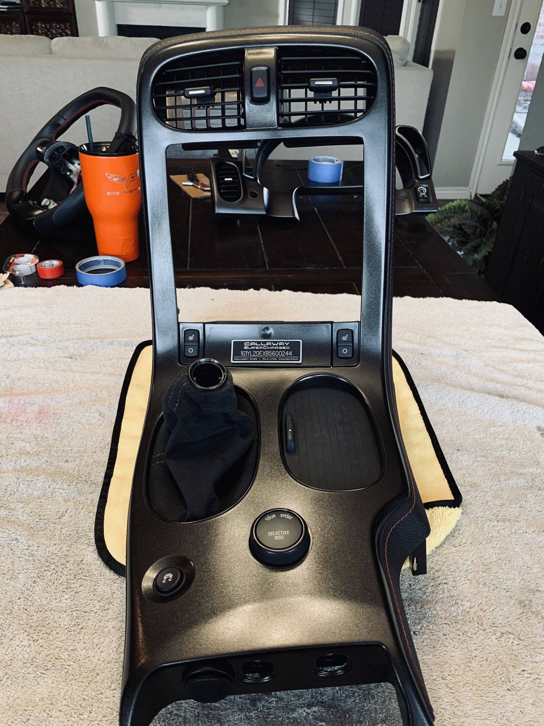

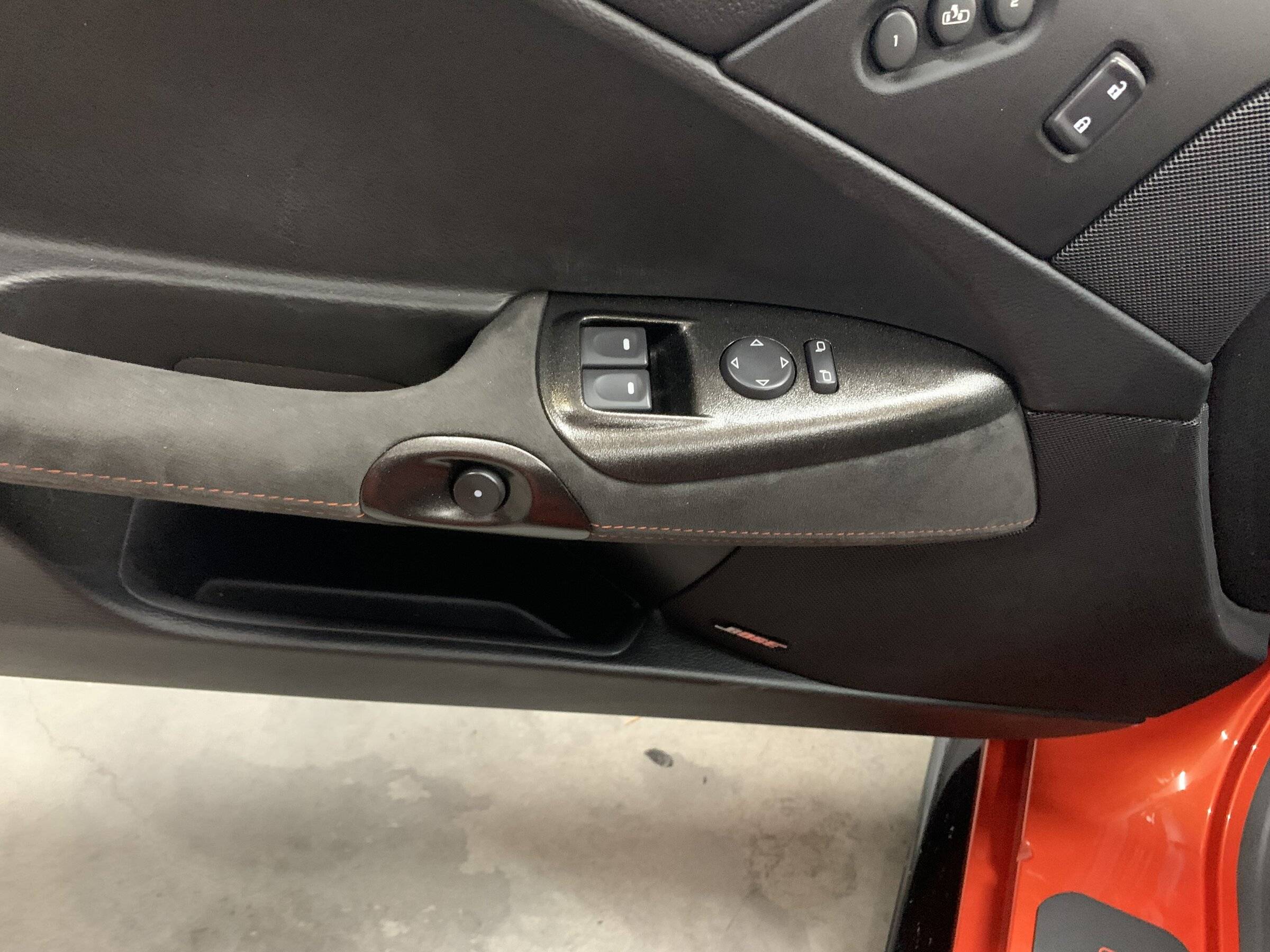

Re: painting, any paint (krylon, rustoleum, etc.) that is specific to plastics. Krylon Fusion All in One is what I have been using recently with really good results on a variety of projects. You could also use adhesion promotor if you wanted, but on a piece that size and that won't be under direct contact all the time it's probably not needed. Test spray something else to compare to your current trim to ensure the color-match is to your liking. Lightly scuff the piece up with some sand paper then spray a couple coats of your selected paint. Follow the instructions on the can re: dry time between coats and before handling, etc.
Here’s a couple examples of pieces from my Corvette all "rattle-canned" as they say.
