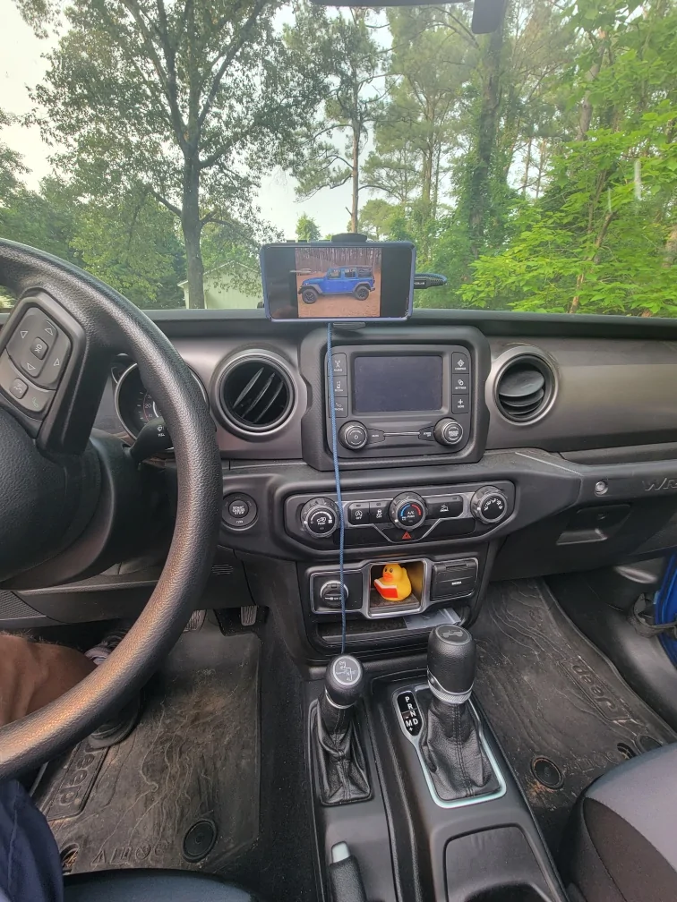

Yep. I intentionally got the most stripped down Jeep i could for those reasons. Not my daily driver though. Nice to step back to simpler times. Only glitch in the dumb display is an occasional lag in the volume when changing it using the knobs.
Jeep Wrangler JL Various Center Console Display/Audio Issues Resized_20250602_180749
