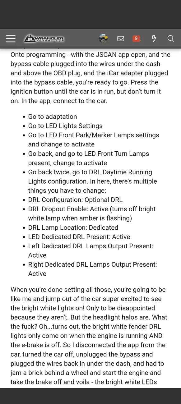

Outside of that, I found these setting suggestions for the front DRLs and LEDs and want to be sure they are the same settings even if I'm not doing factory lights? Meaning, since I'll be using a chop kit light, will the Jscan settings still apply?
