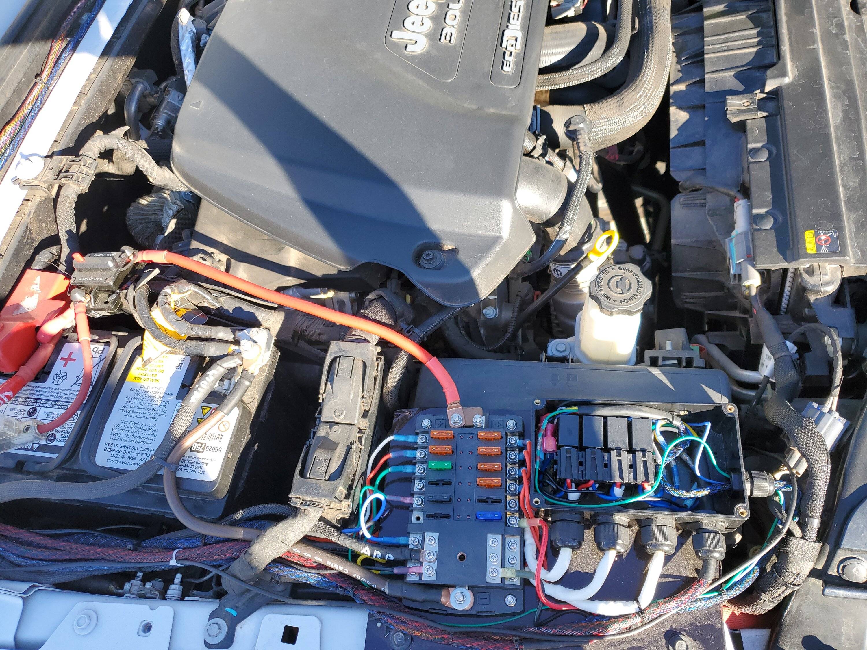

I'm looking at wiring 6-8 KC lights in and am looking for input regarding good, reliable fuse/relay blocks I can mount under the hood near the battery. I'm planning on installing 2-4 FlexEra 4's, 2 FlexEra 1's and 2 FlexEra 3 SAE amber fogs. I'd like to have individual control of each set, so maybe some kind of S-Pod setup inside the cab. What do y'all use or recommend?

you can make your own relay setup alot cheaper than the ready to wire in kits, I have seen a mixed bag on these forums but I would say most people do the kit relays because they have everything needed. if you kinda know what your doing and are not afraid to learn you can do a custom setup easy. With what you are asking about you could get a water proof box for relays. I will just post pictures of my setup to give you an idea, give me a bit
