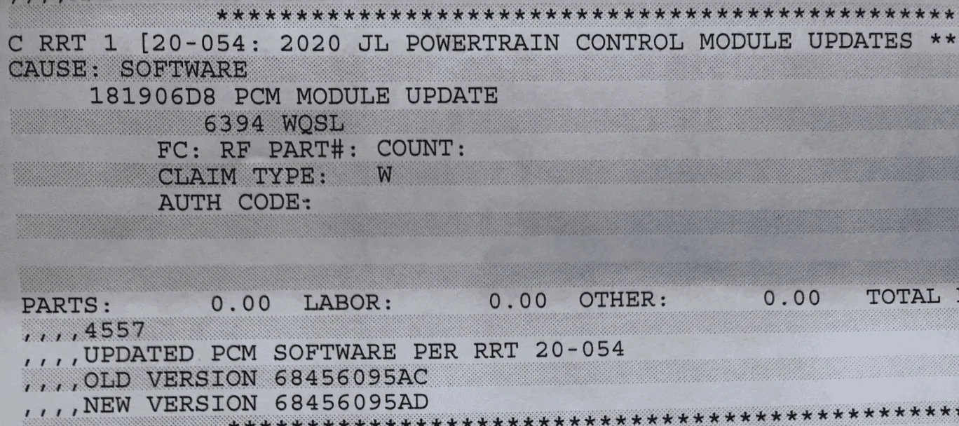

Thanks for the update,
Mine is 2020, My dealer did this update and i don't know what it is about
Jeep Wrangler JL TSB 18-057-20 PCM UPDATE IMG_20200908_000552

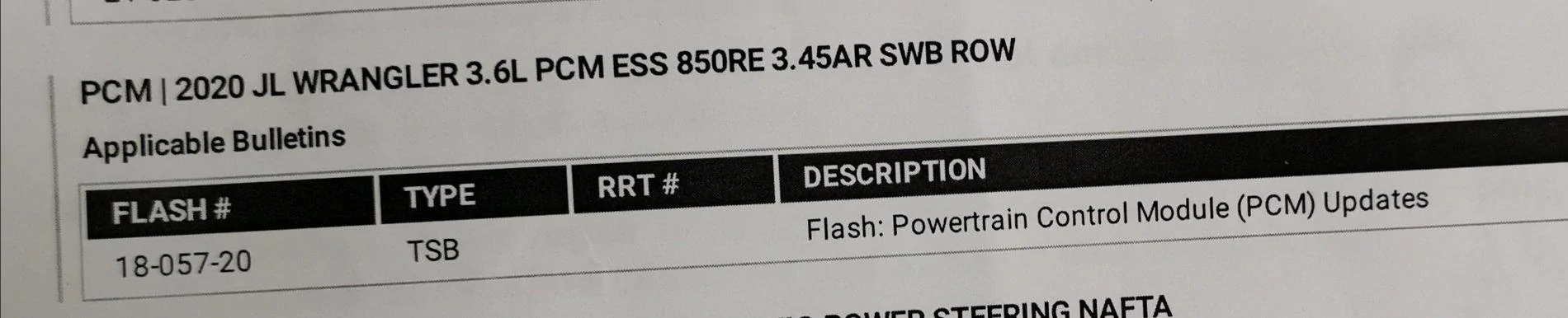

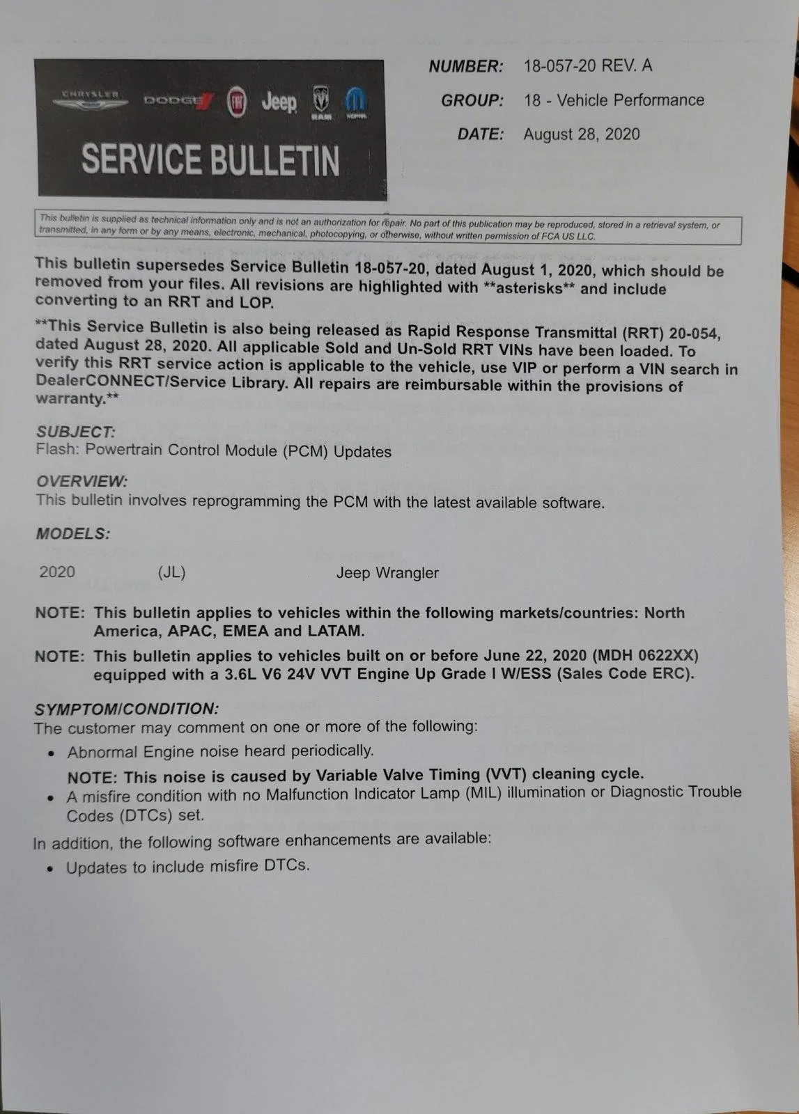

I got the TSB from my dealer today and here it is.
Thanks!
I went in for an oil change on my 2020 JLUR 3.6 and they performed what looks like a similar update. I didn't get the chance to ask too many details, but came here looking for anyone else that had it applied.
Jeep Wrangler JL TSB 18-057-20 PCM UPDATE 1600270901156
