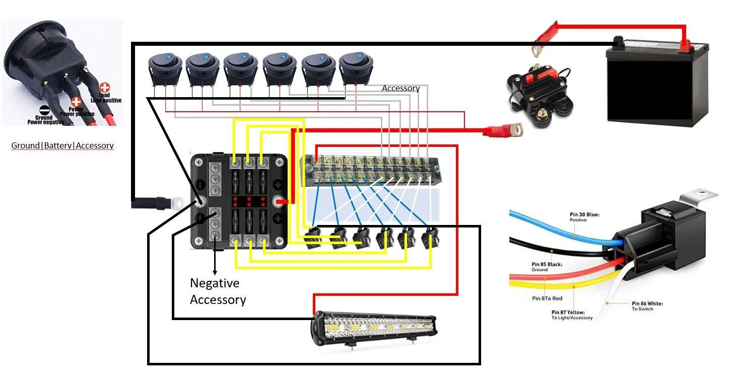

Trying to setup a switch pod. Is this correct?

If you know how to do this, is this right?
Jeep Wrangler JL Trying to setup a switch pod. Is this correct? 2019-09-20 15_23_52-Switch tap into circuit breaker power.pptx - PowerPoint

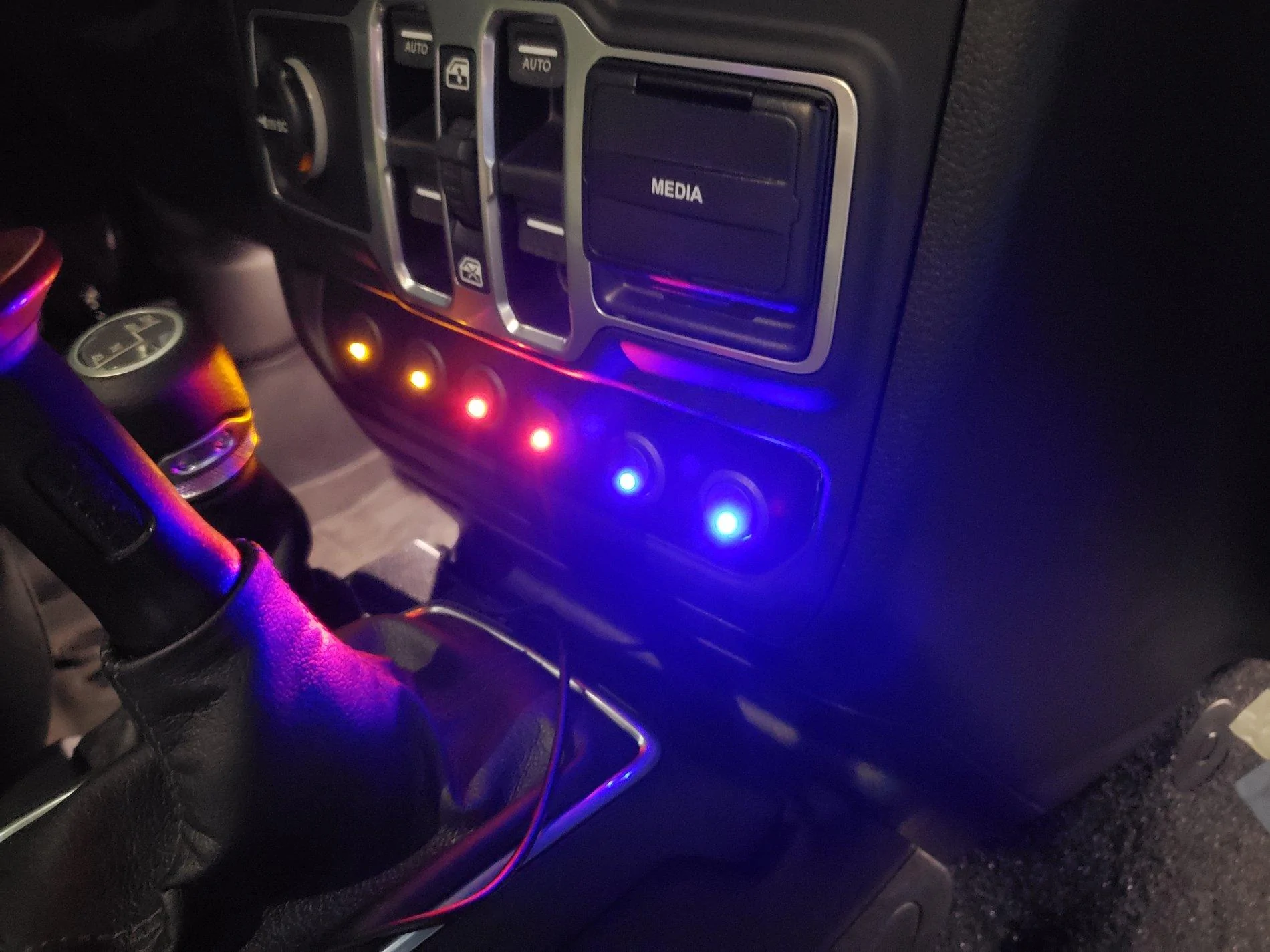

Nice work. I’m thinking about a switch pro as well. I should have done this like first week. What do you have hooked up to it?
The rear console dual USB is connected to a switch, Lol. I'm supposed to get a dual mount for flood and spot lights this week.
