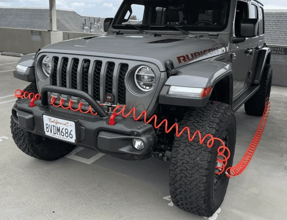

I personally went under seat with this kit

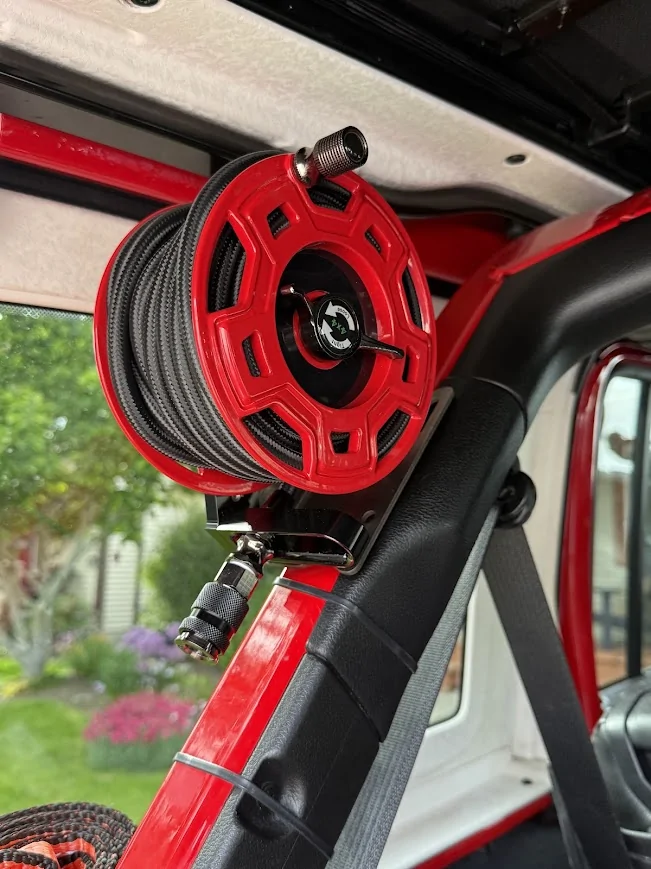

I had the VIair 450, it worked ok but it still took more than ten minutes to air up my 40'" from 12 to 28 psi. I used a four way inflator so I didn't have to check air pressure ten times each.
Then I installed an ARB twin brushless with the grim offroad mount. I put it inside the front driver fender/under the master cyl. I didn't want the compressor inside as I didn't want to listen to it or they have a gear oil smell. I also mounted a two gallon tank on the inside of the frame and installed a hose reel on the rear roll cage. Now I have the option of quickly pulling out the hose and airing up or attaching the four way fill. The new set up with the two gallon reserve takes me about four minutes to air up.
As others have said buy once cry once. The Viair option should work well for most users. I just liked not having to pack around a compressor.

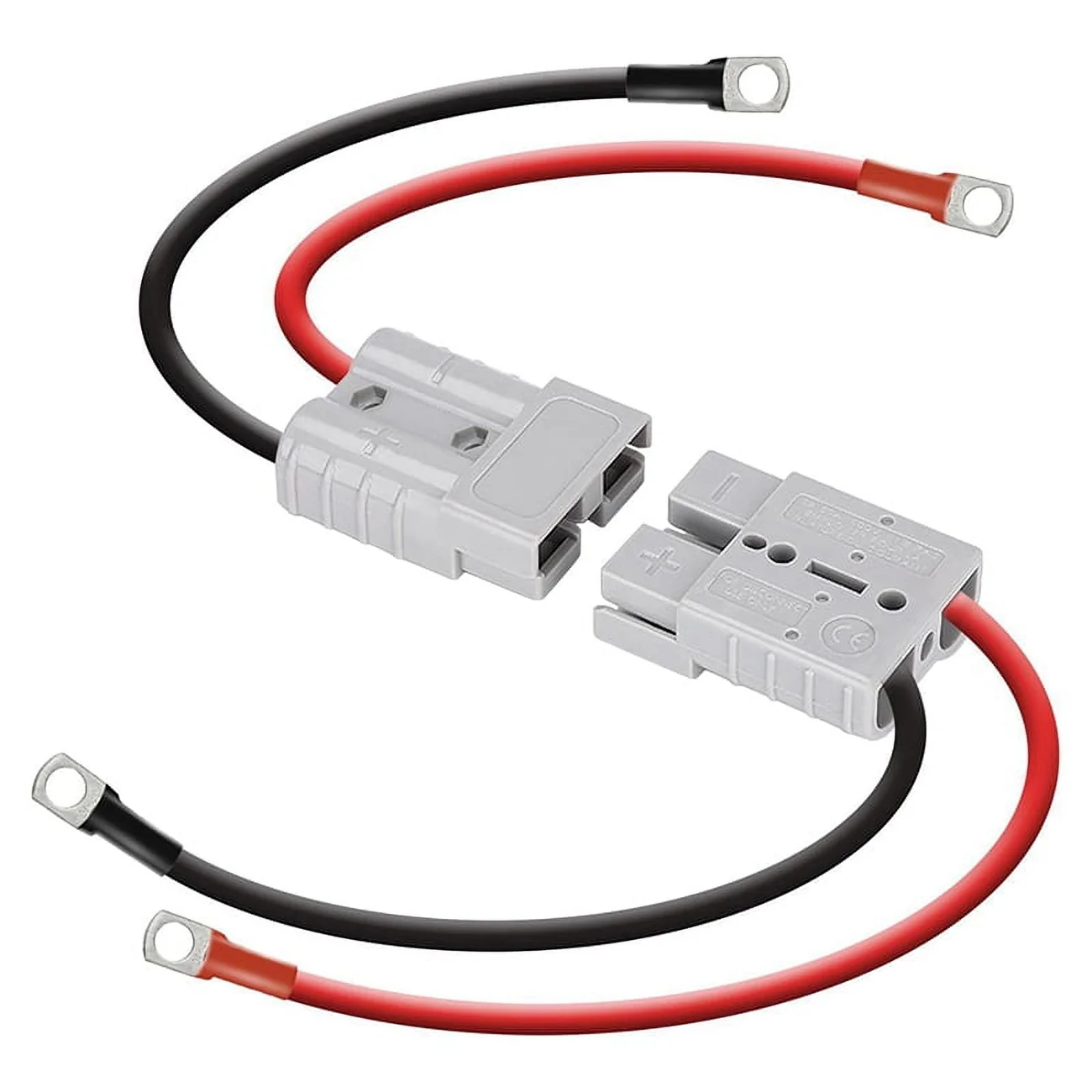

Anderson plugs are a decent way to go if you want to setup a plug in with your portable pump as well

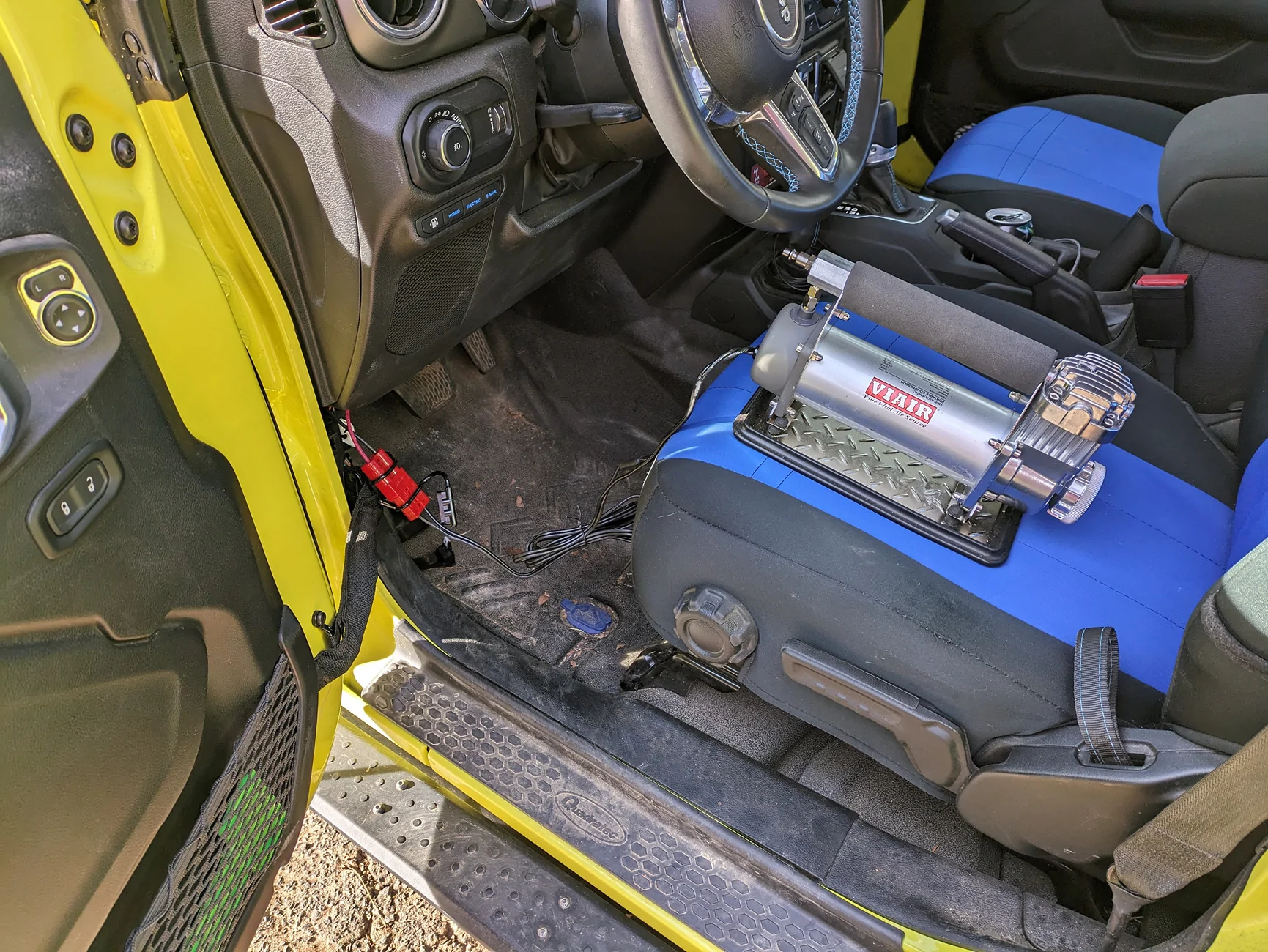

I wired up a connector that fits inside the driver side door plug shroud. It's connected to the Aux1 switch that I run my portable compressor from. Also have a four tire air hose setup. Has been working great.
Whose reel is that?
