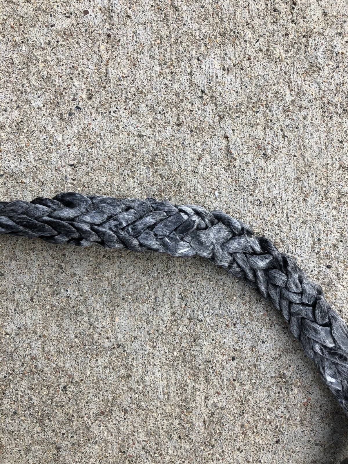

first off; I rarely use my winch. It’s 2yo. I’m overdue for line maintenance. So I let the line out and have several sections like this that are mashed. Not sure why. I’m assuming I should replace the line to avoid failure.
Winch was preinstalled when I bought the Jeep and was incorrectly spooled

I’m no winch line expert but I’d probably replace it. If only a couple of mashed sections cut them out and splice back together and keep what’s left as an extension.

That rope appears fine to to me. Just work it back and forth a bit the the original shape should return. I just unspooled and re-spooled my line yesterday and had lots of spots like that, I just massaged them a bit and it after a few seconds the flat spots disappeared.

Yeah, looks smashed to me as well. I don’t see any tears or fraying. Mine looks like that after you unravel it. I’d say it’s fine unless you find fraying or tears.
